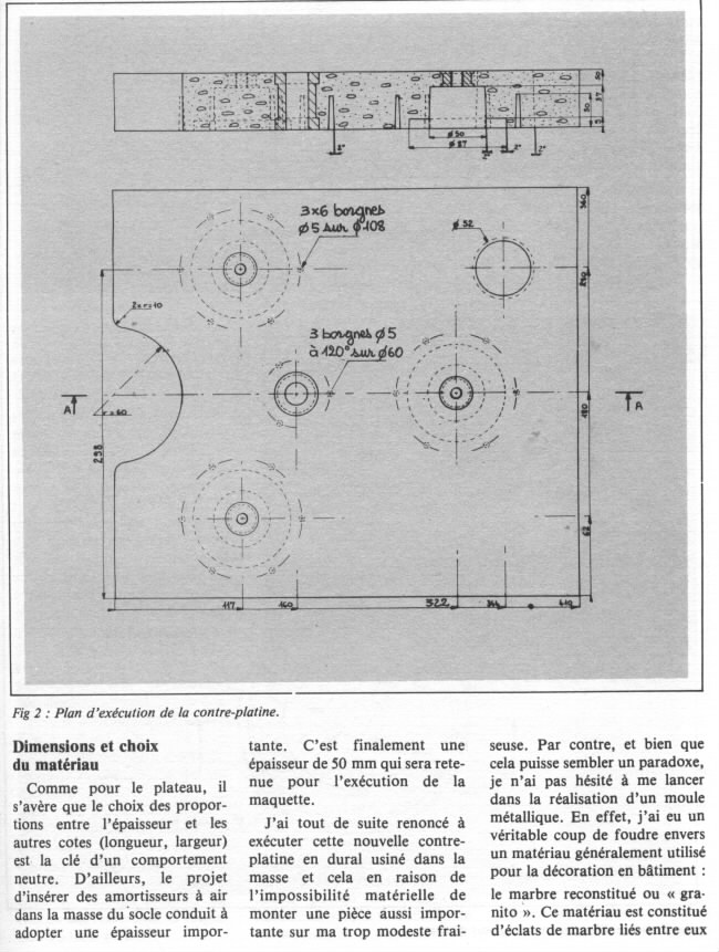

Hey Werner, since your in Belgium, maybe you know the French Verdier turntable. Perfect? No. But near enough for me! 😉 Far too $$$ for me, tho. Platine Verdier

maybe you know
Merde du monstre sacré pute.
(me Swiss cheese platine with fibre de carbonne shines more)
