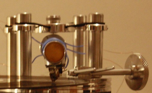

Call me daft, are you not skipping that the tonearm requires freedom of rotation in two planes ?
Easy dutchie , clouding the issues with facts again ....🙂
You've got inverted pendulum with short length. Three anchor points will make it some form of conical pendulum. Will most likely exhibit multiple modes due to distribution of mass along arm v perpendicular to it.
The mass along the arm is minimal. Most of the mass is at back around the point where you apply the springs. Those minimal modes are irrelevant in practice. The arm vibrates more in its original set-up. If you want to improve further, as I did, you can add mass where you usually bolt it to the base. There are several types of elastic wires you can use for this application.

Pinched a conical pendulum image from Mr Russo's page =>
