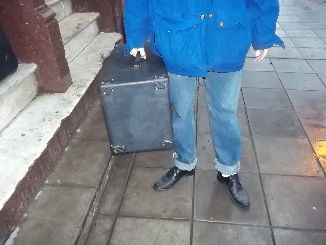

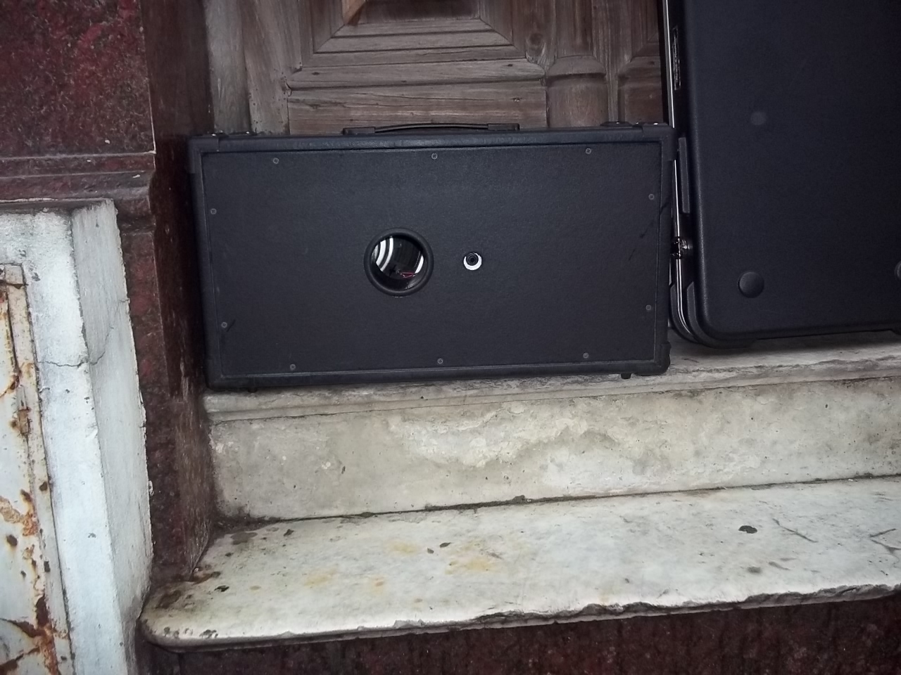

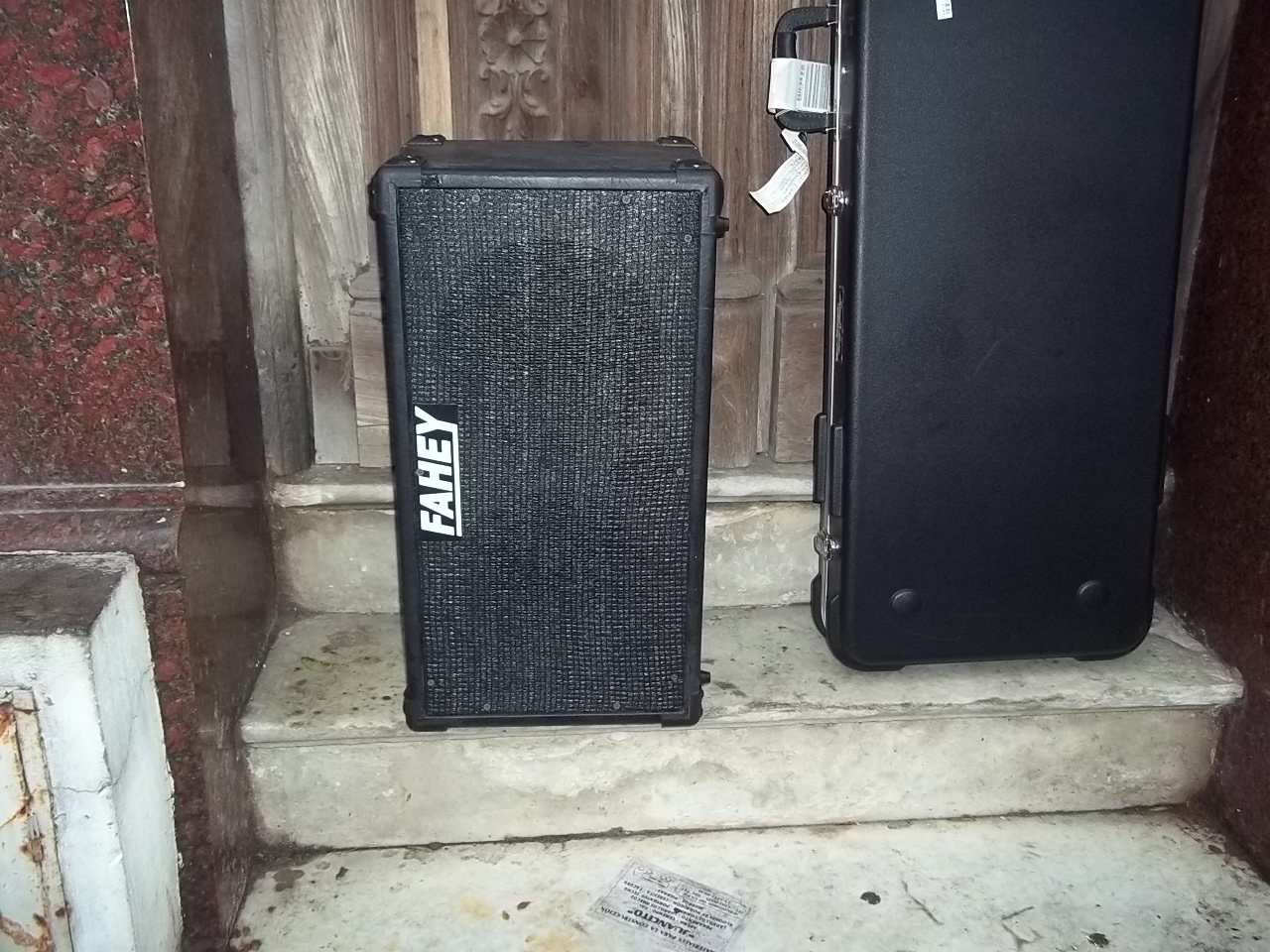

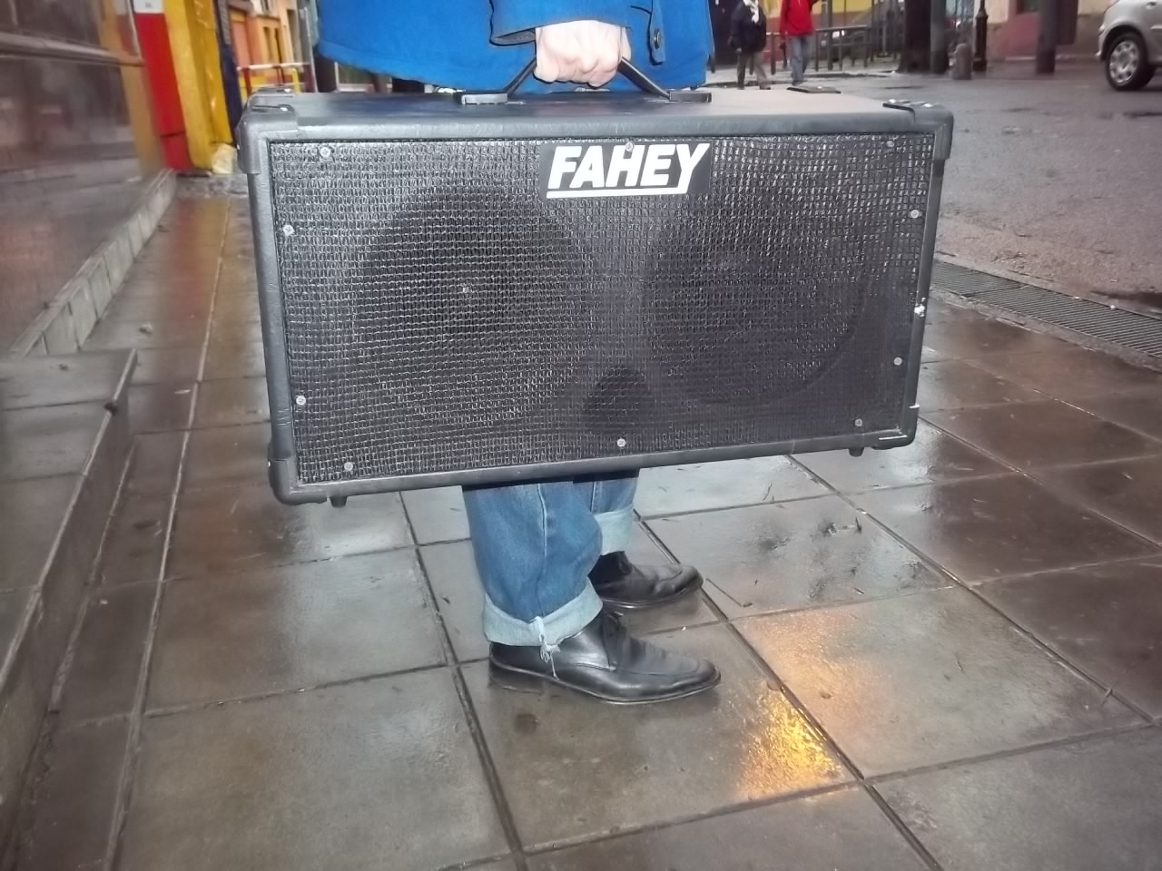

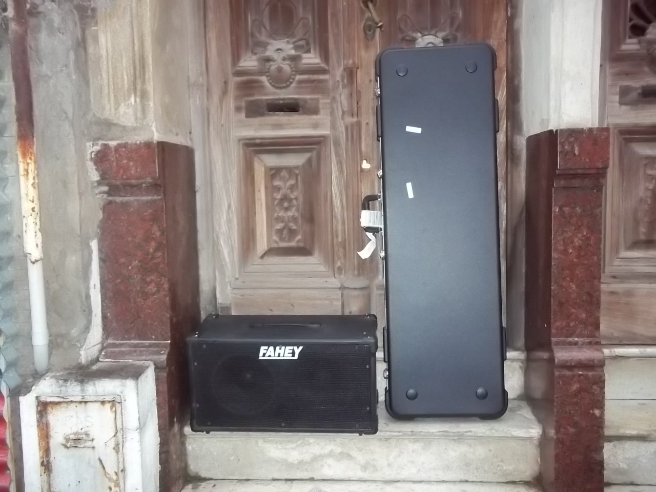

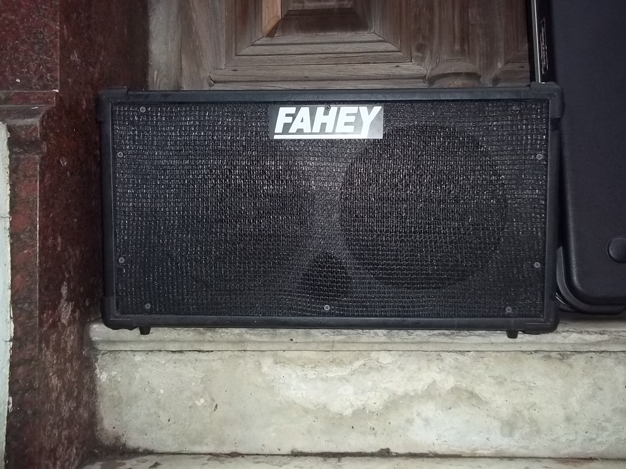

Can´t edit old ´post, so add a new one, showing my own super compact 2 x 10" + Tweeter cabinets:
VERY portable, you can make 1 or 2, consider it a "splittable" 4 x 10"
