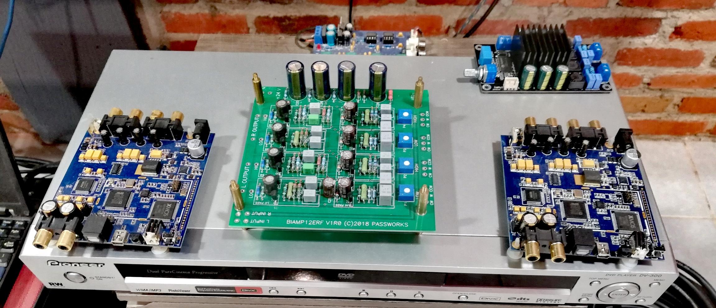

my setup that will be tested on this weekend, still waiting for 4 rca cables and several meters of speaker cable. my first observation will be :
- no hum/noise occur
- enough power from 100W class ab for 21" subwoofer
- basic crossover setup wit Harsh

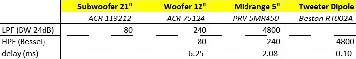

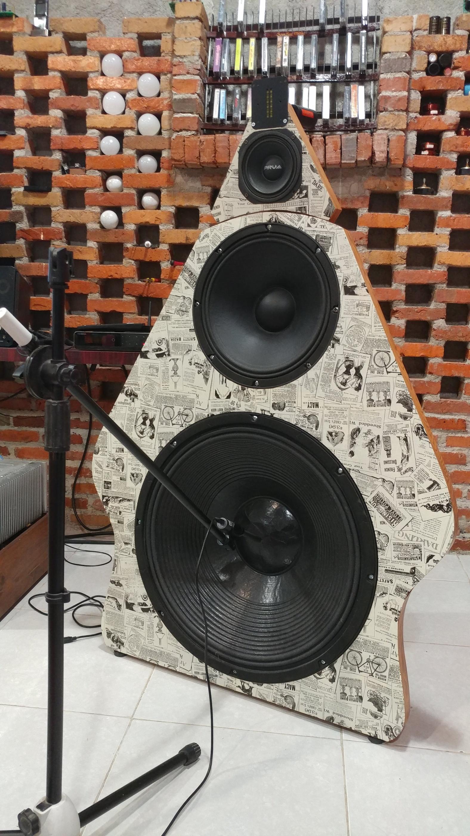

yesterday I played hours on my music collection, tried Harsch XO setup by tuning with ears. preliminary results is satisfactory, so many Fc point that i tried and with dsp engine it's so easy to change and hear the result immediately.
notes for PRV 5MR450 lover, no matter how hard i tried to use it as Fullrange, once i turn on Beston ribbon then there is no way to force PRV for high frequencies. Because i have sinusitis, distorsion or maybe beaming is very annoying for me, setting me up PRV to work below 5kHz is very pleasant to my ears eventhough on very high volume and let the ribbon works as it's best on > 5kHz

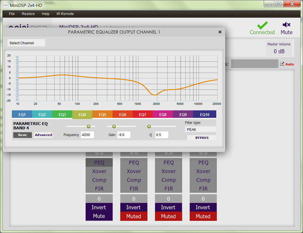

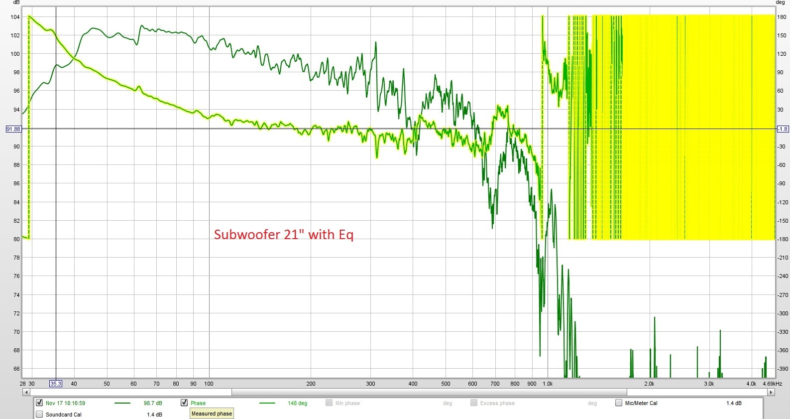

now it's time for proper design, I measure each driver individually and add PeQ to flatten freq response up to 2 octave above Fc and remove nasty peak on higher octave.

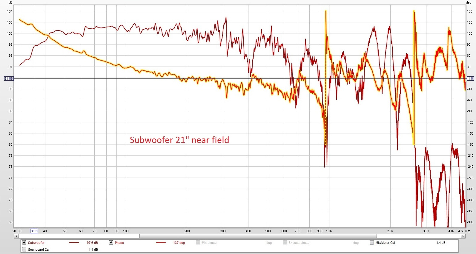

because this is my first measurement, I start with 21" subwoofer. any insights on the measurement result?
another question, what is microphone distance recommended for Midrange and Tweeter for individual driver measurement? for 12" i think i still can use near field method because it will be used below 500Hz

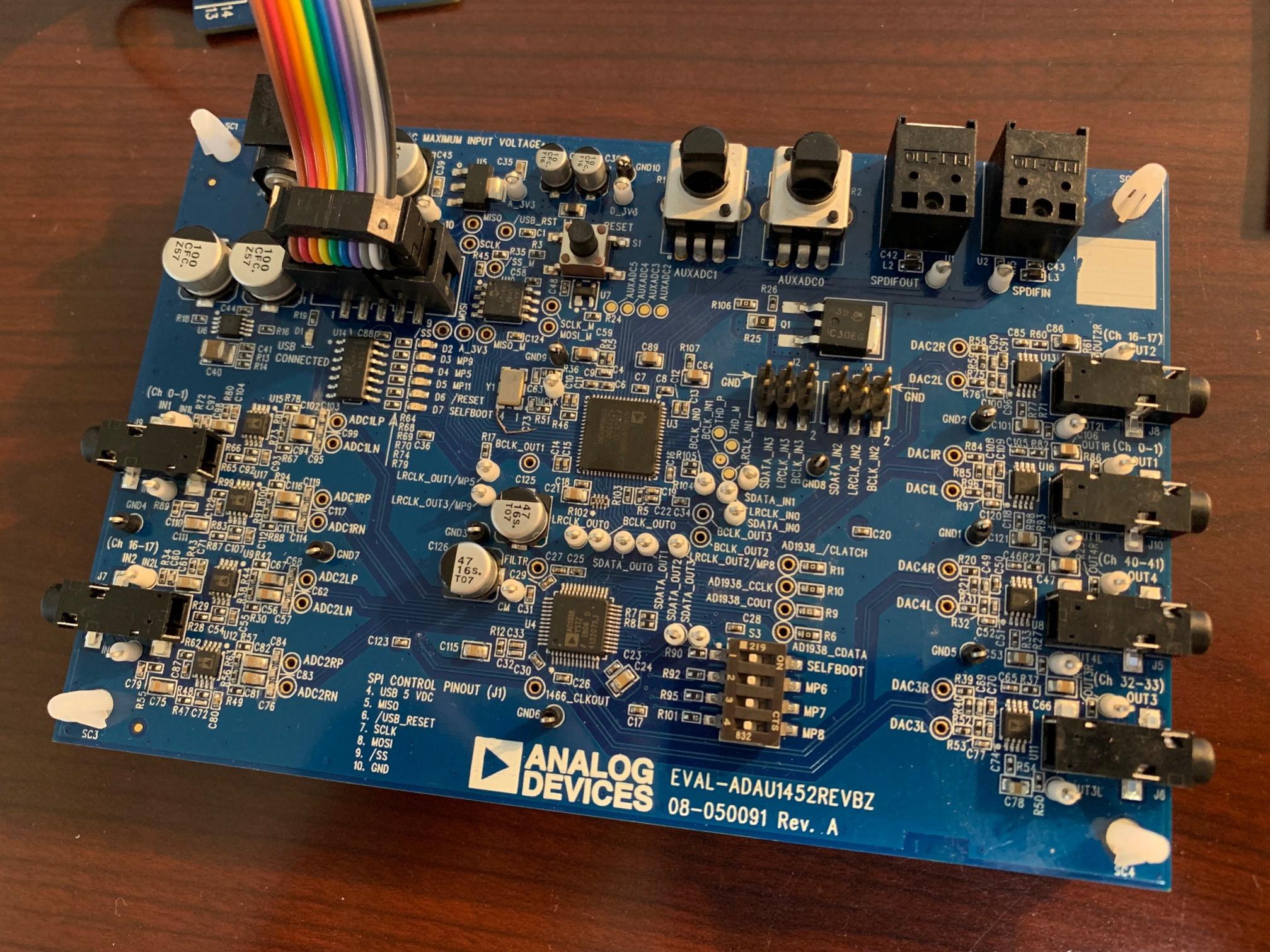

I have not tried I2S out with my miniDSP yet - I learned how to do this recently with the ADAU1452 and an external PCM5102A - and looking forward to trying with other DACs.

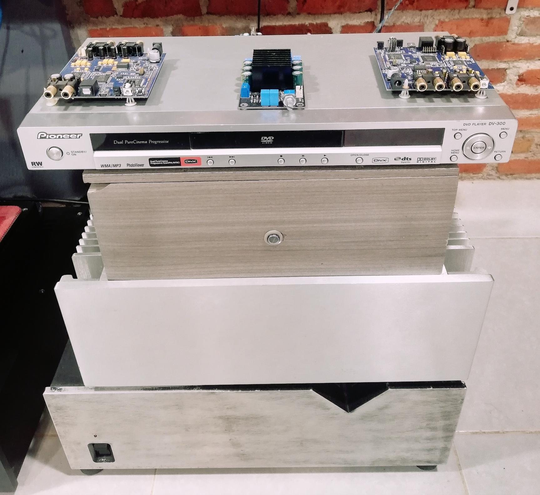

finally settled on win-win solution for my build, previously i insisted to stay active with minidsp and find better way to improve it. but now i decided to build 1 passive speaker design which is Elsinore and keep my OB system with default minidsp
i can say using 4 different amplifiers should not be a problem, the issues are more to gain matching because all my amplifier have different gain and each driver has different sensitivity too.
previously i used 3way commercial speaker for watching bluray in stereo mode. now with active OB, i was surprised because the dialog is more centered. never thought OB can give this solid dialog where it was blurred in my previous 3way. i don't think any need for multichannel anymore
indeed 21" OB can not provide strong attack bass on movie, but with my dual-opposed 12" subwoofer with lpf @48Hz, it really helps to give bass sensation. can't wait to build 2nd subwoofer
