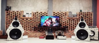

I'm just wondering for the case of my build as stated on the title and posted here : Ultimate Open Baffle Gallery
my inventory right now :
Behringer nu3000dsp (class d) : might be good for subwoofer
aragon2004 (class AB), mauro penasa GC : might be good for woofer
3 class a amplifier : might be good for midrange
Tripath : might be good for tweeter
my question would be : theoretically or based on consensus, is it good idea to mix these 4 different type amplifier?
or maybe i should use same type amplifier for all of them, just vary supply voltage? like this one : 2 PeeCeeBee V4H 56Vdc for Sub&Woofer and 2 V4 35Vdc for Mid/High. but this will require new budget and time to build

I suspect that you are about to drown in a sea of opinion...
From a technical perspective there is no issue with mixing the amplifiers. You just need to set the levels (gains) correctly. But that is natural for and active crossover, and the varying efficiencies of the drivers mean the amplifiers will all be at different levels.
Then you can wrap in the second level of opinion. Class A, Class D and AB.
My take would be to use the most powerful amplifier for sub, next for mass-mid, mid and twt respectively. I do kind of prefer linear amplifiers, but have used CLASS D and have not suffered actual physical harm from the sound.
. Unless one is really crud, you should be OK.
If you don't like the sound then I am sure you can change later.

Why would it be bad? When going active the power requirements of different drivers means that a standard model for all 4 ways is not likely to be optimal anyway. MiniDSP allows you to adjust all the gains to match so I would press on and just do it. You can always replace amplifiers down the line.
most of 3/4ways active build that i find use Ncore or Sure which is not cheap. currently my product choice is to match amplifier & drivers based on power rating, i will clear up my thoughts not to worry so much now, i will just try and mix them all
with good amps, wouldn’t the performance be limited at the end by the DAC’s in the miniDSP ?
there is another worry that i might downgrade the output from my AD1865 dac to minidsp ADC but for a while i skip this, just focus on amplifier first. but the options are available to use this active toslink splitter or split usb output from laptop, plus quad volume attenuatorEven with mediocre amps you’ll be limited by the miniDSP ADCs.

MiniDSP has an optional volume knob analog pot that acts as a 0-5v voltage source read by DSP’s extra ADC - the value of which is then applied to a digital volume inside the DSP. So you get a tactile physical knob and it works pretty good. Never had a kaboom situation.
Use the powerful Class D for subs. Use Class AB or A for mid and highs. Use your best amp for mids as that is where the soundstage info is. Gains on amps need to be approximately close (within 6dB or so) or else you waste dynamic range on DSP to match them. But it may be fine depending on rest of setup.

When I used a mix of amplifiers with linear and switching power supplies, I had hum or ground loop problems. After messing around with grounds, polarity and isolating transformers, I substituted linear supply class d amps to solve that problem.
The other problem I had was noise (hiss), which I presume comes from the Minidsp. I used a fixed attenuator after the Minidsp, one for each channel to solve that.
