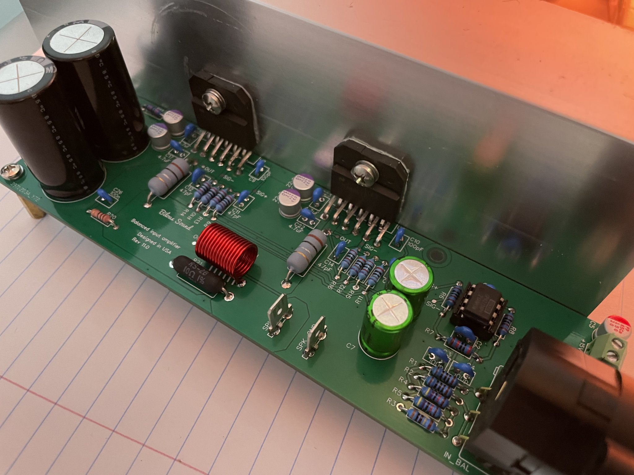

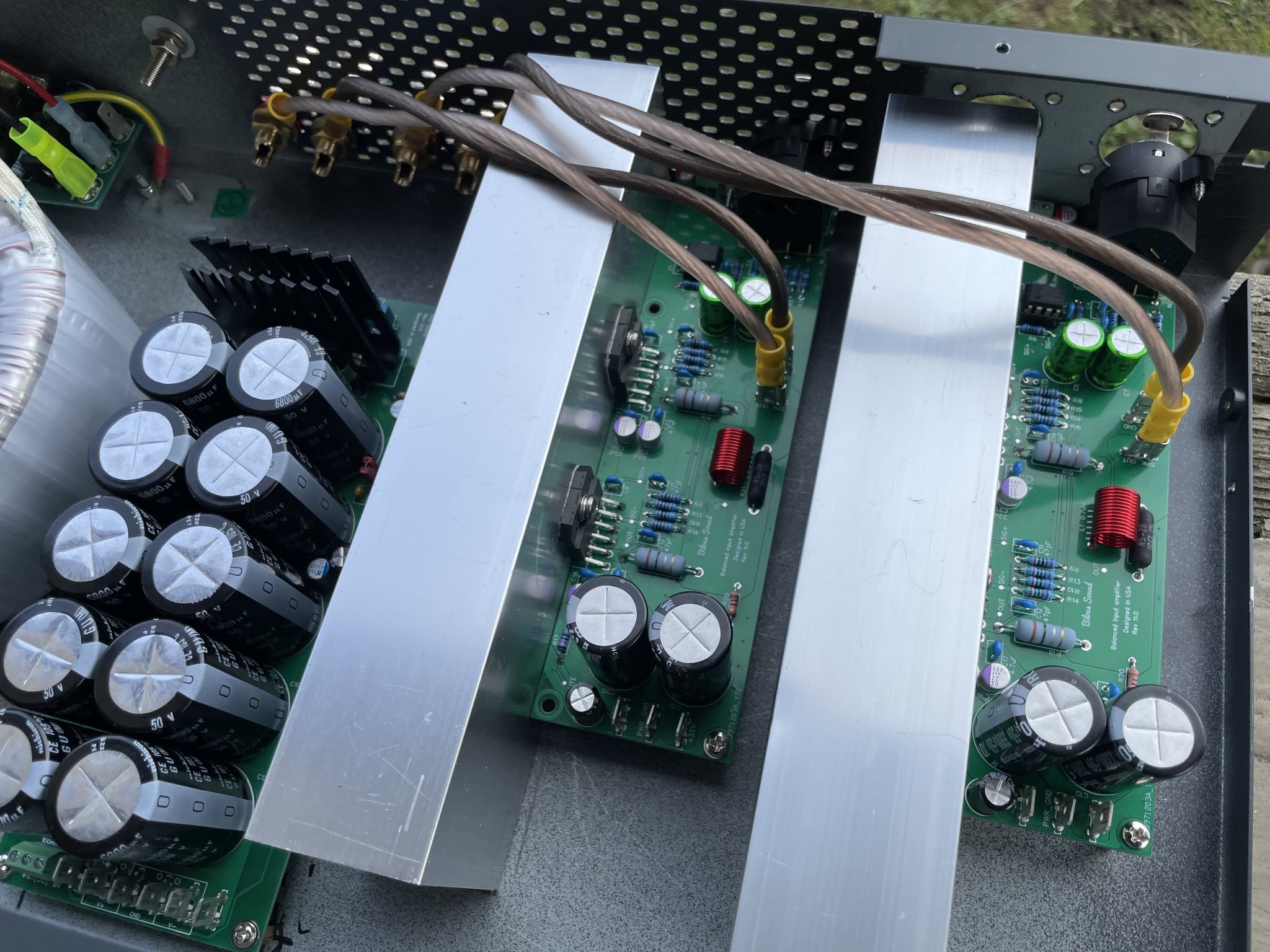

Voltage offsets that I am getting are as follows:
Module one:
Before 0.1R resistors:
-1.5mV DC
1.4mV DC
At speaker output:
0.1mV DC
Module two (closer to psu):
-7.9mV DC
6.4mV DC
At speaker output:
-0.8mV DC
Module one:
-1.5mV DC
1.4mV DC
At speaker output:
0.1mV DC
-7.9mV DC
6.4mV DC
At speaker output:
-0.8mV DC
So module 1 has about 15 mA cross conduction and module 2 has about 70 mA. Interesting that although module 2's offset is about 5X that of module 1 in both cases one output is positive and the other is negative. Neither module has 2 positives or 2 negatives. This could easily be a coincidence but it kind of seems like this is trying to tell you something.

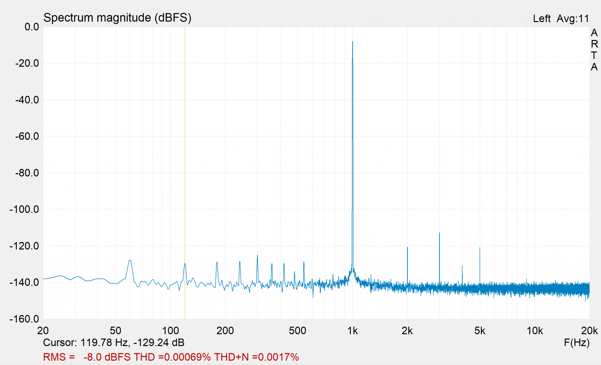

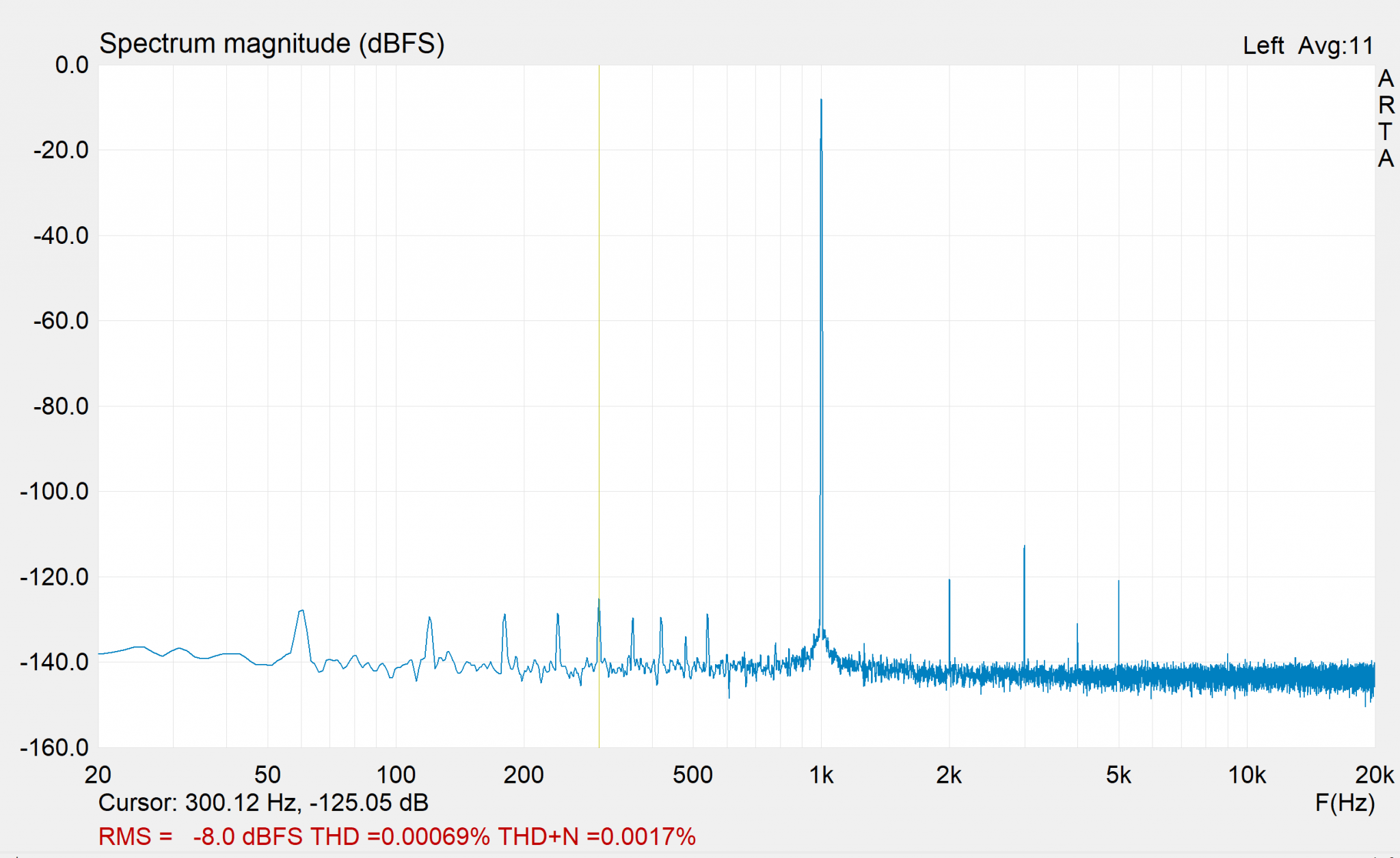

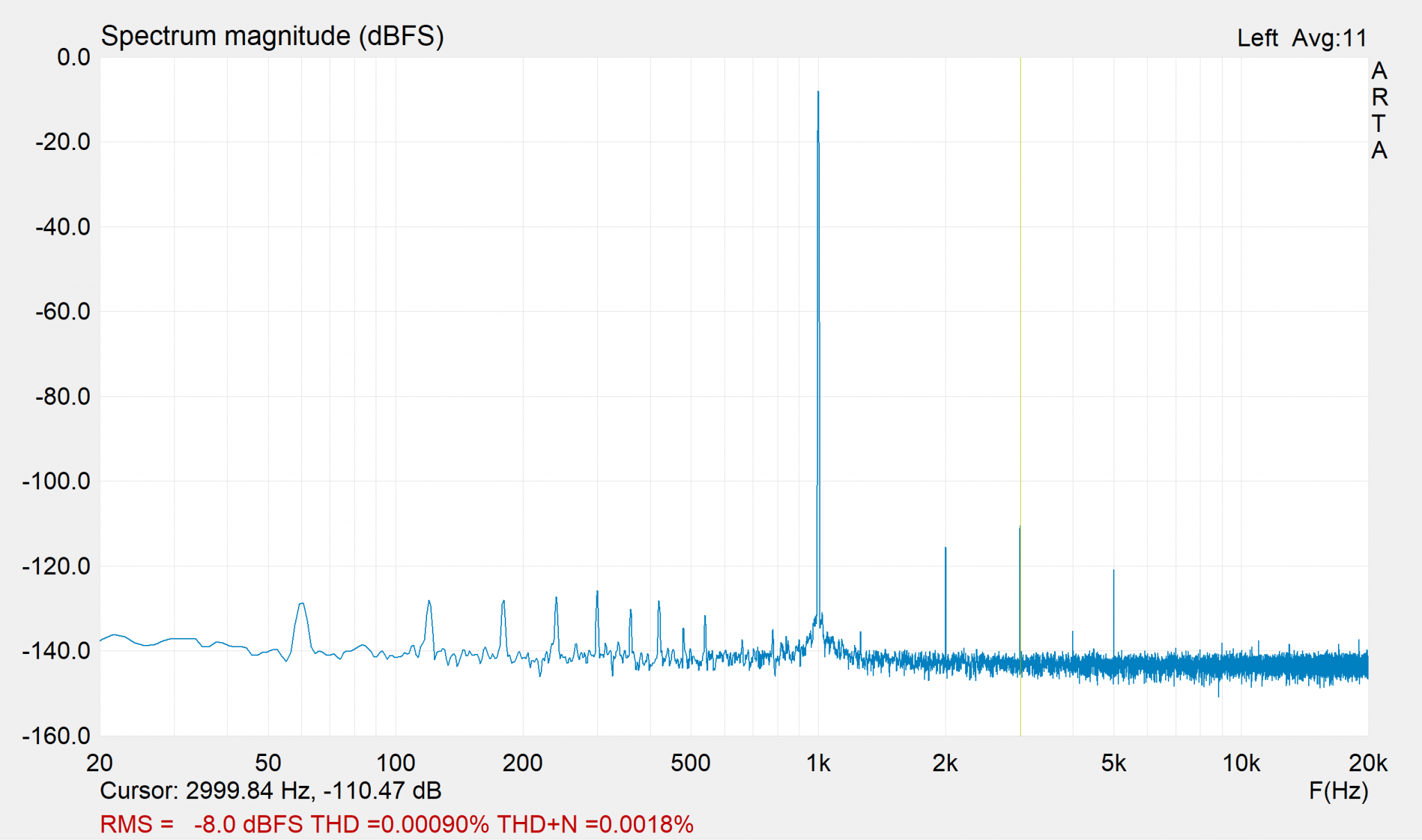

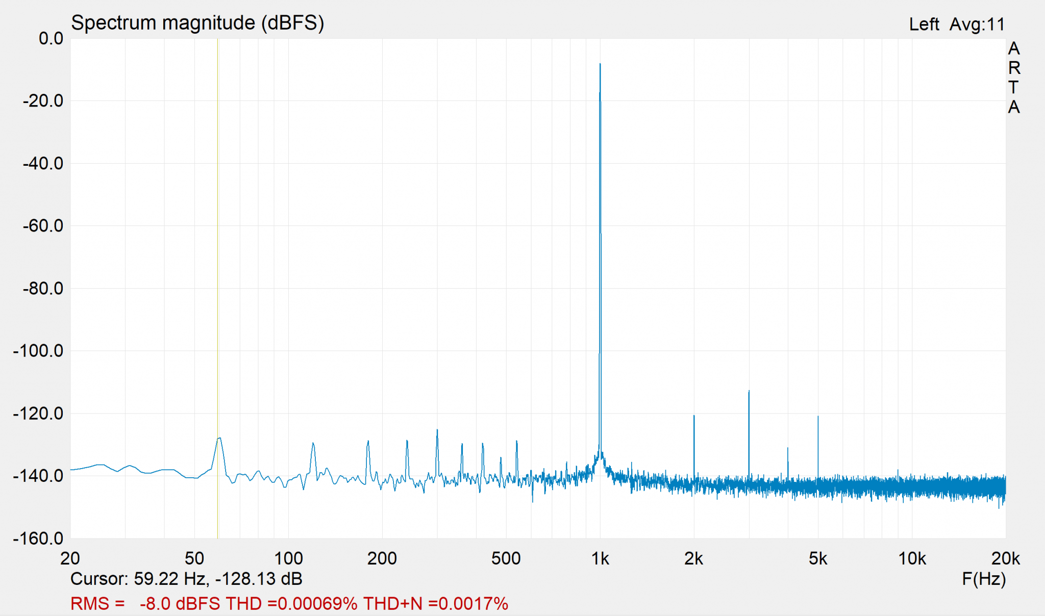

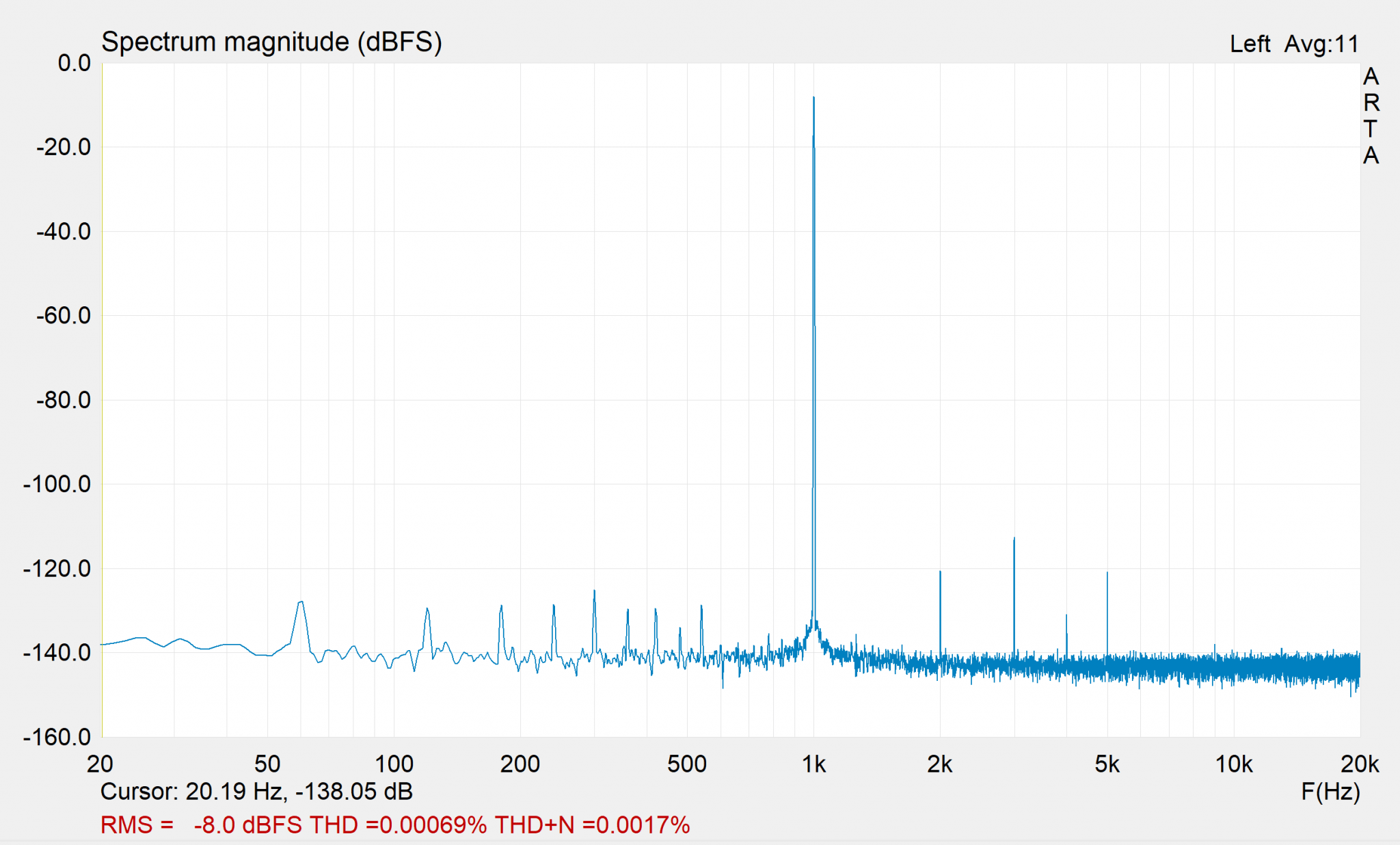

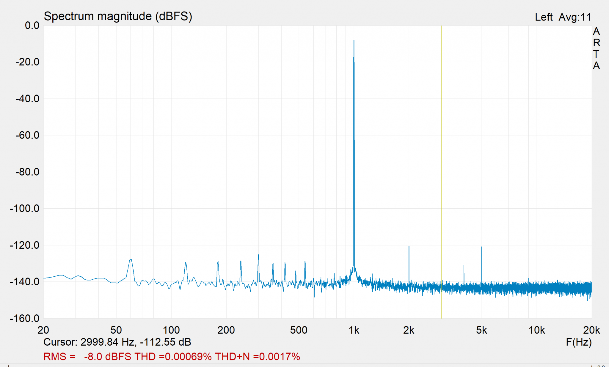

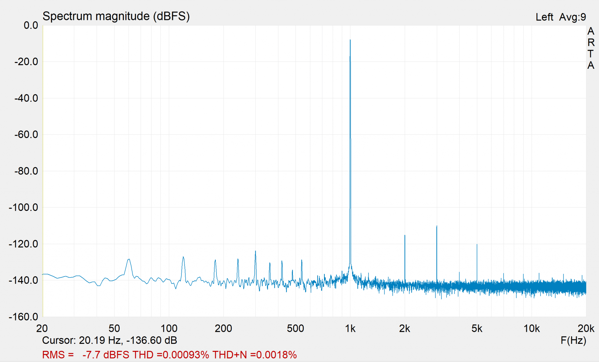

Here are attached measurements results for both channels.
Interestingly, the channel that is closer to the psu has offsets of -7.9mV and 6.4mV (-0.8mV) but shows less THD figures.
channel2 - bigger offset - closer to psu - vout 20v - cursor 60hz.PNG445.5 KB · Views: 79
channel2 - bigger offset - closer to psu - vout 20v - cursor 120hz.PNG306.2 KB · Views: 67
channel2 - bigger offset - closer to psu - vout 20v - cursor 300hz.PNG433.9 KB · Views: 76
channel2 - bigger offset - closer to psu - vout 20v - cursor 3000hz.PNG426.1 KB · Views: 70
channel2 - bigger offset - closer to psu - vout 20v.PNG370.5 KB · Views: 74

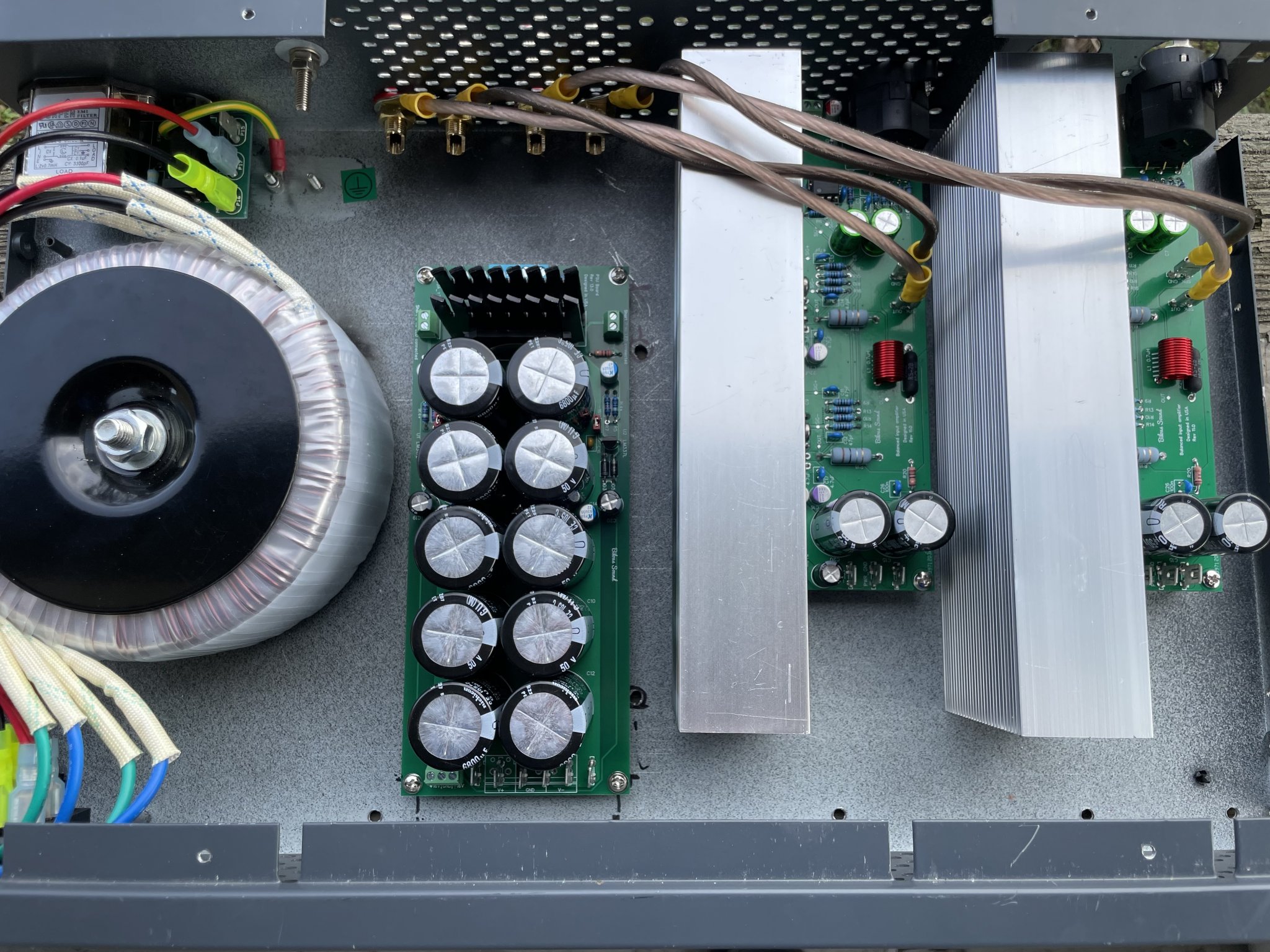

Here is how I measured:
Used Fluke 115
Negative probe is on the GND
Positive probe is tapping into different points on the PCB.
What do you mean by cross conduction?
