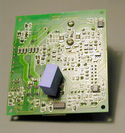

Yesterday I got my polypropylene caps for the output LC filter on my UcD400AD modules.
They were all somehow compact, but much larger than the original 0.68uF/63V. I opted to install the smallest of them all, the Vishay/BCcomponents MKP 416 (63V). I was also very careful in keeping the cap leads as short as possible. While I had my modules out, I also replaced the bootstrap cap with Panasonic FM 220uF/25V that I happen to have. As usual, one must be careful, patient, and use a fine point soldering iron while modifying these modules.
After about 12 hours of music playing I can say that there's a definite improvement. The midrange has much more presence and the sound is more "together", more "round". There's also a noticeable improvement in handling musical crescendos. The system doesn't appear to be struggling as it could sometimes happen prior to this mod at high volumes.
Surprisingly, I found the sound of these caps very similar to Auricaps. I guess that's the sound of polypropylene film caps.
I think the caps still need about a week to be properly broken-in. There's still that typical unrelaxed sound when components are new, but overall the improvements are obvious and worth the trouble IMO.

I think my output LC filter caps are finally broken in now.
IMO, they lost any big coloration they had. The main sonic difference is that the amp seems to be able to handle crescendos more dynamically. It doesn't seem to compress at high volumes. Bass presence seems improved as well as transparency.
Overall, after all the "mods" I've done in my modules, the tonality of the amp hasn't change much (a good thing) but transparency, dynamics, presence, and neutrality were greatly improved.
