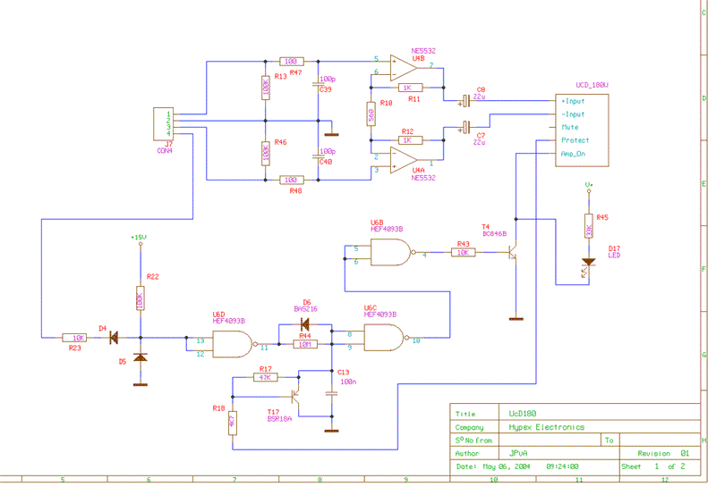

maxlorenz said:
Can you (or anyone) figure out the whole input section. It is not apparent to me.
That has never been posted, AFAIK.
Maybe it's worth further mods...

By bypassing the input section you are running directly in the UcD modulator, with has input impedances of under 10k (don't remember the exact values). HF distortion increases with decreasing of the input impedance, also you might be passing on some MHZ range garbage directly to the UcD modulator.
Thanks for your interest. Your diagram is for UCD180. My trouble is with UCD400ST, wich has a cheap elco as signal coupling cap. This cap is the only one that I removed and signal is fed directly to its hole, bypassing only the input connector...and some cms of via...and 2 soldering points 😉 Did I make something wrong?
If you look at Bgt's pick you could follow trace from input connector to elco. There's nothing in between, wright?
The SMD input section has been respected.
It's more or less the same input section as I posted for the 400ST. If you look closely at the schematic, the opamp is BEFORE the coupling caps.
