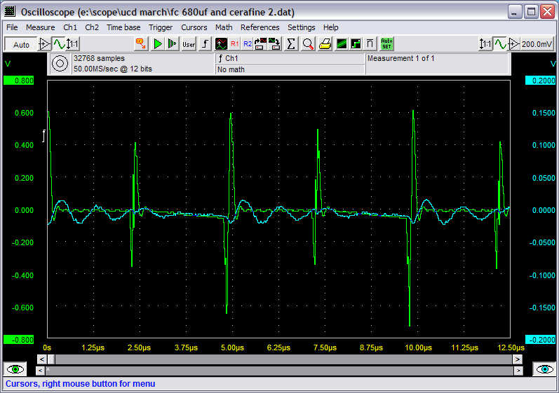

I've started to ponder some of the why this cap sounds that way.
I did a simulation with ltspice, making some vague assumptions about wire length, the inductance of the caps, and the on board ferrites.
What I see is that very low esr caps in place of the 470uF's cause a resonance in the 10-30kHz range. Assuming 1uH of wire plus ferrite inductance. If its way less (and this was just a quick sim in the kitchen with while cooking) then it may cause a peak around switching frequencies, which might be more detrimental.
Again, I'm guessing at the contribution of the on board ferrites.
I suspect that the complaint that when you go to the big FC's the bass gets better but the highs gets colored is a result of this.
It might be interesting to do a supply that is very close to the UcD and short the ferrites, OR replace them with a small value resistor, like 100mohm or so.
There are also a couple of ceramic caps on the board bypassing the main rails. (This is after the 5mohm shunts.)
They can cause a resonance in the ~10Mhz range. More important, it gets very significant as the ESR of the 470uF slot gets low.
I should have some bench data next week if all goes as planned.
Just keep in mind that ultra low ESR may not be the final word on optimal.
Also, it may actually be better to keep the capacitance lower, like 470uF, and go with bigger packages (by using higher voltage ratings) to get the low ESR. Then at least the impedance bump is higher and almost out of band. I'm not convinced this is THEE issue though. As the phase of the impedance may actually be more important.
I can say this. If one intends to do an array of low ESR caps, you may want to pay attention to these affects and think about removing or moving the ferrites, and or replacing them with a low impedance resistor. Keeping the connecting wires very short would likely be only better.
I think in the stock arangement, bruno has protected the user from these affects by using a fairly high ESR cap for bypass, but if you change that....
Clearly more cap and lower ESR is good (except for the high frequency anti-resonance with the on board ceramic bypass caps (I guess 100nF, but its only a guess. They are big ~.180 x .100", X7R or maybe a very low value of NPO. No matter what, they are going to cause a womping anti-resonance if the main bypass electrolytics have very low ESR, but then again, maybe 10Mhz is out of band. Again, all these are guestimates, but the affects are there.
Mike

Roger,
The sims at home right now. I'll check into it.
My gut tells me it will be worse because the on board ceramic has a 5mohm resistance in series with it. That is a snubber if you will.
1 ohm will do nothing when your talking about ESR's in the range of a few milliohms.
My point is the "what sounds best" might be more directed.
I think one might gain insight into lots of caps by just seeing if two is better than one first.
I suspect that there is more than one interaction happening.
Why for example, would lower ESR FC for example, help the bass?
Seems bizzare to me since the impedance of a 680uF cap at 100Hz is 2.3ohms. Clearly the stiffness at 100Hz is comming from the bulk cap off the recifier. Typical values of 10,000uF is going to be the domanant impedance at 100Hz. So, what gives with better bass from lower ESR in a rather small portion of the total bypass. Clearly its not the number of uF's present.
This being a switcher though, its likely subtle differences is the noise on the rails and how they interact with the comparator input. That's why I suspect phase really would matter.
I intend to look closely with a scope next week, but honestly, I doubt I'll see anything at all. My experience with these, "better bass" sound type things is they are rarely measureable.
Mike

I had saved some of my measurements on my PC. The atteched picture shows the AC component of the + rail voltage measured over the 470uF cap directly and at the UCD power supply pin. Note that the scales are different other wise you would hardly see the ripple at the power pins.
Best regards
Gertjan
Best regards
Gertjan
Correction, not over the 470uF cap but over a Panasonic FC 680uF 100V that I put in place of the standard 470uF caps. Actually the waveform (the spiky one) was measured over the 10uF snubber caps. There is a 5mOhm resistor in between that cap and the panasonic FC.
Best regards
Gertjan

Another correction, it seems that the timescale is not correct in that attached figure. It seems that my scope software does not load the x-axis data correctly fro some reason when I load stored data. Anyway, the waverforms are correct 🙂
Gertjan
