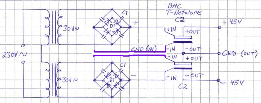

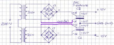

I made my UCD amp grounding according to Hypex instructions
http://www.hypex.nl/docs/wiring.pdf (unbalanced)
I hear now clearly hum from each of 4 channels. Before i had traditional star grounding of ps ground and no any hum (rca:s were not grounded).
I have ps. connection attached and only rca jacket ground is now connected to chassis, ps. ground is floating. Chassis is not connected to safety earth.
I am disapointed
Did i something wrong?

classd4sure said:Yeh, not a very useful document, is it?
Connect chassis to earth. Then see what happens.
I cannot connect chassis to safety earth because in my listening room there is no any. An Hypex also says in this document:
"When using RCA inputs do NOT connect chassis to safety earth to avoid ground loops. "
There was discussion in some thread where Bruno tells that "star ground sucks" but i do not remember details for this discussion.
classd4sure said:Does it hum with no inputs connected? Source plugged into the same outlet as the amp?
I can hear same hum even when input of amp is shorted.
Source is connected into same outlet as the amp, as it was before (when i had this "sucking star ground"..)

To float the inputs? That's the only way it worked for me in unbalanced. Of course, I did have my little metal plate/chassis earth grounded, I just like that idea.
So, your source is not grounded, your chassis is not grounded, your supply caps common point is not grounded to chassis (other than through the module), your amps output ground connects to that supply common point, speaker outputs don't do anything silly like short to the chassis do they? they'll have to float from it.
With as few real grounds as you have it's hard to imagine where the loop is, got to be something silly.
I don't imagine there should be any hum at all with inputs shorted, or no inputs.
Keep us posted.

I made my UCD amp grounding according to Hypex instructions http://www.hypex.nl/docs/wiring.pdf (unbalanced) I hear now clearly hum from each of 4 channels. Before i had traditional star grounding of ps ground and no any hum (rca:s were not grounded).
Why did you change it?
Encouraging DIY'ers to build amps to double-insulated standards, as the Hypex document does, seems unwise to me, especially as no advice is offered on how to do this.
For the unbalanced situation I would: -
1. Connect the chassis to mains earth (for safety).
2. Do NOT connect mains earth to the Hypex 0V rail, unless it's the only connection in the system from signal 0V to mains earth.
2. Use an RCA phono that is insulated from the chassis, if I had to use a phono, but would prefer to use an XLR and use a phono-XLR interconnect, with the -ve and the screen joining at the phono end only to get maximum benefit from the differential input.
Only reason to try this new grounding is because Bruno is against star grounding in UCD.
Ah! that answers my first question 😉
I don't understand this - can anyone point me to the reason why, it seems non-sensical!
Andy.
