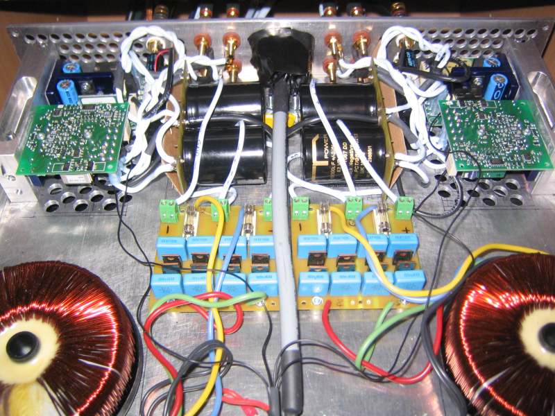

Here is picture of current setup. Sorry about still messy wires. I fastly tried speaker cables without twisted wires and still feel that sound remains same.
So i strongly believe that main reason for my experience is from turn modules. And this is not first experience but real thing instead. I am absolutely sure about that.

UCD cap replacements
All,
I have been doing further research on this forum about the options for replacing the caps on the UCD400. As a starting point I have:
Short out the internal DC coupling
2.0uf DC coupling in front of amp - Auricap
470uF 100v decoupling - elna cerafine
22uF 100v decoupling - blackgate STD.
10uF 63v (not low ESR) - blackgate STD
680nF output filter - Auricap Roger special (once done)
Bootstrap 180uF 16v - Oscon
I'm interested to see if anyone has been trying different caps in these spots and settled on favourite ones? Is it a good idea to mix blackgates & the Elna for decoupling? I cant find a wide enough supply of cerafines or the 470uF blackgate at a reasonable price.
I'm possibly thinking of ditching the input coupling cap and using direct coupling from all sources, as I will have a DC output protection after the UCD.
For the power supply:
- Separate 300VA toroid 40-0-40 power supplies per channel, separate diode bridges per rail. Star ground connection after the filter caps
- 2 x 10,000uF BHC slitfoils (if I can source them) per rail
- No zobel or smaller caps across the filter caps
- MBT10100 (10A) schottky diode with no snubber caps across the diodes.
- 0.82uF across the toroid secondary
- 8.2K bleeder resistor
Simple design and hopefully effective.
