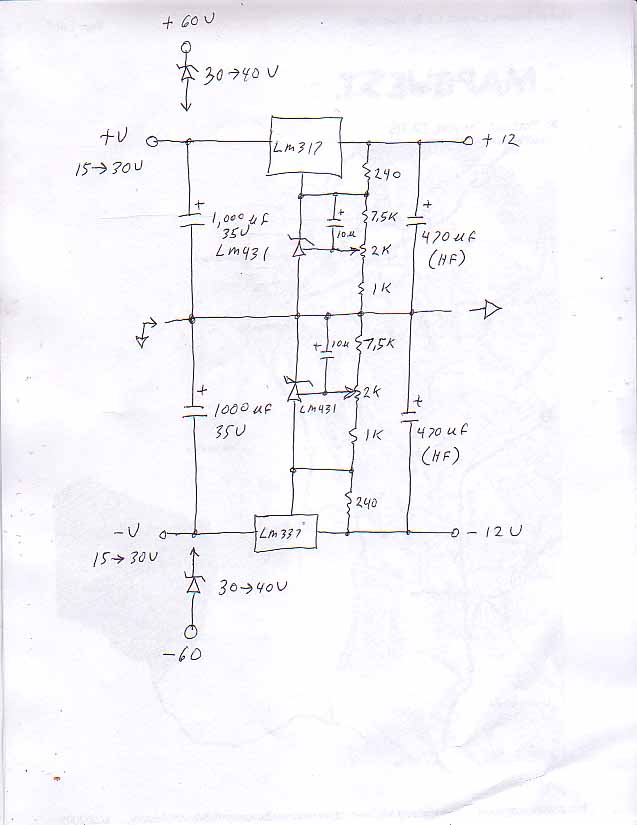

Simple but HQ reg
I have found this to be an effective high quality regulator.
Roger

Yves yes that's them.
Mauricio, same here but I think with what we expect to improve by this mode..... isn't a lower noise floor, it seems to be it's everything that has to do with better isolation. That's my theory anyway.
I'm waiting for cost to permit it, I'm sure alot of others are waiting with you, it will be dead last for me as well.
I enjoyed the link you posted, this certainly seems to be an area where there's more than one ways to skin ..... a dog. 🙂 Notice none of these circuits hardly look like they're worth close to what a Super Reg goes for... it's all about where to spend the money best.
Roger, that's probably about as far as I'd go with it myself, it need not be more complicated. Very nice. I like your high voltage option, was nice to throw that in there. Wouldn't it require a limiting resistor in series to protect the zeners?
