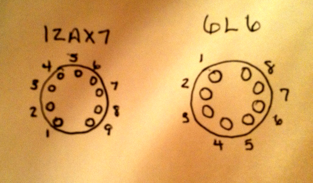

Here are the voltages for the tubes. I will list the values in order 1,2,3,6,7,8
V1: 269,0,2,268,0,2
V2: 269,0,2,269,0,2
V3: 323,18,44,323,17,44
For tubes V4 and V5 I will list I'm order 3,4,5,8. I want to note that on pin 1 on both voltage was 373. I know you didn't request it, but just wanted to see if any were getting something.
V4: 0,0,0,47(with loud humming sound
V5: 0,0,0,46(with loud humming sound)

Okay I read something that you wrote that I would like to re-evaluate the voltages I posted. First, I want to make sure that I am reading the pins right. My schematic only shows where pin 1 on the 6L6 is, not for the 12AX7's, so I looked online for an image on where pin 1 is. I have the amp lying face down with the tube PCB facing me. I read all the values I posted on 1000DCV (high voltage) so that could be one factor altering the correct values. You posted vAC for R80 and R81, so I know I was wrong there. I will re-take those readings. On pin 8 (if the pins reading I have is indeed correct) did not give 46v, it flashed a -46 and would give a loud humming sound. But first things first, is this the right positions for the tube pins? And secondly, do I read the tube readings on my meter at 1000DCV (high voltage)? Thanks for clarifying this.
The 12AX7 is correct, but he 6L6 isn't, all valve pins I've ever seen count clockwise.
Using the 1000V range is fine, but you can use lower ranges for lower voltages.
Thanks Nigel for clarifying where the pins are. Okay so this should be more accurate now that Nigel and Enzo cleared some things upas far as setting my meter and which are the correct pins.

The reading of V4 and V5 are reading in order pin 3,4,5,8
V4: 381, 380, 48(with loud humming every time I touched it), 0
V5: 380, 380, 48(with loud humming every time I touched it), 0
