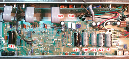

Here is what I'm faced with...originally I was getting a popping/crackling sound and my first impression was torn speaker. Attached to an external speaker and same thing, so then I thought tubes. Bought a new set of JJ's and installed. Same thing. I came across Justin Holton's site and did the test for the open R57 resistor. Test positive and while I was at it I noticed that the second filter cap (22uf 350volts) was leaky so decided to change that as well. According to Justin's advice he suggested to change out R4, R11, R16, R22, R57, and R58 for the plate loads. I ordered two new filter caps and the resistors (1/2w 82k for the R57 and 1/2w 100k for the rest). Installed everything and now no sound. All I get is a hum. I re-checked the solders and checked the voltage at R57 and all the filter caps. R57 is consistent on both sides now (329 and 328 respectively), but when I checked the filter caps I found a variance on the voltage. I have attached a pic showing the voltage I have at each along with the voltage at R57. Where should I go from here?
well at least is marked like the same as the others (350V or 450V) so it's expected some high voltage in there
it's rated at 100uf with 350volts but when I have it running at is only putting out 4 volts. I noticed that the other one, third from the left is only putting out 180 volts so could this be going bad. I just changed out the first two from the left to right and but I wasn't sure if you change a filter cap out if you should just do all of them or just the ones that were leaky.
The cap is passive, it isn't putting out anything, the caps have voltage put across them by the rest of the circuit.
If a cap were so leaky as to drag your B+ down to 4v, I'd be expecting something to get real hot and likely fuses would blow. usually when caps fail they just stop functioning and the amp gets real hummy.
May I assume the voltages shown were taken at the other end of each cap rather than the end near the numbers?

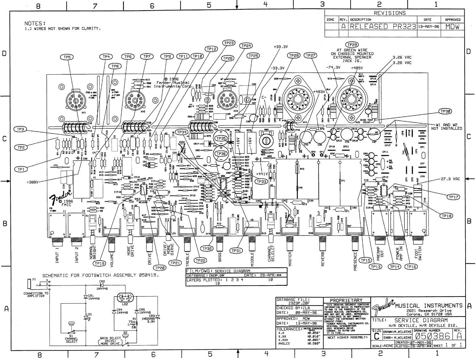

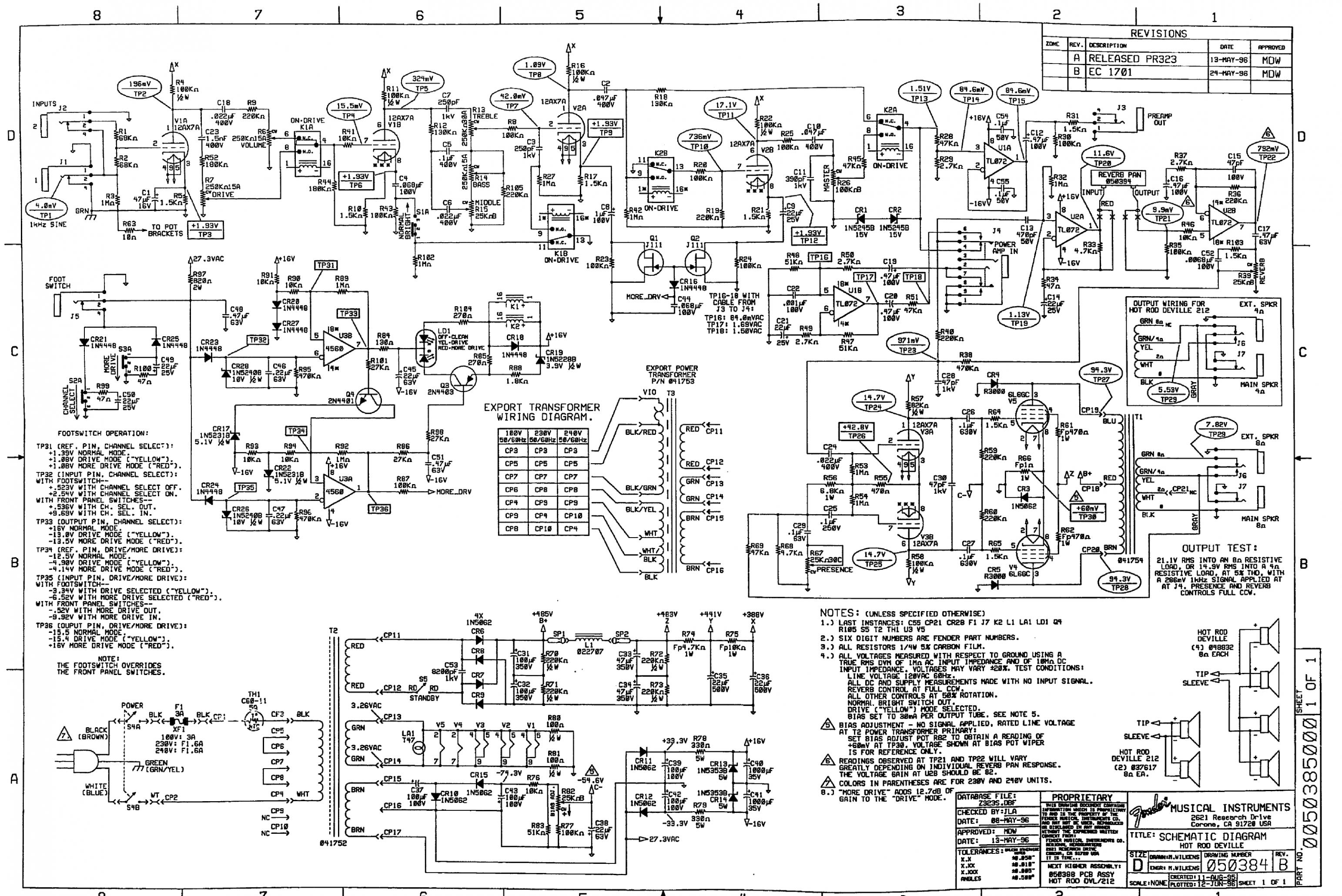

Look at your schematic. The 180v reading cap is C34, and is the bottom of two caps in series. Its upper partner is C33 to its right. They should have about the same voltage across each cap, and your 376 is ROUGHLY twice the 180. So call that OK. However, the pair of them ought to have more like 483v (and half that on the one).
The 4v cap on the end is C32. it is the bottom half of C31 and C32 series caps. They form the first filter node, often called the reservoir cap. C31 is the one next to it on left. With only 4v on C32, then that entire 378v is across the C31. That is not good for a 350v cap. And all that might explain why your voltage at C31 is only 378v instead of the 485v the schematic calls for.

Yes I checked the voltages from the positive side. So would you suggest that I reverse my process and recheck the resistors I changed since before it did make the crackling sound? R57 was internally not functioning though because it did only have voltage on one side and not the other. So for sure that was bad. And the leaky cap was C35. So I changed out C35 and C36. Would I check the resistor at R71 and R76? Assuming that the resistors I changed are ok?
R70/71 and R72/73 are balance resistors to ensure the voltage across those pairs of caps is evenly divided in two. Certainly we should check them, but they are not going to be "shorted." That doesn't mean there cannot be a solder bridge somewhere. We do need to solve the power suply issues before anything else is going to work right.

Ok I checked each socket pin from the power tubes to the PCB and each pin has continuity. I did find that R70 loose and out of its point, so I did re-solder that and now C32 is reading somewhere around 182 volts, I didn't write it down, but it's getting current. I tried plugging in a guitar and still no sound. The set of 6L6's I have I'm there are new, but tried a different pair from another amp I have that I know is working, same result, no sound. I checked for any other loose things but did not see anything and tried wiggling with a wooden stick to see if anything else might be loose. Check continuity of ribbon cable and came out good. I tested all the resistors I replaced and they are correct. I'm not sure what else to try.

Your schematic doesn't specify plate voltages there, but it does show cathodes on the phase inverter tube as +42.8v. Call it 42v. The path through R55,56,68 is through: 470 ohms, 6.8k, and 4.7k, or 11,970 ohms. Remember that schematic voltages are average and not meant to be precise. SO I am going to call that 12k. 42v across 12k by Ohm's Law gives me about 3.5ma, which is 1.75ma per triode in that dual tube. Plug in those numbers, and we find 175v across a 100k and 144v across 82k. Drop those from the 441v and I might then expect 300v on pin 1 and on pin 6 maybe 266v. Remember, just ballpark. If I am within 40v either way of those, I'd call it close enough. Especially when the problem is "no sound." If it made plenty of sound but sounded bad, I might worry more closely, but we don;t get any sound.
Isolate the B+ problem.
Something is killing your B+. Try this: the primary center tap of your output transformer is a red wire on terminal post CP18. Disconnect that wire from the post, and see if the voltages on those main filter caps comes back up to close to the 440-485 the schematic calls for.

I checked all the tubes and here is what I found at pins 1 and 6 respectively:
V1- 248, 248
V2- 248, 248
V3- 305, 305
V4- 0,0
V5- 0,0
R57- 305 on each side
R58- 305 on each side
It seems like no current is getting to V4 or V5.
