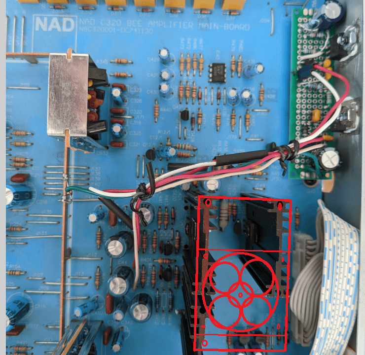

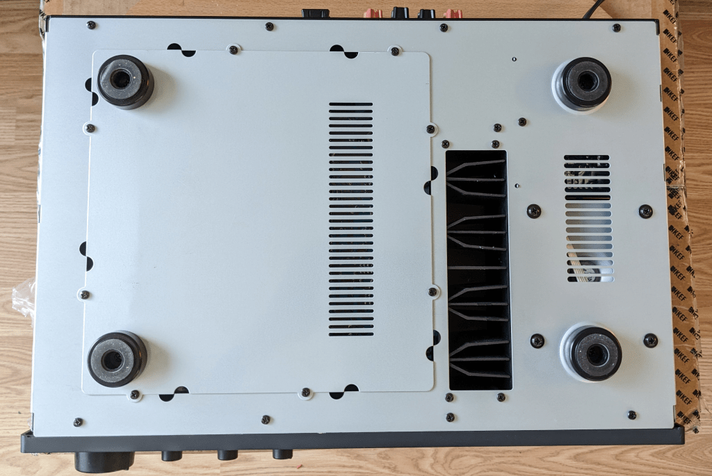

Here is the base plate of the NAD C320. There is big opening for the output stage, a grill for the power entry board, a grill under the main board driver area, and the rest is unvented. The main board mainly blocks air trying to rise from the base.

My understanding is that for ventilation to work properly the size of the escapes should be larger than that of the inputs.
If there is about 5mm space between the case and the circuit board I still think the problem is the lack of escape holes in the case top above those hot spots.

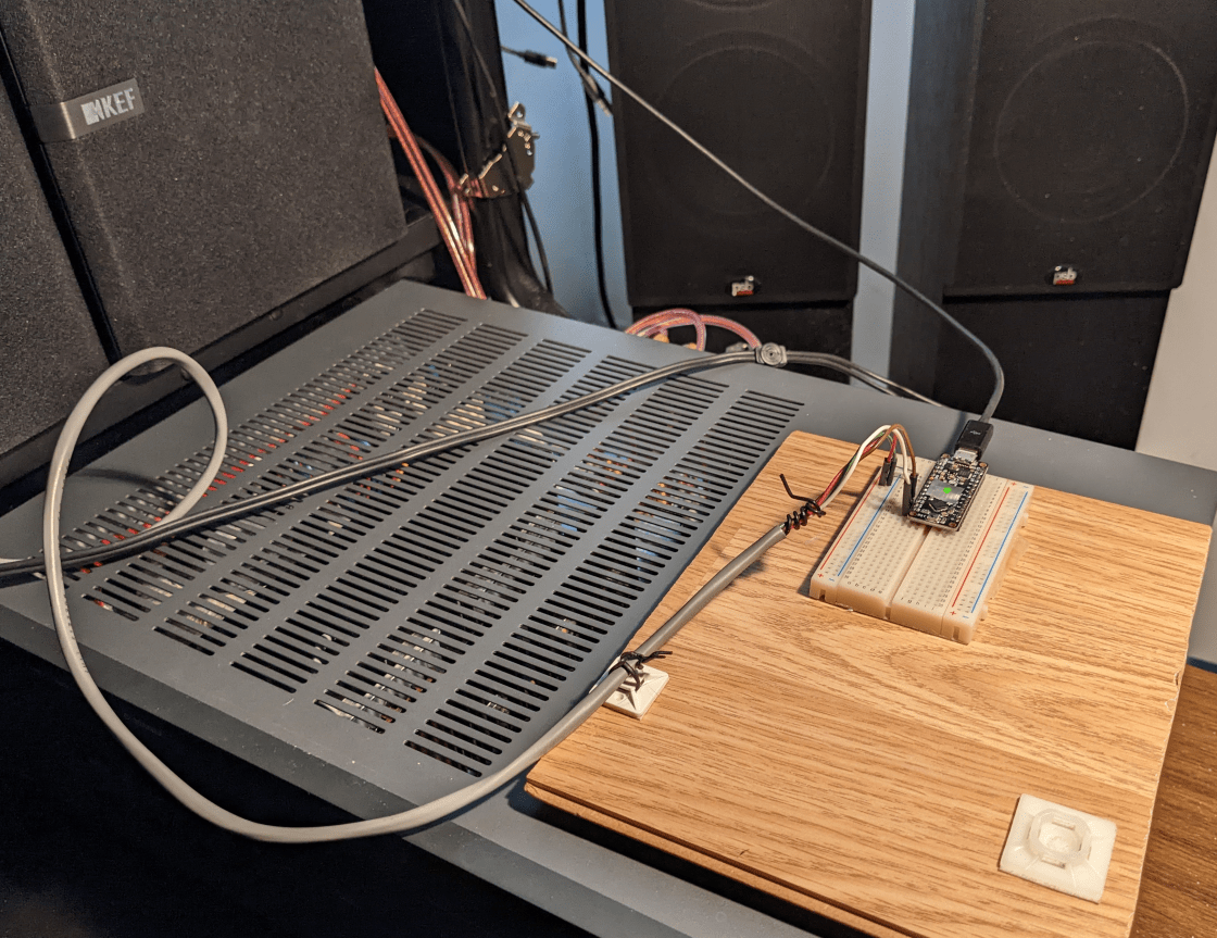

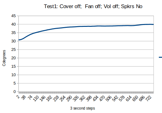

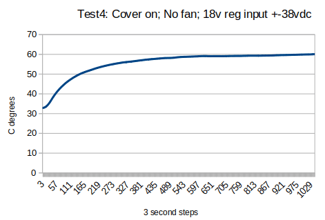

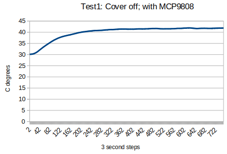

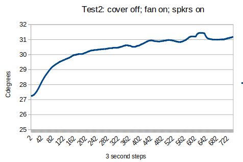

Did some temperature tests today of the NAD C320. Three of the tests stayed less than 40C which is a reasonable value which probably will not sting your fingers. However, test4 had my mods deactivated so that the behaviour is factory equivalent. It slowly climbed above 60C before I got tired waiting for stability. Perhaps thermal runaway would have occured if a butterfly flapped it's wings.
TestRig.png shows the temperature logging devices from Adafruit: Metro Mini 328 which is Arduino UNO equivalent. The 4-wire cable connects to MCP9808 accurate temperature sensor which is generic I2C. The temperature is measured every 3 seconds and logged in PC text file which is graphically displayed in a spreadsheet.
NAD-MCP9808.png shows the I2C cable entering via the output stage heatsink. The MCP9808 board is inserted into a groove of the +18vdc heatsink. It would be better if it was thermally bonded but this is good enough as is for comparative measurements.
The fan blows towards the 18v heatsinks. There is no input of external air so hot air just swirls around and lowers the temperature by spreading the heat. Some of it will find it's way to the vents.

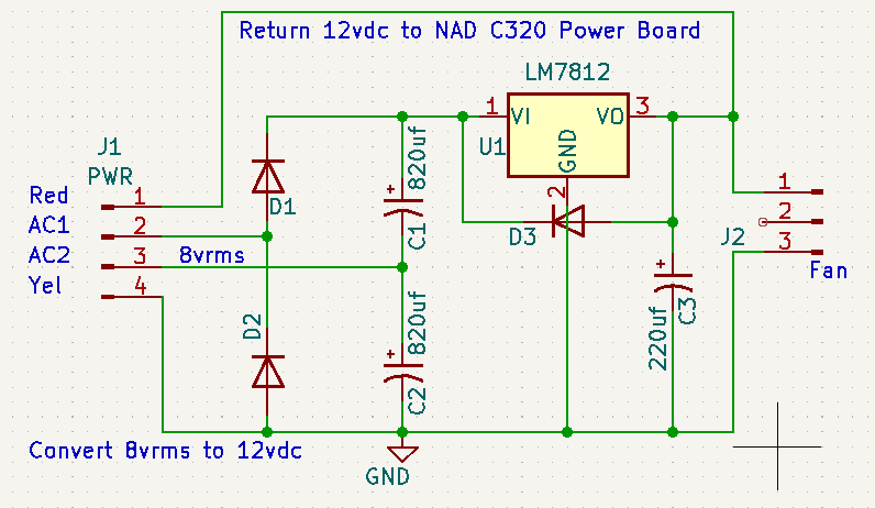

Fan-84vrms-12vdc.png is the voltage doubler which steals power from the rectifier board and shares the 12vdc needed by the fan. There is 16vdc created for the LM7812. The gridded PCB is clipped to the copper ground bar. Installation is not finished yet.

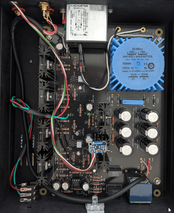

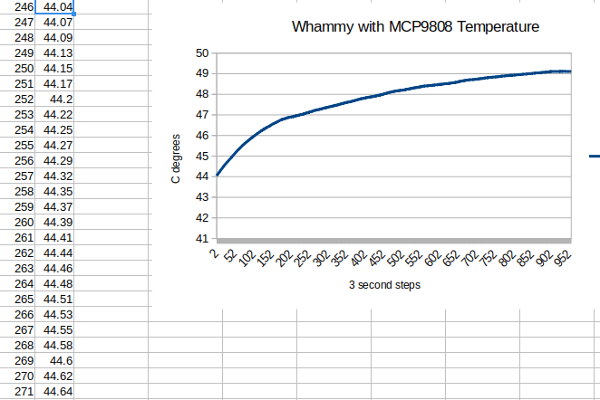

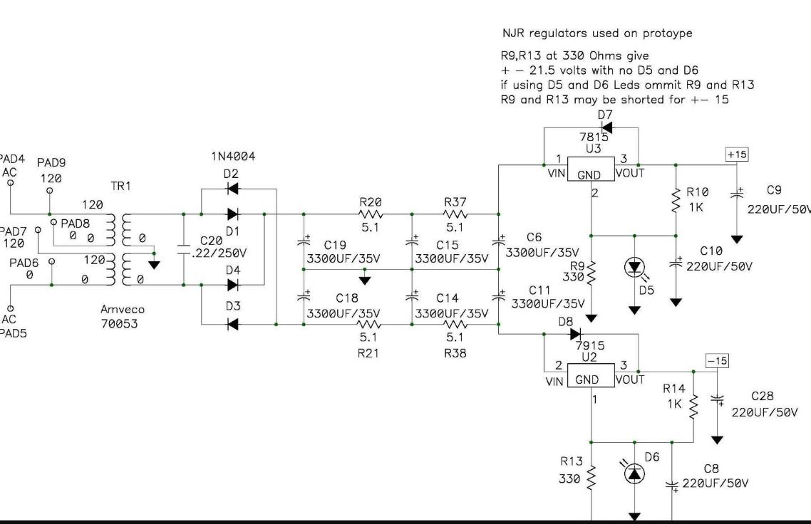

This post is for the Whammy HPA complete kit. It has regulator vertical heatsinks like the NAD 320 but fancier. It is Class A with the 7815 and 7915 each powering two mosfets. So the regulators power the hot spot in the Whammy. My build has the default settings. For example, the 7815 is lifted 2.1v by a LED which gives 17.1vdc output. There is 26.6vdc coming into the 7815 so it has a 9.1vdc drop. There is an option to restore the standard 15vdc but that would increase the heat generated by the 7815 so this option seems unwise.
The Whammy MCP9808 measures are fine at 40C with the cover removed. I recommend to operate it this way.
It took 50 minutes to reach 49C with the cover installed. I stopped logging but the temperature is still slowly rising. Now it is 49.7C or 121.5F. It's like baking a turkey.
...609, 50.01, 610, 50.02, 611, 50.02, 612, 50.02 ,613, 50.02, 614, 50.03 ...
And it just passed 50, the baking continues

The Whammy is Class A with 60ma bias. So each regulator must provide 120+ ma. even when idle. The percent load does not matter since I am making comparative measures, not absolute value.What percent load?
What music?
The Whammy-reg image in the previous post has a 70053 xfmr with 2x15vac secondary. This unit is obsolete so 70064 comes with the kit. The kit unit has 2x18vac so there is more voltage to regulate.

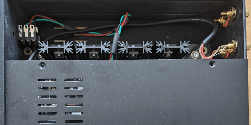

Some Whammy HPA have different cases. The covers of the black case are only 25% vented, the vents are not aligned with the PCB heatsinks, so cooling is inefficient allowing temperature to rise for an hour or more of operation.

That obsolete Amveco 70053K is equal to the available Talema 70053K and they both even have the same typenumber. There is not more voltage to regulate when using a 2 x 18V transformer but there is more power to dissipate in useless heat. A challenge could be to use Schottky diodes and LT3045/LT3094 ultra low noise LDO regs with a 2 x 12V transformer to have +/-15V with a selected transformer. Maybe it would even work OK with a bog standard Talema 70052K as with 120 mA load it will give higher voltage than 2 x 12V ac. Challenging but interesting as load is constant with class A and ripple voltage is low with 120 mA so it either works with enough margin or it does not. Cleaner voltage, lower losses. I do so with a PSU and it measures fine, it has more than enough margin with a higher load current. It is cool too and it has only a few ventilation slots.
