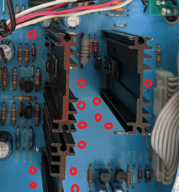

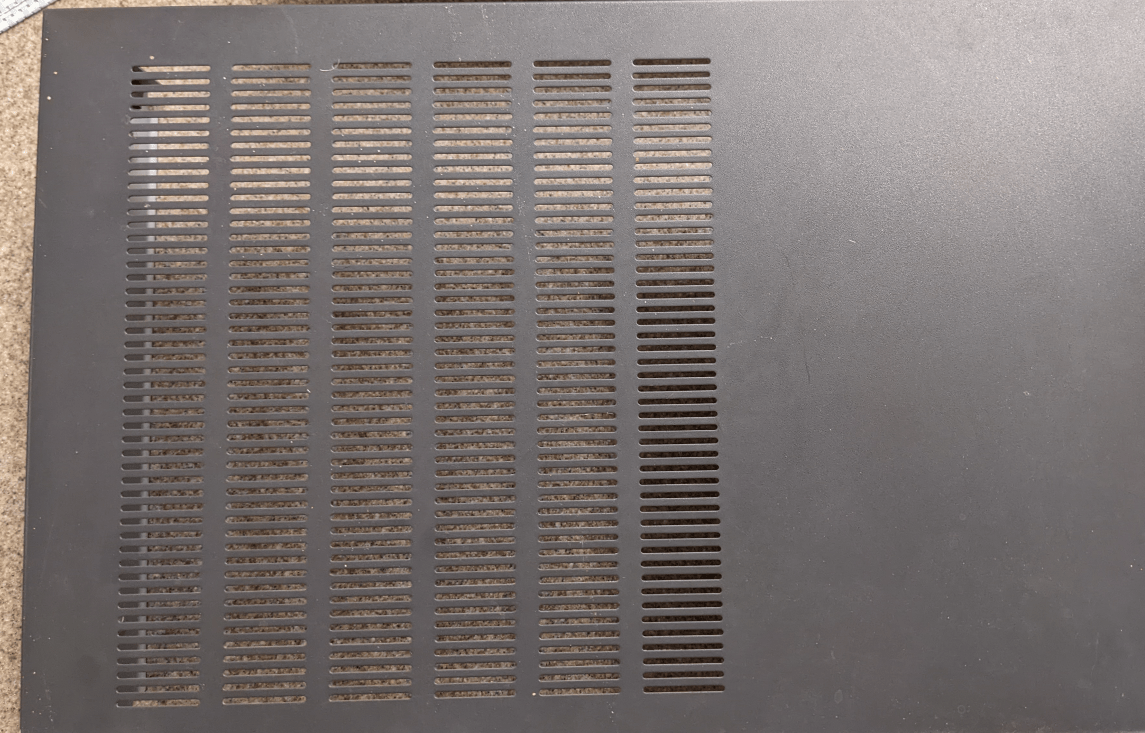

The device is what it is and the question is not about the competence of the manufacturer, but how to eliminate its error. First of all, replace thermal grease, drill openings in free places near radiators if possible. The author of the topic did not show the bottom of the apparatus, whether there are holes in the area of radiators. It will not help, put a small fan on reduced revolutions with the direction of air up.

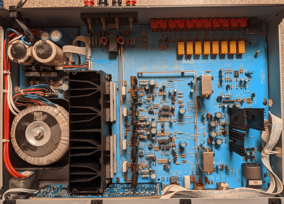

Here is the base plate of the NAD C320. There is big opening for the output stage, a grill for the power entry board, a grill under the main board driver area, and the rest is unvented. The main board mainly blocks air trying to rise from the base.
I am now preparing to do some temperature measurements under various operating conditions.
My understanding is that for ventilation to work properly the size of the escapes should be larger than that of the inputs.
If there is about 5mm space between the case and the circuit board I still think the problem is the lack of escape holes in the case top above those hot spots.

And of space permits, use taller stand offs under the main PCB, so air flow is improved.
And you can always make holes in blank parts of the PCB.
Did some temperature tests today of the NAD C320. Three of the tests stayed less than 40C which is a reasonable value which probably will not sting your fingers. However, test4 had my mods deactivated so that the behaviour is factory equivalent. It slowly climbed above 60C before I got tired waiting for stability. Perhaps thermal runaway would have occured if a butterfly flapped it's wings.
TestRig.png shows the temperature logging devices from Adafruit: Metro Mini 328 which is Arduino UNO equivalent. The 4-wire cable connects to MCP9808 accurate temperature sensor which is generic I2C. The temperature is measured every 3 seconds and logged in PC text file which is graphically displayed in a spreadsheet.
NAD-MCP9808.png shows the I2C cable entering via the output stage heatsink. The MCP9808 board is inserted into a groove of the +18vdc heatsink. It would be better if it was thermally bonded but this is good enough as is for comparative measurements.
The fan blows towards the 18v heatsinks. There is no input of external air so hot air just swirls around and lowers the temperature by spreading the heat. Some of it will find it's way to the vents.
