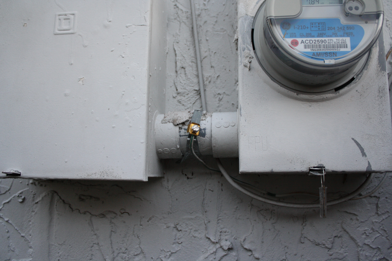

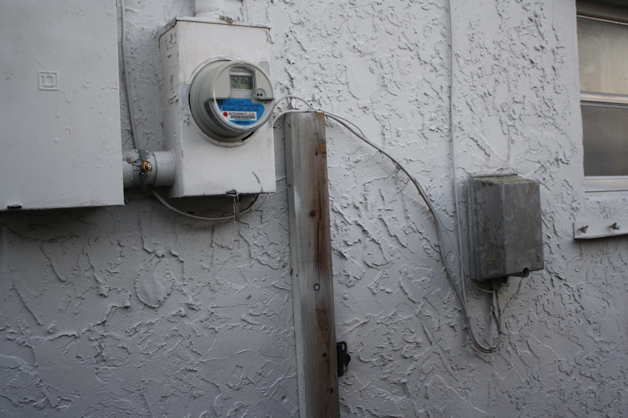

Sometime in 2013 A Comcast tech came to the house while I was at work, told Sherri that he had to upgrade the wiring on the outside of the house. He was there for about 10 minutes and left. Later that night I noticed a faint buzz in the sound and faint hum bars on the TV. I decided to check the connections on the back of the cable box, and when I took the cable connection off the back of the cable box there was a spark and I got a shock.
There was about 40 volts of nasty AC between the ground side of the incoming RF cable and the chassis of the cable box. WTF?????

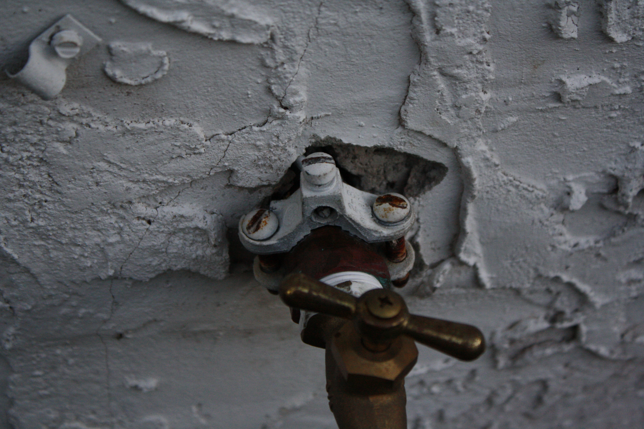

The next morning I went outside to investigate the "wiring upgrade." The ACE cable guy had disconnected the water pipe ground that had worked fine for over 20 years and installed a clamp on the fat electrical conduit that goes between the electric meter and the master breaker / disconnect box. OK there was a #10 wire running between the electrical box and the water pipe ground behind the stucco, so these were the same ground.....no big deal.
My first call to Comcast was met with an idiot who said that the problem was probably in my TV system. They would send a tech out and if the problem was inside my house I would be billed $45 for the service call. I had already been down this road with them before so I told them that I would check it out myself......
After fixing things for over 50 years I have learned that if it worked before you messed with it, and it was broken after you messed with it, you f......
Super ACE cable guy had put his "ground clamp" on a PLASTIC piece of conduit! In the process he had left the setscrew loose in the water pipe ground clamp when he pulled his wire out, thus removing ground from the house electrical service and wireline phone system. The entire house now had a floating ground. A quick check of my neighbor's house revealed the same "upgrade." Did this whole block of 7 houses now have no ground?
I made a second call to Comcast. This time I explained that their ace tech had modified my cable wiring and in the process removed the grounding from the ENTIRE house wiring system and the phone system (AT&T). This was a serious violation of the National Electric Code, which resulted in me receiving an electric shock, and my next three phone calls would be to the city building inspector, Florida Power and Light, and to AT&T since my electrical and phone service drops were now ungrounded and thus in violation of the NEC due to poor work by Comcast.
This got some attention. A "supervisor" said that a technical "expert" would be at my location "soon." I explained that I was already late for work due to their incompetence, and if their expert wasn't there before I was ready to leave, i would make the three phone calls and go to work.
About 20 minutes later a Comcast guy showed up who did have more than two working brain cells and knew that the little pipe between the two boxes was plastic and that there was no ground. He explained that there was some reason that they were no longer allowed to "bond" their systems to water pipe ground, they had to use electrical system ground. That may make sense in newer neighborhoods where much of the water system was plastic, but our neighborhood was developed in the mid 70's when water service was all copper, and a pretty good ground.
He put it back the way it was, but the wire had been cut shorter by "Ace" so he just ran it straight across the wall where it would be easily snagged by my lawnmower or even the fence gate. Someone else would come back to do it right within a day or two.....2 years later I sold the house and left Florida for good. It had never been done right.
I showed the expert the mess on the house next door, and he was going to fix it. He was still working on another house on the next block when I returned for lunch several hours later......apparently there was a bunch of this "upgrading" going on.
