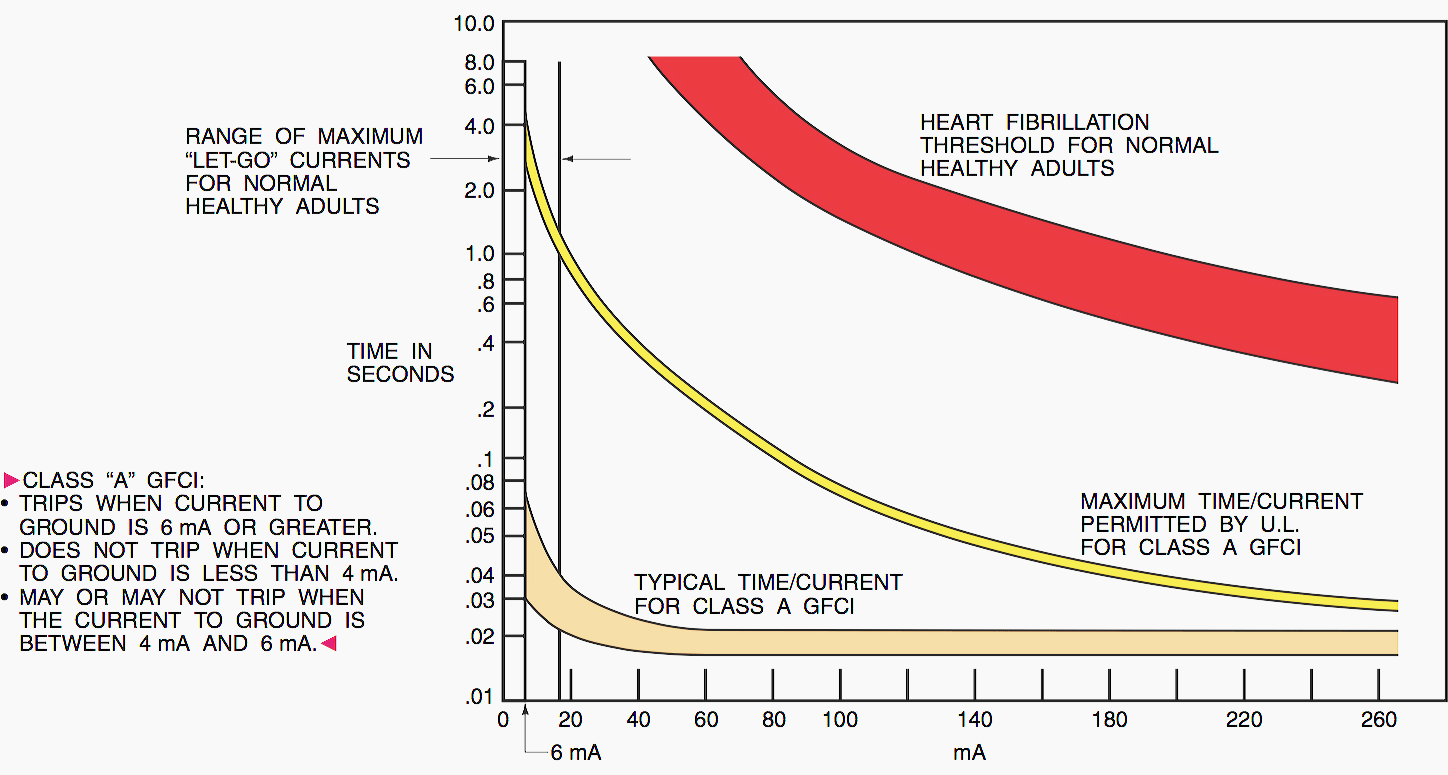

> Not sure where the 30mA is from. For a 15A GFCI, it's 5mA
Look at the spec. It is a *Time Curve*. 30mA will trip quickly. 5mA will trip after some time. I strongly suspect that UK-spec "30mA" and US-spec "5mA" are the SAME calibration, but the nominal names taken from different points on the same curve.

The 30mA is a rough number. The typical resistance for a man is different than the typical resistance for a woman. (Typical man and woman???) Things change as we age, and rough hands from manual labor increase this resistance. The resistance of a person is roughly 500 to 1000 ohms.
Most protective devices are labeled in amps, but that's rarely the technical reality. A gfci provides no current limiting devices, so when my body ends up in series between the phase and neutral, I am exposed to the entire fault current available in the circuit. In reality it's a time curve that we're working with. How fast the fault can be cleared cleared, or in the case of the gfci, how fast the circuit can be deenergized. A 10A breaker just trips faster than a 20A breaker during a fault, but I receive the same amount of current till it trips.
Fuses are the same way. Grab a 1A fuse, a rheostat, and a 12v battery. Slowly increase load through the fuse and you will get it to hold more than 1A. In some cases, 150% more. It eventually melts out instead of blowing. I see 40A fuses hold at 50A every summer as AC loads grow. A 10A difference is well within the margin of error of my ammeter.

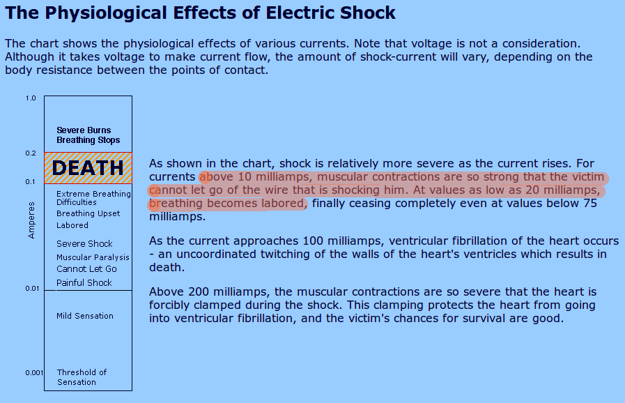

If you look at the chart, the big box before DEATH is from what 10 to 100 milliamps? That's a very wide range of currents. It's there to take into account the differences in our bodily makeup.

So: we should be thinking " a GFCI limits the total energy (joules) delivered by the shock" rather than "a GFCI limits the maximum current delivered by the shock", yes?

....The resistance of a person is roughly 500 to 1000 ohms. ...
Surely you have an ohmmeter? So you can show that "normal" is more like 10K-100K. On 120V, that's hardly dangerous (why Edison worked with 100V; fewer deaths).
As you say, everybody is different. I knew a guy could not feel straight 117V AC. His skin resistance was close to 1Meg.
But then we have the worst cases. George comes off the surfboard saturated in seawater and sweat, stands barefoot on concrete, grabs the guitar.
Also, and often key: with continued current the 10K skin resistance breaks-down. Cells get leaky. Body juice soaks the dry skin cells. Skin resistance can fall below 1K faster than a person can understand the danger. Now we are into lethal shocks.
