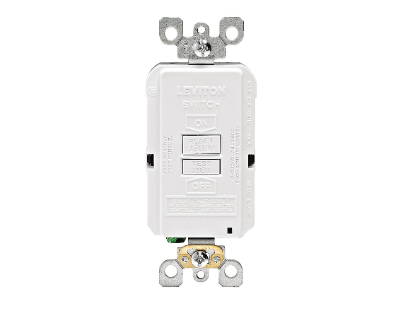

For additional safety, I have wondered about installing a blank-face GFCI ( https://www.homedepot.ca/product/decora-20-amp-blank-face-gfci/1000166706 ) on my DIY guitar amps, and running the AC wiring through it before it gets to the power transformer.
Some blank-face GFCIs seem to be rated for use as on-off switches, so it could double as the amp's power switch.
However I'm not an electrician, and would welcome pros and cons from someone who knows more about GFCIs and shock hazards than I do.

...Some blank-face GFCIs seem to be rated for use as on-off switches, so it could double as the amp's power switch....
The recessed test/reset buttons are clearly not a general-use power switch. They are rated for the 'required" monthly test but that does not imply everyday switching. (Related topic in fusebox circuit breakers: can you turn store lights out every day with the breaker? Recent rulings tend to require "switch rated" breakers, not ordinary breakers.)
However there *seems* to be GFIs plus a switch. Listed here and there but I have not found any in-stock. As this is a $20 GFI and a $1 switch in one $36 unit, the advantage is dim.
I know this is not what you were saying, but the FIRST steps are good isolation transformer and good 3rd-pin grounding. After that, a GFI does seem wise, but essentially never done.

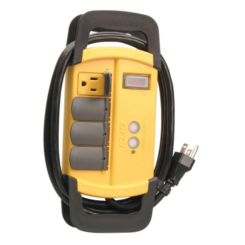

A construction-grade GFI Outlet Strip, on stage, for the entire band to use (assuming no 2KW bass amp) might be a good alternative.
