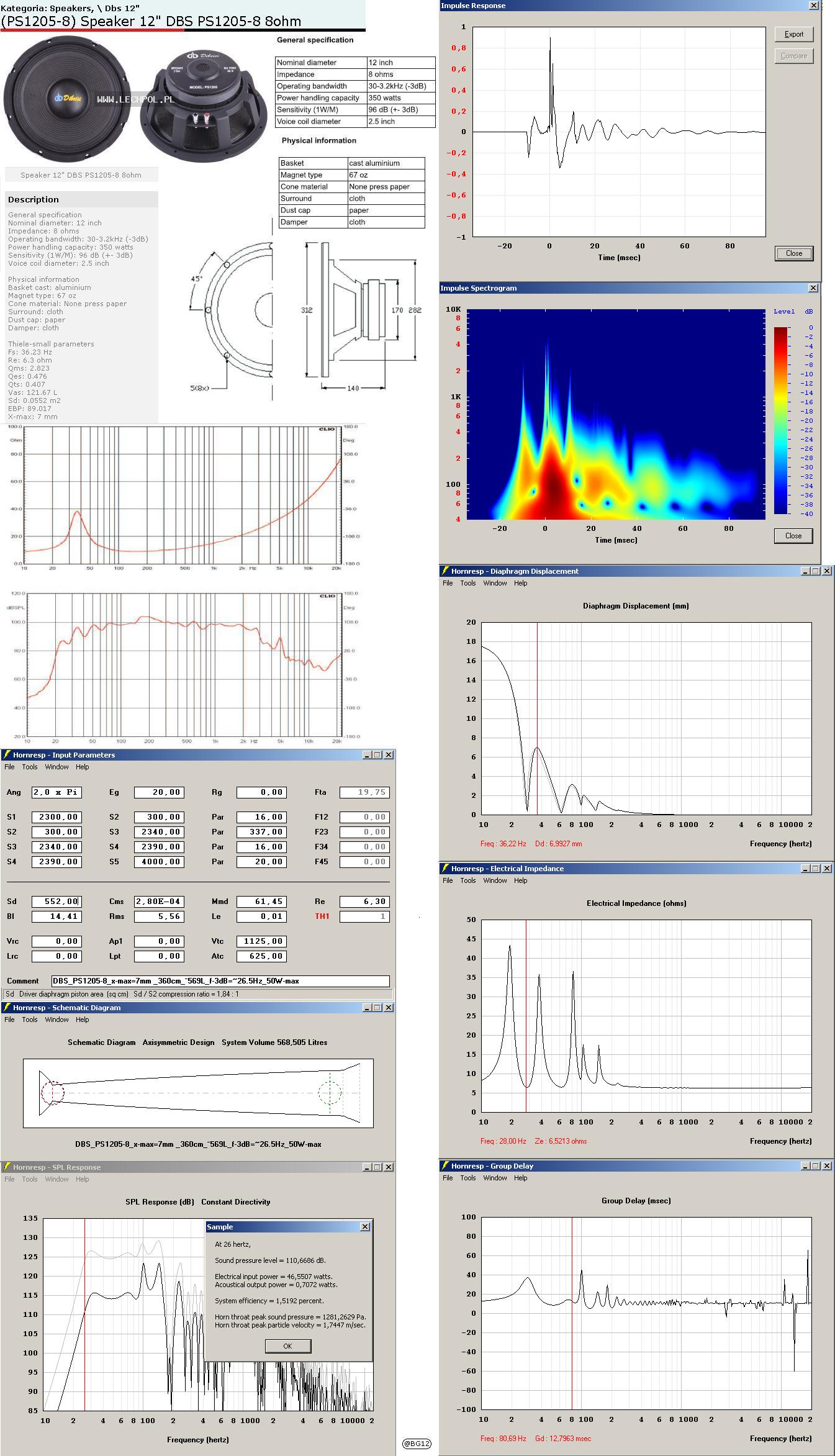

need help have this speaker ,will this work in front loaded horn
how large would box be for around 35hz to 100hz ?
THIELE-SMALL PARAMRTERS
Fs: 36.23 HZ
Re: 6.3 ohm
Qms: 2.823
Qes: 0.476
Qts: 0.407
Vas: 121.67 liters
Sd: 0.0552 m2 <---- where do i enter this in hornrsp
EBP 89.017
Voice Coil Over Hang X-max 7 mm
Fs: 36.23 HZ
Re: 6.3 ohm
Qms: 2.823
Qes: 0.476
Qts: 0.407
Vas: 121.67 liters
EBP 89.017

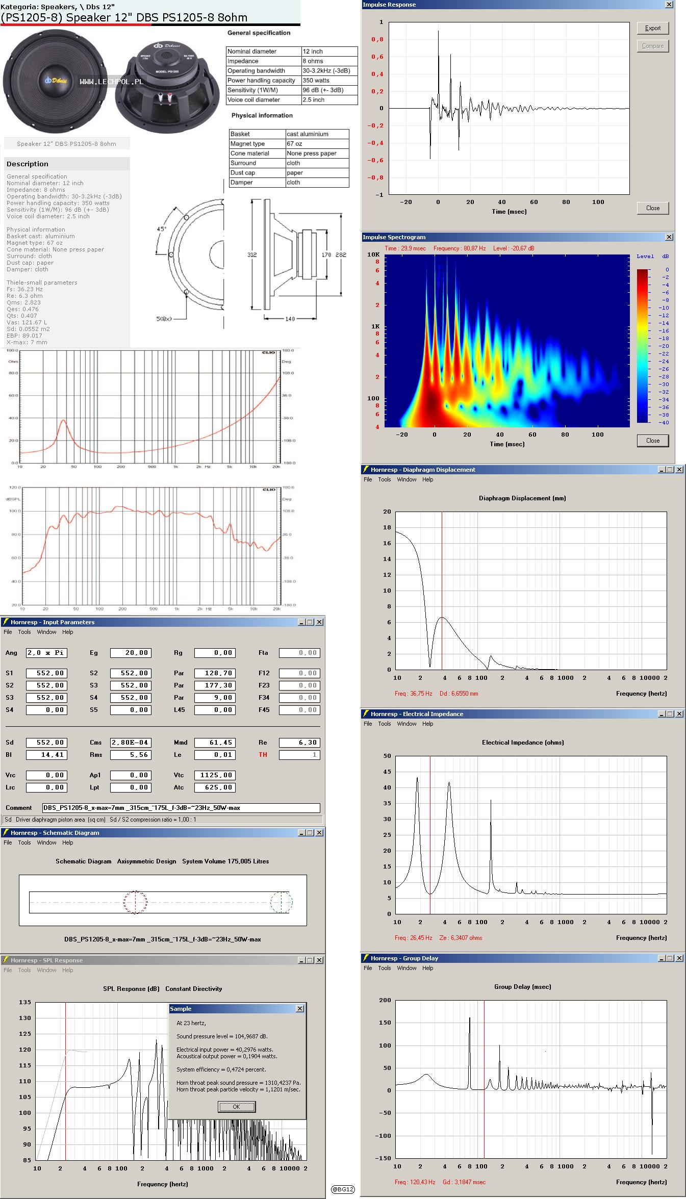

Here is a quick made HR template to import using a total volume of~3.8 m^3 for a 32 Hz FLH. (Qt box =0.7). Try keep the FR as smooth as this example when shrinking the size to the target of 35 Hz.
b🙂
FYI:
Revealing the undercover driver :
b🙂
