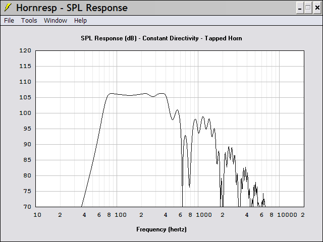

Here's a 2pi space/1 W 6.5" frame size ~98 dB eff. (calculated) driver in a ~366 L bulk expo sim I posted much earlier in this thread IIRC, so a ~8 dB gain in its ~flat pass-band, though the driver can be scaled up to a larger frame size more suited to high power/SPL if required, but I'll leave it to Ian, PB, et al to define the driver specs required to duplicate (beat?) this theoretical performance in a BR or BP sim of the same bulk if more curious than me.
FWIW, this driver in an optimized FLH of the same Fc outperforms it overall in every Hornresp simmed way plus is smaller at ~276 L, implying it's the 'no-brainer' choice once you move up into the > ~100 Hz BW, though done no research to confirm it, so as always YMMV.

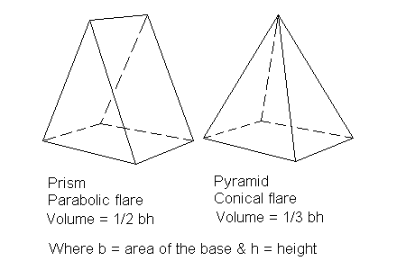

Take a look at the attached pic. Almost all of us are building horns as truncated prisms, but we're telling Hornresp that they’re truncated cones (con).
If you use the "Tapped Horn Wizard" to generate s2 and/or s3, or use the "Schematic Diagram" to compute the horn volume, you're not building what you're simulating. With the gentle flare rates of Tapped Horns, the difference is often small, but several people have had problems.
This is the point I was trying to make WRT conic Vs linear expansions awhile back when two walls were parallel and the divider board was straight.
Still think it's a conic expansion?
GM
GM
No, two parallel walls and an angled divider doesn't make a cone.
My post was intended to be a friendly warning to Hornresp users. It's been a long time since some of us have opened a solid geometry text book.
You make an important point, Don. Two straight and two conical sides gives the wavefront expansion of a parabolic horn. Bends etc will also cause the wavefront expansion to differ what is assumed in the simulation, and it will also make it a bit harder to estimate the acoustic length of the horn.
