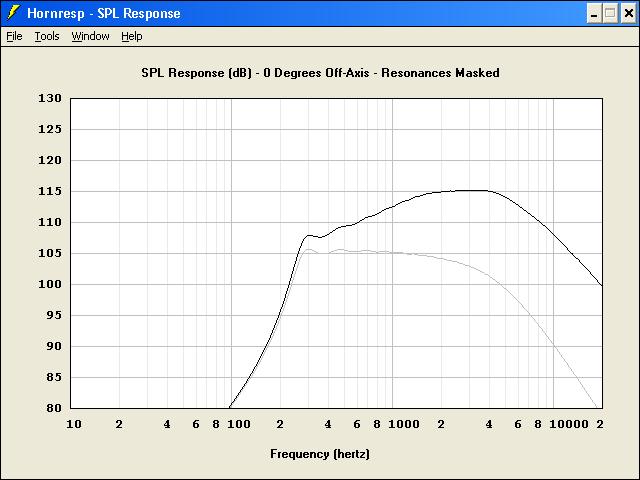

Could this model be accurate enough for use up to 2kHz?
Hi Lars,
I can't see why not, if your driver parameter values are correct. The on-axis pressure response will of course be a bit different to the constant directivity (power) response you have shown (see attached comparison).
Kind regards,
David
