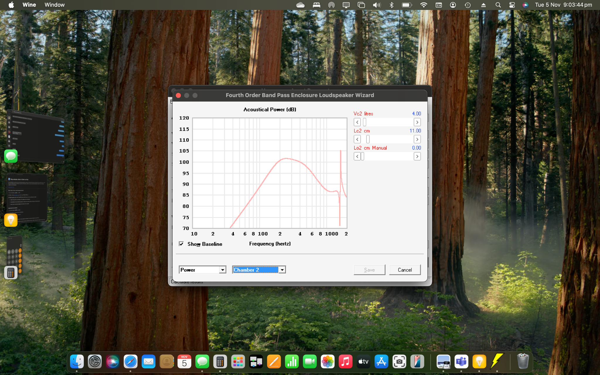

the error doesn't occur at all when i push "save" after other/auto, and then "wizard" again, chamber2, etc.
I have studied the relevant code carefully but have not been able to identify why the error occurs in one case and not the other. It will have to remain one of life's little mysteries. I did however pick up a minor unrelated bug which will be fixed in the next update.
No further work will be done on Hornresp trying to find workarounds for Windows - Wine/Linux incompatibilities. It is like looking for a needle in a haystack, not being able to generate the errors myself. As recent history has shown, it becomes just a frustrating exercise of trial and error.

I single-stepped through more than a thousand lines of code twice, starting from when the Lc2 slider was moved.
The first time was after Other > Auto > Chamber 2 > adjust Lc2
The second time was after Other > Auto > Save > Wizard > Chamber 2 > adjust Lc2
I was trying to see something different happening in each sequence which would explain why the error occurred the first time but not the second. Unfortunately the processes and values used by the program for each sequence proved to be identical, so I was none the wiser - just very frustrated 🙂.

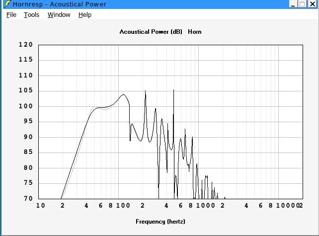

Hi David,
Having a problem, I attach the record.
The first is the original, the second is a copy.
After changing the second record, the driver position with the wizard and putting the driver back at the same spot the power response is different. Something else is that Hornresp doesn't recognize a PH1 record as you will see when you open the attachment. With mixed records sometimes it does change Lrc, Tal and Atc to Con but mostly it doesn't.

Hi Norbert,
I changed the L12, L23, L34 and L45 slider settings in the Loudspeaker Wizard to shift the driver position and alter the power response. I then set the lengths back to their initial values. The power response reverted to the original curve. In my case there was no difference.
I see what you mean. I need to investigate further. Thanks for the feedback!

Linux with Wine, do you think that's causing this? I just shifted L12 and L67 and put them back I get a different curve. Attached the window.Are you running Hornresp on a Windows or a non-Windows computer?
I tried the same thing and can see the difference also, which means that it is not a Windows - Wine incompatibility problem.
Another one for me to investigate - thanks.

This is due to a Windows - Wine incompatibility problem. I have found a way to get around it though - it will be included in the next update.
Hi David, conclusion, in Windows the Cms changing (or maybe Vas) doesn't occur. With Wine/Linux everything is OK as long as I stay in the Wizard, when I save the record the Cms value changes, Vas is 100 times bigger then it should be after saving. In Linux the only way to correct it is to paste the driver again, in windows I can change the Cms value after double clicking and everything is ok, not possible in Linux, getting an error about the values are wrong Cms and more. Some additional info, my version/regional settings are dutch, the decimal is, and not . could that have something to do with this? I remember from some time ago there was something going on with Hornresp and regional settings but what???
