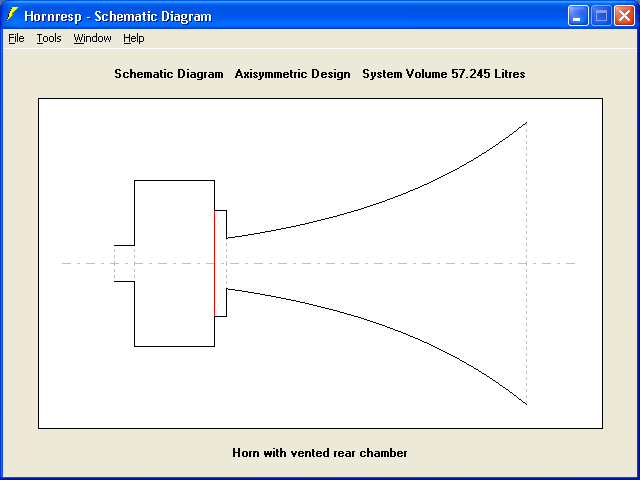

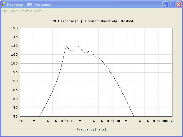

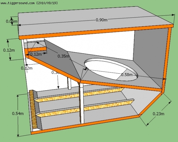

hi david friend
try to sim FLH likes the pic i post above. david friend i want to ask that if the resp freq has a ripple -+ not over than 5 db, i want to know it can work fine. and another one question i see the the F horn on this pic. i'll try to sim and use the OD option. is it all right./🙂

Hi Thawach,
That is really something for you to decide, although +/- 3dB should be okay, I expect.
Assuming that I have interpreted the drawing correctly, I think I would probably simulate the design as a horn with a vented rear chamber, rather than as an offset driver horn.
Kind regards,
David
Kind regards,
David
thanks a lot david for this answer. at first i worry about transient respond. my model i want the short horn because this it's difficult to get flat respond freq. david i design again. it has problem a little. ok 1 watt is near to flat. but when i sim the high spl. it make me surprise that when i sim over than 70 watts. i see the voice coil is xceed. the woffer only has the x max 3 mm. but when i see the spec from manufacture. they has the handing power 200-300 watts. i'm surprise really. but does not matter. i 'll use this model. david most of people in thailand can't use this program. they know this is the best software. they would like to use for Pa. sorry they didn't know how to? yesterday i told on thai website. david reply to me is the best. ok david i'll use this software to sim the model and helps people who still have difficult life in thailand to make money for their life.
