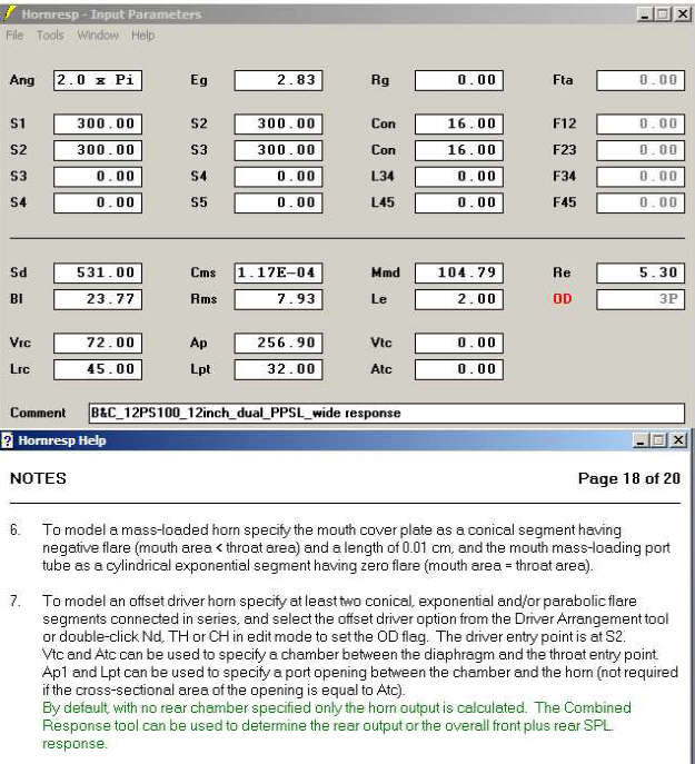

Hi David,
I'm trying to model a PPSL, e.g.:
http://www.diyaudio.com/forums/subwoofers/176729-klipsch-horn-woofer-designs-3.html.
Obviously, I could just model it as a BR, but that does not account for the front chamber (plenum). The OD horn looks like it may be the better choice, but when I read the help file I get the impression, that the rear chamber vent may be returned into the horn at the horn throat, which I guess would be S1.
It is nice to be able to model the front chamber of the PPSL as an OD (driver entry point at S2), and it would be great if the rear could be vented like a BR, or-even better-like a CH using the fourth horn section.
Hi Oliver,
I'm not sure that I understand the PPSL design correctly, but in an attempt to clarify the Hornresp OD horn options:
1. Add a new record using the default record as the parent.
2. Double-click Nd to select OD.
3. Double-click Fr to select Ap and note the message in the status bar panel at the bottom of the input screen - Ap and Lpt specify the port tube in a vented rear chamber. See also the red description in the first screenprint attached (Ap.png).
4. Double-click Ap to select Ap1 and note the message in the status bar panel at the bottom of the input screen - Ap1 and Lpt specify the port opening between a throat chamber and the entry into the horn at S2. See also the red description in the second screenprint attached (Ap1.png).
In other words, Ap is not the same as Ap1 🙂.
Hope this helps.
Kind regards,
David

Hi David,
Thank you for the explanation. Looks like I got it correct to begin with, I just didn't want to pass along information while I still had questions.
I had not noted the difference between Ap and Ap1. That adds another option, nice.
Thanks again, Regards,

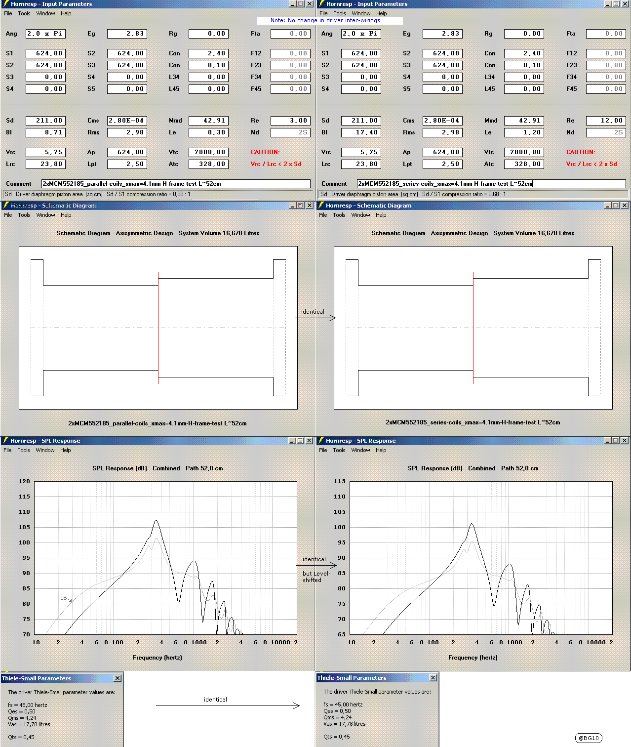

Hi, thanks for the help, also thanks for correcting my Sd, not sure where I picked up the wrong value.
I played around, and no matter how big or small I make the baffle, also when I compare your method of modelling to mine, the simulation below 100Hz seems to remain exactly the same.
Perhaps I'd need Edge to simulate this properly, or does it really not make a difference at all? I can hardly believe that....
What however does make a huge difference (unless I'm modeling this wrong), which surprised me, is switching from series-parallel to parallel-series connection (using two dual voice coil drivers). Is this really such a huge change due to the different inductance of the different wiring configurations? I would have thought it would give 0 net change (as the total inductance seen by the amp remains the same), but perhaps I would have thought wrong?
Would the other parameters perhaps somehow measure thus differently when measured with the voicecoils in series, that the simulation would end up exactly the same again?
Just input the single driver specs using the voice coils as measured, and select series/parallel in HR. If you want to use a different voice coil setup, you will have to adjust the other parameters. More than Re and Le are altered when making this switch.
Thanks, I figured as much.
So that begs the question - would the two options simulate the exact same? Or would there really be differnces (though not as big as my incorrect simulation would indicate)?
The reason why you get the same response is you are only modeling the drivers into IB, i.e. the rear of the drivers are terminated into an infinite(closed) volume. To sum both rear and front contributions: you must after pressing the 'Calculate' button and choose 'SPL' response also click on the 'Tools' menu and press the 'Combined' response and enter the path difference, too.
The 'Edge' program cannot model your enclosure including the specific drivers in use.
What however does make a huge difference (unless I'm modeling this wrong), which surprised me, is switching from series-parallel to parallel-series connection (using two dual voice coil drivers). Is this really such a huge change due to the different inductance of the different wiring configurations? I would have thought it would give 0 net change (as the total inductance seen by the amp remains the same), but perhaps I would have thought wrong?..Would the other parameters perhaps somehow measure thus differently when measured with the voicecoils in series, that the simulation would end up exactly the same again?..
There should be no difference(but the relative levels) when if 'switching from series-parallel to parallel-series connection' but a small difference in the entered TS parameters due to program round up effects.
To change from paralleled coils to series connected:
Click Sd and save the information of the calculated primary TS parameters, then double the BL value , Le and Re should also be quadrupled.
Click on Cms and enter the saved Vas value:
Click on Rms and enter saved fs and Qms.
Last:Check Mmd by entering fs again.
Compare the saved primary TS parameters by clicking on the Sd again,there should be no difference.
Note: In reality when using measured series/parallel connected coils:
All parameters are slightly off the theoretical as used here above, but if used, should return almost identical plotted graphs in HR,only very small (benign)deviations should be presented.
