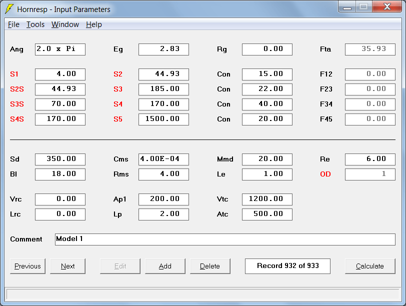

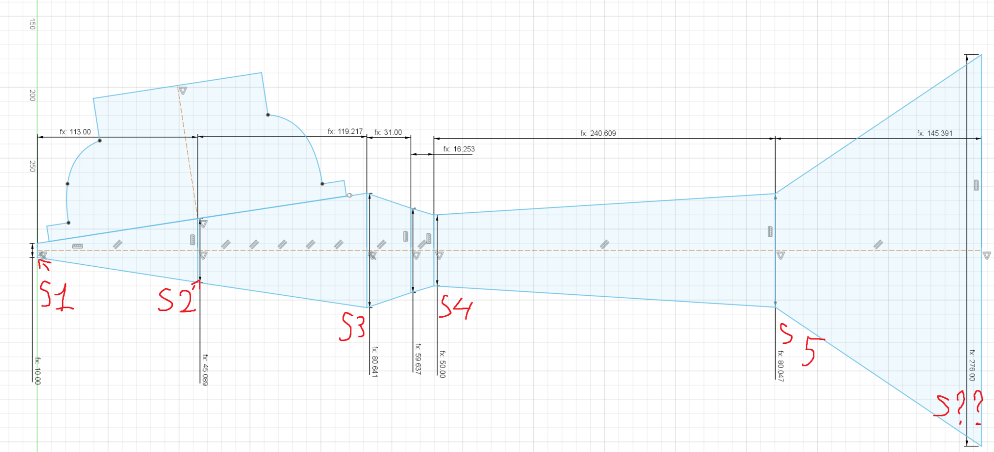

Hi all,
New to hornresp, I am trying to use it to simulate a horn that I'm considering building off of free plans I found. It's a front-loaded horn with an offset driver.
As best I can tell, unfolded, it will look like the drawing attached below - There's a narrowing after the first two segments, then expands again with a change in flare rate). But that means that, since I have to use S2 to locate the driver's offset, I seem to lack one segment to fully model this - I would need 5 ?
I'd like to find out how best to model that horn accurately.

I've seen David's post here that states:
Can I use this to still model my horn with an OD ? How should one specify a throat chamber to replace the missing segment here ?Four segments is normally the limit however a front loaded horn can have in effect five segments by specifying a throat adaptor [...]
Side not, is there an obvious reason I'm missing why there's a 4 segment limit ? How would one simulate one that's more complex ? I don't know, seems arbitrary to my uninitiated eye, I'm obsessing about this a little and it seems like I'm missing something super obvious, if someone wants to point it out my brain will be happy.

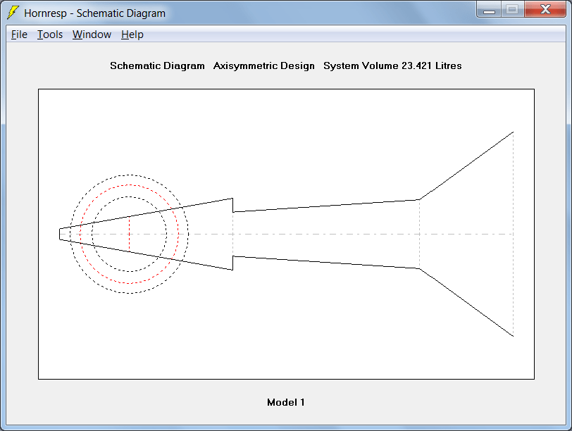

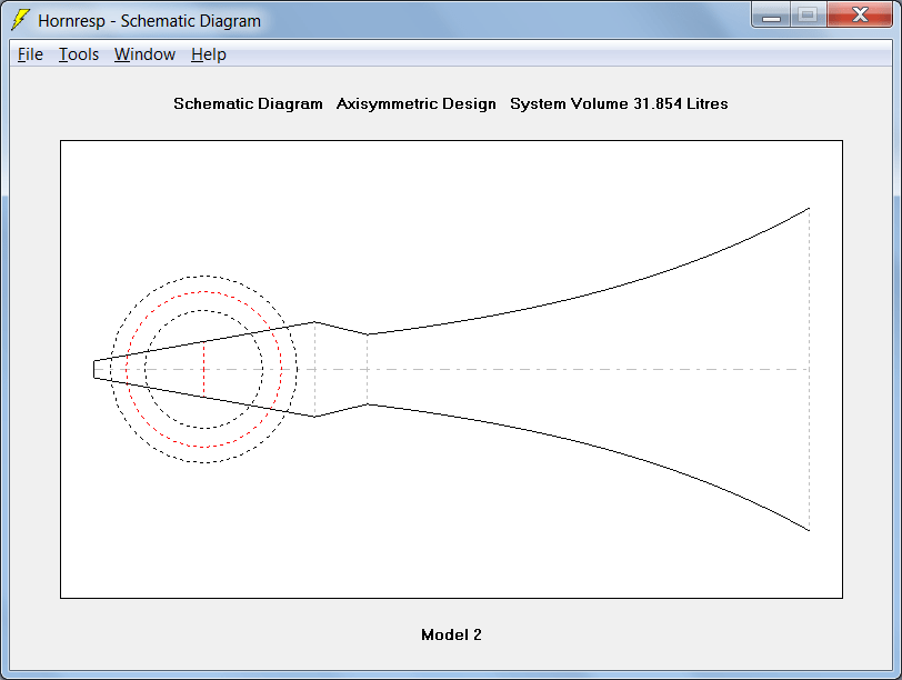

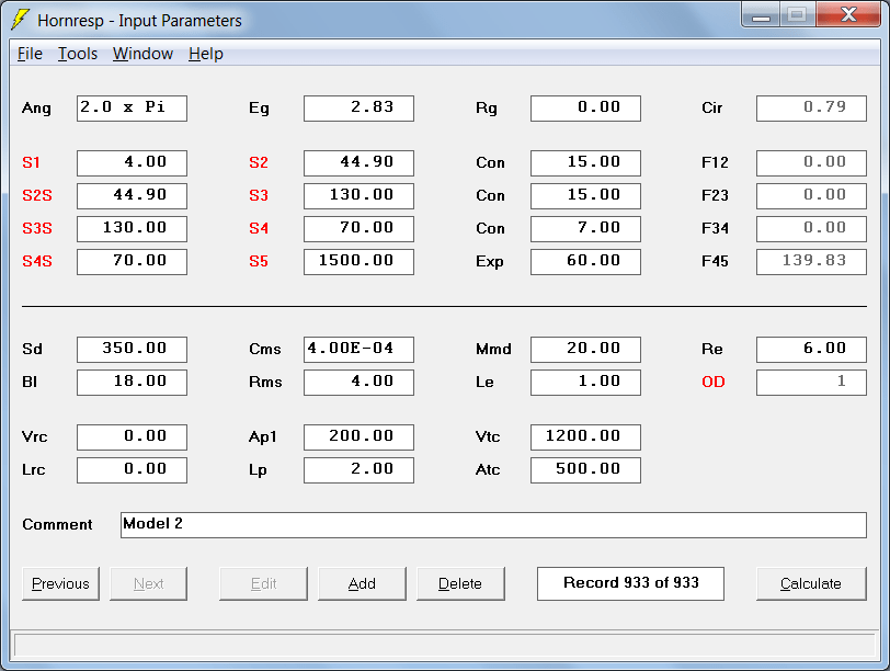

The throat adaptor becomes a throat chamber port in an offset driver system.
It will be necessary to approximate the actual design if it is to be modelled in Hornresp.
Two suggested approximations are shown in the attachments.

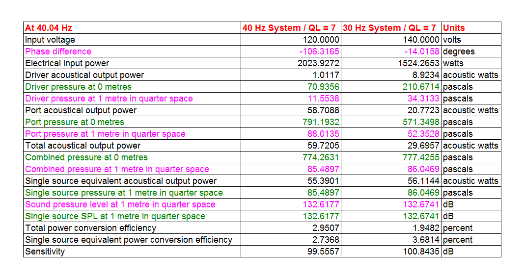

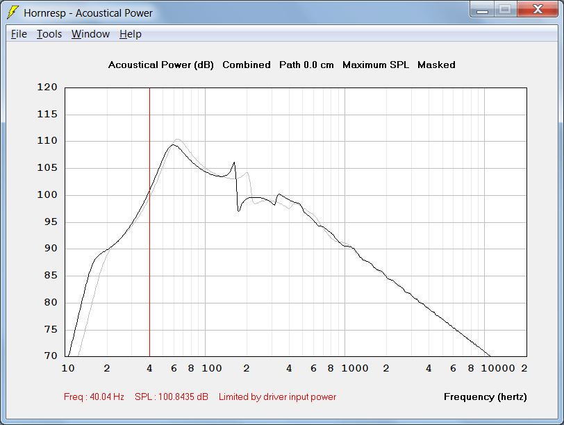

One would thought that under word efficiency, the most important would be the meaning of input watts versus output decibels.
As previously explained in Post #15,016, "input watts versus output decibels" is by definition a measure of sensitivity, not efficiency.
Sensitivity can be readily calculated in Hornresp using the Maximum SPL tool with the driver input power set to 1 watt and all other inputs switched off.
The black trace in the chart below shows the result for the 30Hz test system and the grey trace shows the result for the 40Hz system. At 40Hz the 30Hz system has the slightly higher sensitivity (100.8435 dB versus 99.5557 dB).
Incidentally, at 40Hz the two outputs of the 40Hz system have a phase difference of 106 degrees and the two outputs of the 30Hz system have a phase difference of 14 degrees.

The issue here is that the acoustical power here is not the usable output we are after. Acoustical pressure is. And to my knowledge, efficiency is the ratio of input power and usable/wanted output/performance. It doesn´t make sense to want anything else than acoustical pressure (except for other qualities, which do not belong to the efficiency performance bracket anyways). Why would we not want acoustical pressure or sound pressure level as the "denominator" of the efficiency? It is sincere question. We might learn here big time.
One could argue that the opposite situation happens above 60Hz. No it doesn´t. not that much energy there and not that much power input either. And the lower tuned solution still enjoys more cooling by cone displacement.
As seen in the table, the 40Hz design only loses 3 pascals due to phase mismatch of the cone output. That is negligible in out search for the core issue.
The table. "Single source equivalent power conversion efficiency". THIS! How do we get to such number?

The term speaker sensitivity is defined by voltage.
As explained earlier, the correct definition for loudspeaker sensitivity is:
At a given frequency:
Sensitivity is the SPL at a given distance (originally 1 metre) for a given reference power (originally 1 watt), expressed in decibels.
If the input was taken to be voltage rather than power, then the standard frequency response curve would also become the sensitivity curve. This is simply not the case.
Indeed input power versus decibels is also a "power sensitivity".
As explained earlier, SPL is a measure of pressure, not power:
SPL = 20 * Log10( Pressure / Reference_Pressure)
By rearranging the two formulas below, as given earlier:
Pressure = (Power * c * rho / Area) ^ 0.5
Pressure = Reference_Pressure * 10 ^ (SPL / 20)
Acoustical output power = Area * Pressure ^ 2 / (c * rho)
To illustrate for the 4OHz system at 40Hz:
Electrical input power = 2023.9272 watts
Pressure at 1 metre in quarter space = (20 * 10 ^-6) * 10 ^ (132.6177 / 20) = 85.4897 pascals
Acoustical output power = Pi * 85.4897 ^2 / (344 * 1.205) = 55.3901 watts
Power conversion efficiency = 55.3901 / 2023.9272 * 100 = 2.7368 percent
