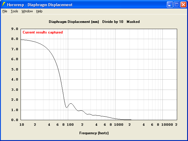

By the way capture feature does not work with displacement plot either - maybe its on my system as I run Hornresp under XP in Virtualbox ? - though didn't experience any troubles until now...

Yes - to me it seems to be the same results - just that I cant do overlay as you show.
Hi Michael,
This is very strange indeed. To capture results it should simply be a matter of:
1. Right-clicking the mouse on any chart to open the 'Capture current results' pop-up menu.
2. Clicking on the 'Capture current results' pop-up menu command to save the data. A red 'Current results captured' message should then be temporarily displayed in the top left corner of the chart to confirm that the information has been stored - see Attachment.
Captured results can then be subsequently compared to other results by selecting the 'Tools' > 'Compare Captured' menu command, or by pressing the F4 function key.

I suspect that the problem may be with your system 🙂. No-one else has reported similar issues and as you can see from my earlier attachment, the capture feature normally also works with the Diaphragm Displacement chart.

By the way capture feature does not work with displacement plot either - maybe its on my system as I run Hornresp under XP in Virtualbox?

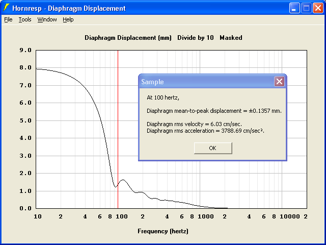

post1367.
The divide by 10 in the plot.
Does that mean that @ 100Hz the graph is showing displacement ~14mm one way and = 28mm peak to peak?

post1367.
which is it?It would be 0.14mm one way
1.4 / 10
Have the results been plotted after the software has divide by 10 or as David suggests, the user divides what is shown by 10?
Hi Andrew,
For the example you quoted, the user should divide Y-axis displacement values by 10.
When in doubt the Sample tool can always be used to check actual values. See the screenprint below and the Diaphragm Displacement description on page 6 of the Help file.
