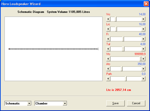

And a small difference in the Vtc parameter on the main panel and the one in Loudspeaker Wizard: on the first the number is limited to 999999,9, but the slider in the Wizard allows any value without restriction. No error there, simply distinct behaviour.

The import feature now is working fine. The version of the affected imported files was 25.60, my mistake.
Also I was wrong reporting the issue of the slider in Loudspeaker Wizard, it stops at 999999,9, sorry.

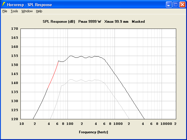

To compare Maximum SPL plots from two different records it is necessary to use the 'Compare Captured' rather than the 'Compare Previous' option. This is because the previous result will be the default SPL plot of the second record rather than the Maximum SPL plot of the first record - which is why your previous trace is way down compared to the Maximum SPL plot of the second record. See the Compare tool description on page 12 of the Hornresp Help file for details on how to capture and release results.

David, I gave the "capture feature" a try to overlay max SPL plots, but didn't succeed.
I did it both ways with right click and with strg-c / strg-x. Could you please check back?

Hi Michael,
Could you please try the following example:
1. Calculate normal SPL for default record 1.
2. Calculate Maximum SPL with Pmax = 500 and Xmax = 10.0 - see Attachment 1.
3. Capture current results.
4. Re-calculate normal SPL for default record 1.
5. Calculate Maximum SPL with Pmax = 9999 and Xmax = 99.9.
6. Compare captured result to current result - see Attachment 2.
Do you get similar results to me?
