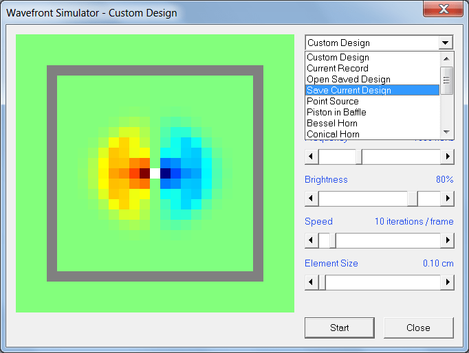

Hi GM,
Custom designs created in the Wavefront Simulator tool can be saved for future use, as shown in the attachment. The saved files are stored in the Waves folder.
With regard to the null problem, is there a certain sequence of actions that will produce the error that I can try, or is it a purely random event?

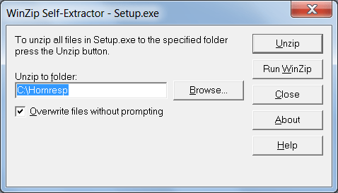

For the benefit of anyone else who may be experiencing problems installing Hornresp:
The Setup.exe download contains four zipped-up compressed files:
Hornresp.exe
Hornresp.hlp
Msvbvm60.dll
Readme.txt
Hornresp.exe is the executable program
Hornresp.hlp is the associated Help file
Msvbvm60.dll is a Visual Basic dynamic-link library
Readme.txt is a simple text file containing user information relating to the program
In Windows Explorer, double-click on the downloaded Setup.exe file and the form shown in Attachment 1 should appear. Click the Unzip button and the above four files should be automatically de-compressed and copied into the default C:\Hornresp folder, which will be automatically created if it does not already exist.

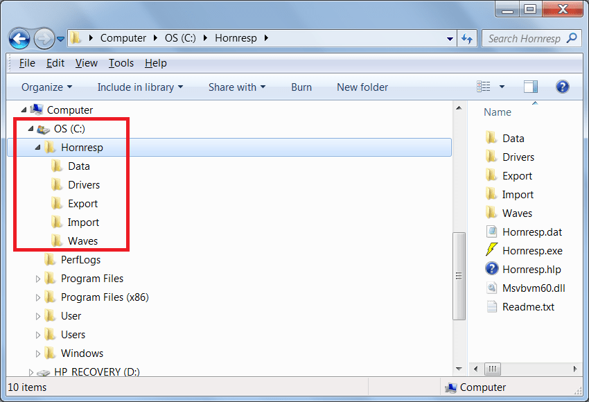

The first time that the program is run (by double-clicking on the Hornresp.exe filename) the following five folders will be created under the C: drive Hornresp folder:
Data
Drivers
Export
Import
Waves
As shown in Attachment 2.

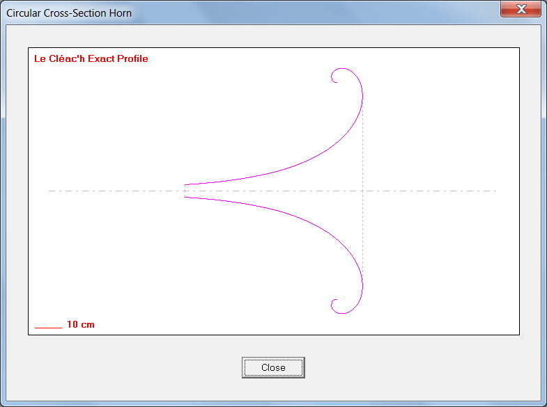

I miss him. He was a great guy.
Me too. He was one of the very best, a true gentleman. His Le Cléac'h horn expansion was a work of genius. The first time to my knowledge that an assumed isophase wavefront expansion rate was used to generate a horn profile using what were in effect finite element techniques, rather than just applying a relatively simple mathematical equation to define a profile. To my eyes, the folded-back Le Cléac'h hypex expansion profile is quite beautiful, there is something very natural and flower-like about it. (It is important to acknowledge though, that the acoustic horn so produced does not have constant directivity, and will beam somewhat at high frequencies).
I can't think of any horn that has both a nice wavefront and constant directivity. Maybe I'm wrong. Hope that I am!Me too. He was one of the very best, a true gentleman. His Le Cléac'h horn expansion was a work of genius. The first time to my knowledge that an assumed isophase wavefront expansion rate was used to generate a horn profile using what were in effect finite element techniques, rather than just applying a relatively simple mathematical equation to define a profile. To my eyes, the folded-back Le Cléac'h hypex expansion profile is quite beautiful, there is something very natural and flower-like about it. (It is important to acknowledge though, that the acoustic horn so produced does not have constant directivity, and will beam somewhat at high frequencies).

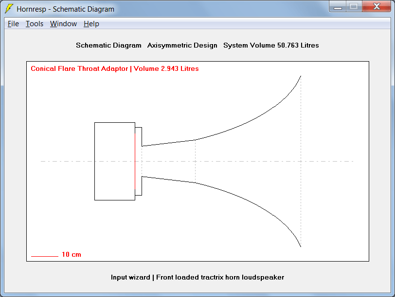

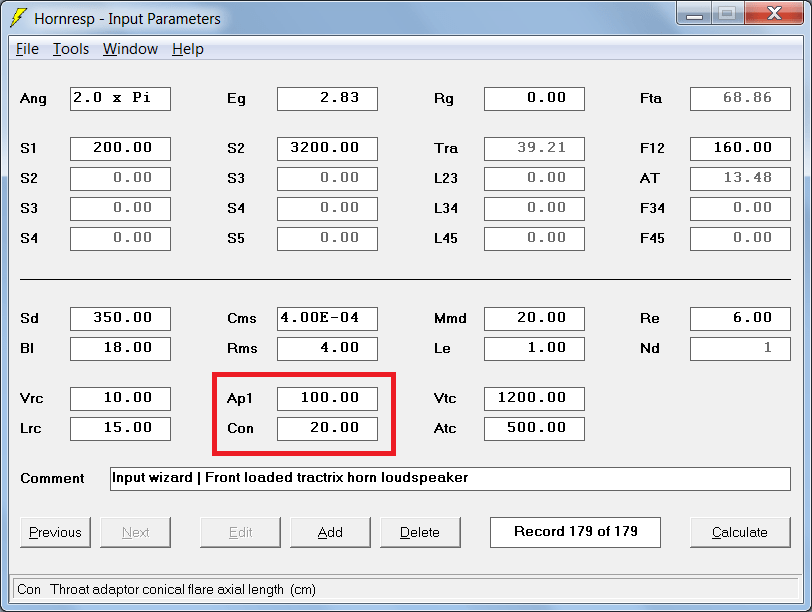

Hi Herb,Is there a way to model conical segments followed an ending tractrix flare section?
It is not possible to model a conical segment after the tractrix flare, but it is possible to model a single conical segment before the flare by specifying a conical throat adaptor, as shown in the attachments.
