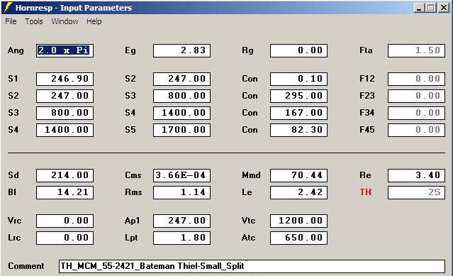

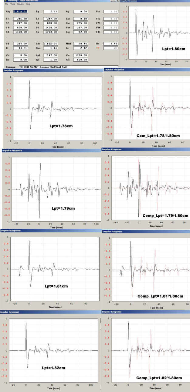

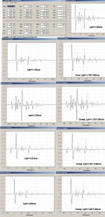

Impulse Response Problems?
Hi David,
When looking over a simulation for a tapped horn w/ throat chamber I noticed that the impulse response graph showed pronounced differences with only minute changes in the length of the throat chamber coupling duct. When listening to the respective .wav files I can hear a difference. There should not be an audible difference, the change is just too small.
As expected the SPL response only shows the slightest of differences, if any.
I plotted out impulse response data for Lpt=1.78 to Lpt=1.82. Also, you may notice how hard it is to see the red line in the comparison graphs.
Hi Oliver,
Interesting results - I am not sure why there should be such large differences.
Jean-Michel would be the best person to comment on this.
Kind regards,
David
Hi Oliver,
I will have a look at the Hornresp code over the weekend, and see if I can find anything obvious that might be causing the differences.
Kind regards,
David
