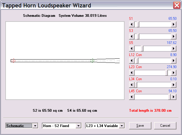

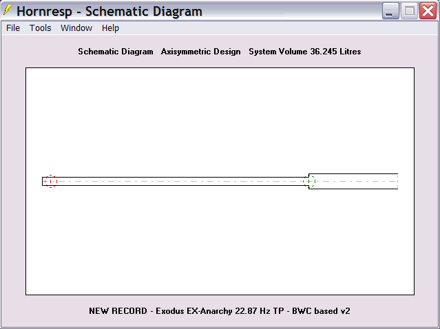

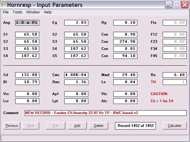

Design plots correctly in HR, but in the LW the last section has a tapered schematic, response. Note that at least some earlier versions of LW displayed them correctly since I have some older designs with this 'step', but now they all are 'off'.

Hi GM,
For a four-segment tapped horn, the 'Lizard' (my abbreviation for the Loudspeaker Wizard 🙂) automatically adjusts the value of S4 to provide a constant profile between S3 and S5. This has always been the case, and is one of the key features of the Wizard when used with tapped horns. The value of S4 cannot be changed manually, as no slider is provided. Note that in your example, the S4 value of 187.62 shown on the main input screen becomes 65.60 in the Wizard.
Not sure how you could have seen a 'step' in a tapped horn design in earlier versions of the 'Lizard' 🙂. Is it possible that you might have been looking at an offset driver design instead?
Kind regards,
David
Greets!
Well, there are some that are offset drivers and they do display properly in LW, but there's some tapped pipes too from when the TH Wizard was first released. I thought I'd used it for a few of them too, but apparently not.
GM

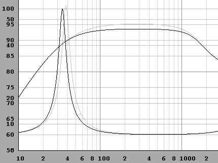

David, can you comment this graphs? the same driver (144 litres Vas)in 2pi
gray - with 22222 litres rear chamber(its half rear room)).
black - w\o rear chamber.
and will roughly the same listening room in front of driver produce similar effect?

Hi Flaesh,
Sorry, but I am not exactly sure what it is that you are asking - perhaps someone else may care to comment? A screenprint of the Input Parameters window would be helpful.
