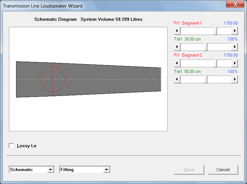

4. What is the density value of polyester fiber fill I need to input, my supplier gave me data 20Kg/m^3 for 50mm thick, 1000 GSM Polysynth Wool.
With a bit of Googling I found the attached conversion chart for polyester material (Polysynth is polyester). It indicates that a density of 20 kg/m^3 translates to an airflow resistivity of about 1700 Pa.s/m^2 (equivalent to 1700 mks rayls/m).
