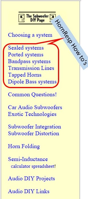

Brian Steeles The Subwoofer DIY site taught me HornResp.
This site has a Hornresp how to for each of the major systems listed in the menu on the left of this site.
Each how to has an excellent worked example. I learned a lot from this.
Don't miss the Horn Folding link there too. Wonderful tools for turning a box of your desired external dimensions into a real world horn sub. The perfect compliment to HornResp. Brilliant!

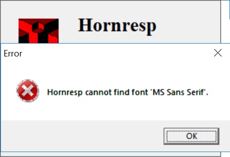

Is that from WINE? I had the same error message. Solved by copying the font file into the proper folder.
Win 10. Only on one computer. Used to work just fine.
Edit:
I have checked that the font is there and working, suspecting there might be something with a pointer somewhere.
I do not have this problem on any other computers.

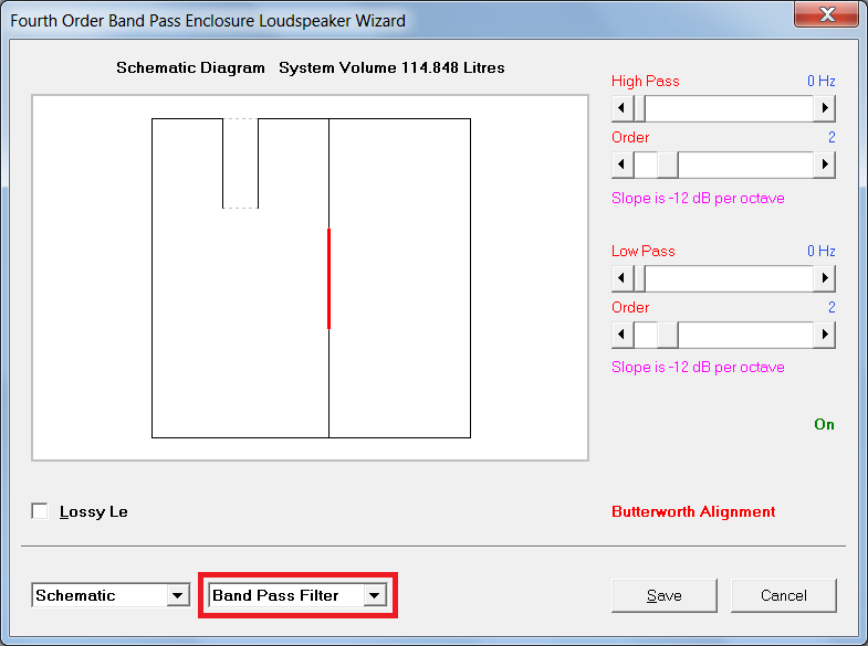

I've a request for a possible feature - if straight forwards enough to add - a passive crossover wizard to the bandpass models so those BP with sealed chambers can be modeled with series C & L.
Hi Fred,
Sorry, too much work - it's not going to happen 🙂.
(The passive filter can only be accessed from the Filter Wizard, and then only when the Filter Wizard is called from the main Tools menu).
The two band pass systems with sealed chambers in Hornresp can be modelled using Nd with stepped segments, allowing a passive filter to be applied that way.
As far as the Band Pass Wizard is concerned, you will just have to make do with the existing high pass and low pass active filters...
