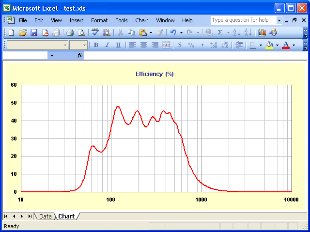

Hornresp Version 26.00
Hi Everyone,
Hornresp Version 26.00 has just been released. Changes are as follows:
1. The Tapped Horn Wizard tool (renamed Loudspeaker Wizard) can now be used with direct radiators - including bass-reflex systems, conical single-segment horns, multiple-segment horns, compound horns - with a conical horn 2, tapped horns and offset driver horns.
With the exception of conical single-segment horns, the horn segment flare type can be changed when the tool is in use by double-clicking the left-hand-side label located above the relevant length slider.
The new tool is not applicable to non-conical single-segment horns because the multiple element / isophase wavefront model used with these horn types prevents results from being updated quickly enough for the scroll bar slider controls to operate correctly.
2. Efficiency values are now exported as part of the chart data. The attached Excel screenprint shows efficiency plotted for the default record system with resonances masked.
3. The fatal run-time error reported by ‘bubblersound’ and the tapped horn multiple speakers SPL problem identified by ‘NEO Dan’ have been fixed.
As always, could you please let me know if you find any bugs. Thanks.
Kind regards,
David
