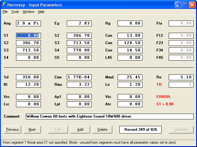

Another little bug in Hornresponse to report. I set S1 to 0 in a tapped horn design (HR 24.00) and an error message came up. After closing the error message the program hung and I could no longer change any values. Perhaps you could add a very small value to S1 to stop the error happening at all.
Hi William,
Many thanks for the feedback - you have got me really interested in this one 🙂.
I assume that S1 was set to zero in the Input Parameters window, and not the Tapped Horn Wizard? This should have resulted in a screen similar to the attached, but it seems that you might have ended up with something completely different. Would it be possible to provide some more details of the problem, as so far I have not been able to replicate it. Many thanks.
In principle, it should be possible to recover gracefully from any error caused by entering invalid data into Hornresp.

Hi William,
Not to worry - thanks for trying!
I found something late last night which may or may not be related to the problem you experienced. For my tapped horn example, when 0 is keyed into the S1 input box and the Calculate button then immediately clicked, results are calculated even though an error has been detected. This should not occur.
The Visual Basic 3 versions of Hornresp worked correctly, so this appears to be yet another case of VB3 code not directly translating across to VB6. I hope to release an update sometime tomorrow, to rectify the problem.
