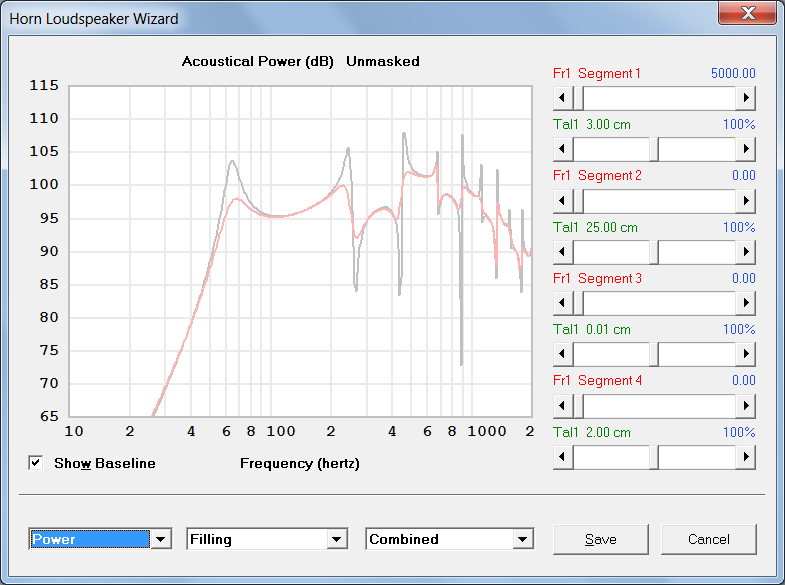

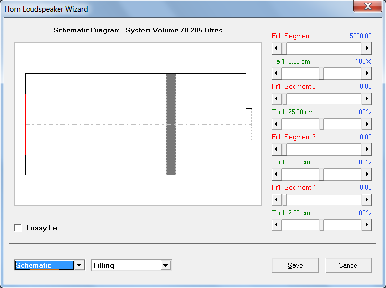

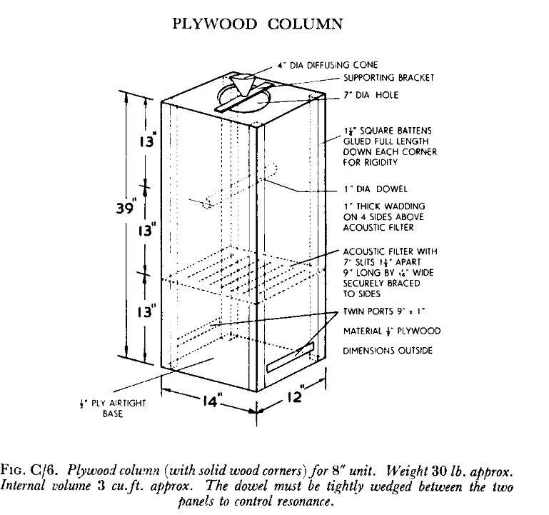

how might hornresp be set to accurately simulate G.A. Brigg's cabinets which had ~2:1 chamber ratio and 1/16" wide slits in what he termed an "acoustic filter" ? Those cabinets were in normal squat aspect besides the column example below.
There had to be a fair amount of "drag" from 1/6" wide slits in a half inch thick partition board. I had the idea the filter's function partly was to reduce excursion in the record warp region (?)
Hi freddi,
The "acoustic filter" shown in your diagram is actually an acoustical resistance. This can be readily specified in AkAbak using the AcouResistance element, but with Hornresp, the closest that you can get is to specify acoustical absorbent material instead.
The general layout would be as shown in Attachment 1 (not to scale). The effect of adding the "acoustic filter" component can be seen in Attachments 2 and 3.
Kind regards,
David

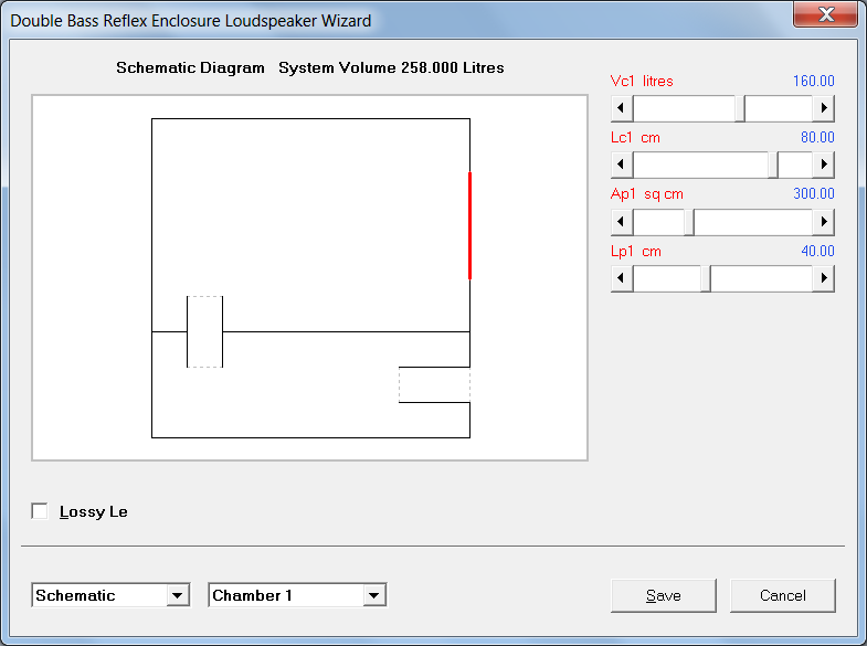

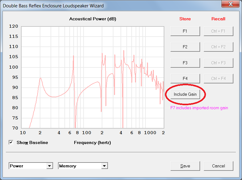

Hornresp Update 4810-180907
Hi Everyone,

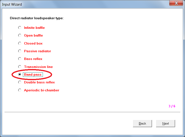

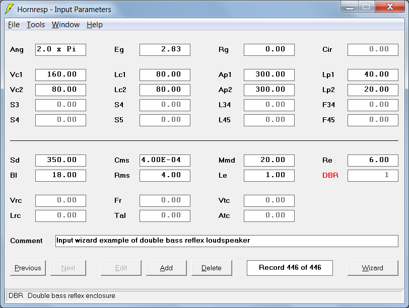

CHANGE 1
Double bass reflex (DBR) enclosures can now be directly specified. Post #8579 and Attachments 1 and 2 refer.

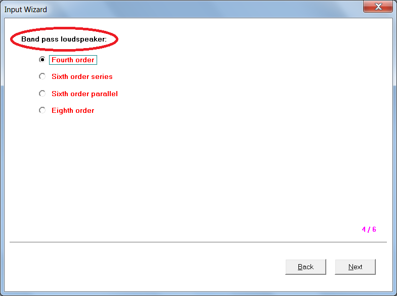

CHANGE 2
The Include Gain feature, enabling room or cabin gain to be imported and taken into account in the power response chart, has now been added to the BP4, BP6 (series), BP6 (parallel), BP8, DBR and ABC loudspeaker wizards. Attachment 3 refers.
CHANGE 3
Band pass enclosure loudspeakers now have their own options group in the Input Wizard. Attachments 4 and 5 refer.

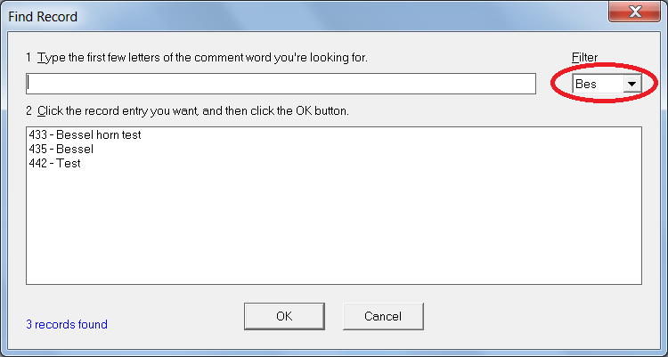

BUG FIX
The 'Bes' Bessel horn option had not been included in the Find tool filter. This has now been fixed. Attachment 6 refers.
Kind regards,
David

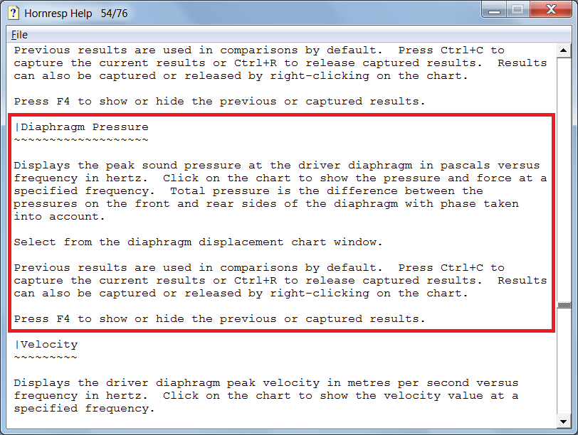

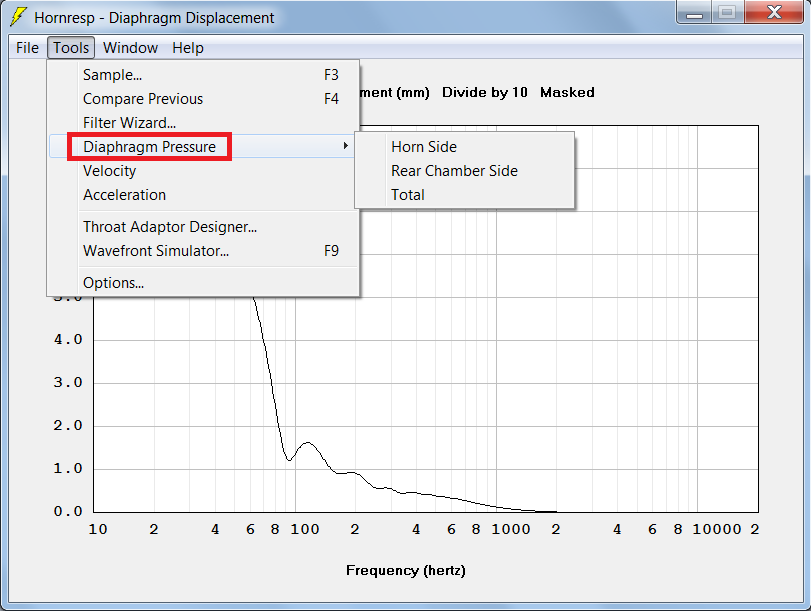

David, maybe I have already wished for this?
I would like to be able to calculate pressure on the diaphragm. Increasing the Vtc should lower the pressure on the diaphragm I believe. But I would like to know 🙂
Edit:
I have simulated this in my current design using two extra segments. Increasing the front chamber from small to very large increases the pressure.
How much pressure can a diaphragm take? I know it varies, but a rule of thumb would be great.
Thanks David!
Mårten
Hi Mårten,
Select Tools > Diaphragm Pressure from the Diaphragm Displacement chart.
I am not aware of a rule of thumb. Perhaps someone else may know...
Kind regards,
David
