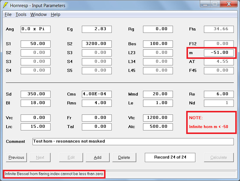

I don't believe it - I have already found a bug - thankfully a small one!
The status bar message in the attachment should read "Infinite Bessel horn flaring index cannot be less than -50", rather than "...cannot be less than zero".
It will be fixed in the next release.

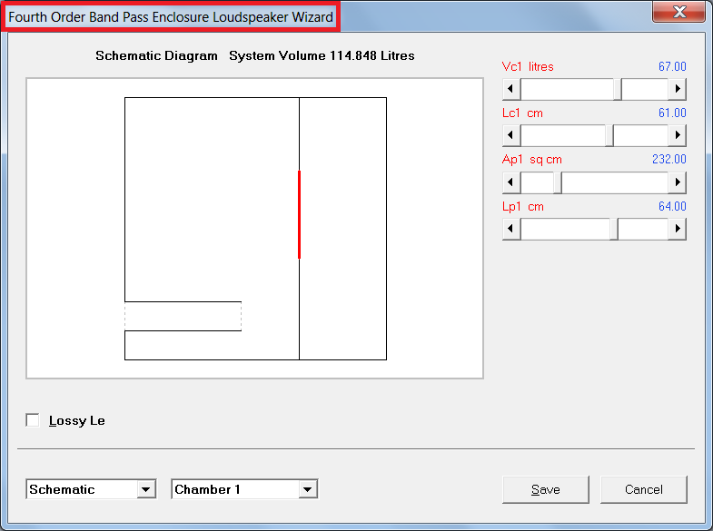

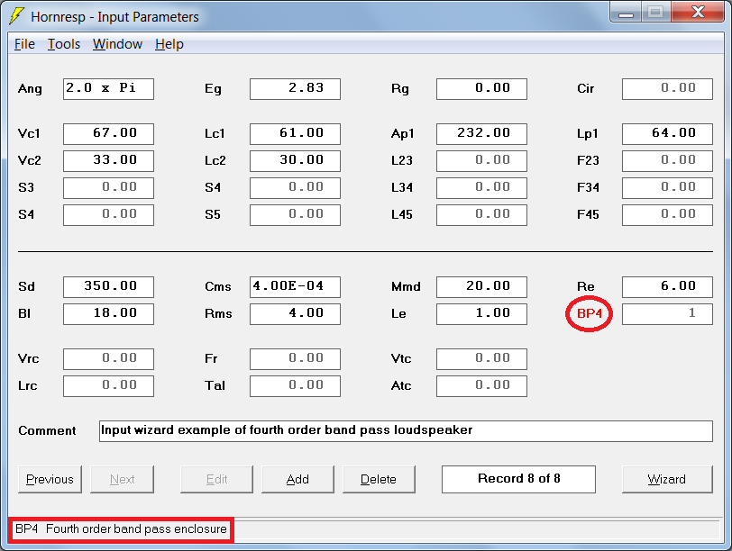

CHANGE 1
Fourth order band pass enclosures can now be directly specified using the BP4 driver arrangement option. Attachments 1 and 2 refer. See the Fourth Order Band Pass Enclosure entry in the Loudspeaker Models section of the Help file for further details.

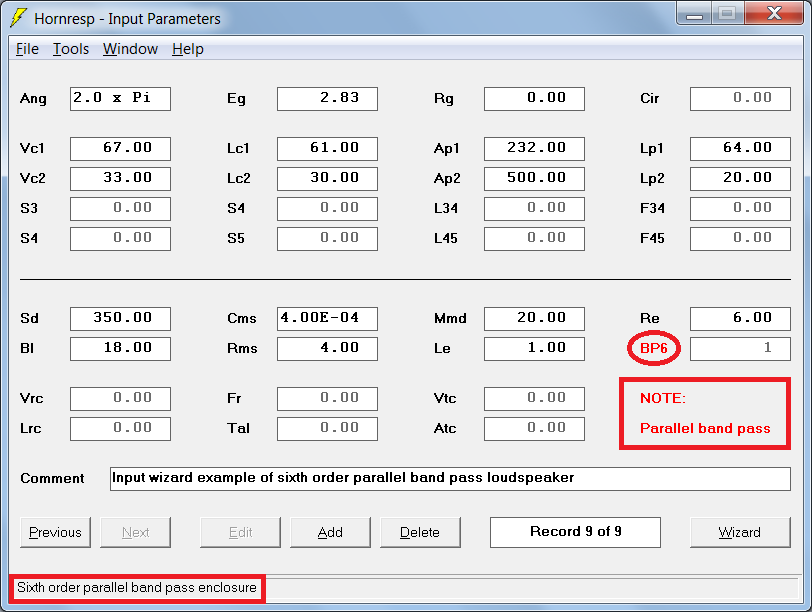

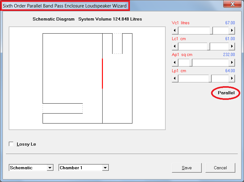

CHANGE 2
Sixth order parallel band pass enclosures can now be directly specified using the BP6 driver arrangement option together with the Parallel option. Attachments 3 and 4 refer. See the Sixth Order Series or Parallel Band Pass Enclosure entry in the Loudspeaker Models section of the Help file for further details.

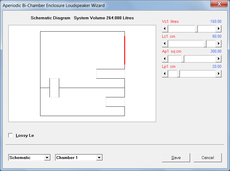

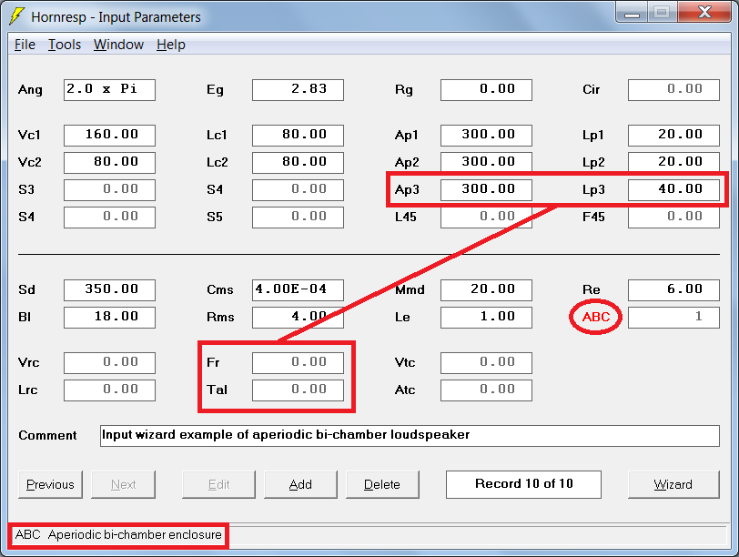

The ABC enclosure port 3 input parameter Ap3 has been moved from the Fr position to the L34 position, and Lp3 has been moved from the Tal position to the F34 position. Existing records will be updated automatically. Attachment 5 refers.

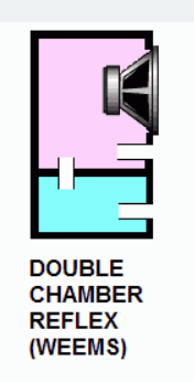

Could the Weems double chamber reflex be added?
Hi Dan,
Why not just use the existing ABC option?
