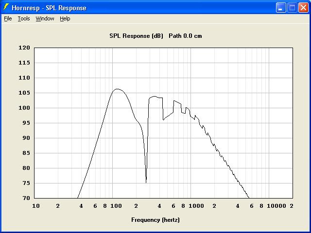

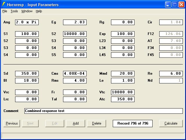

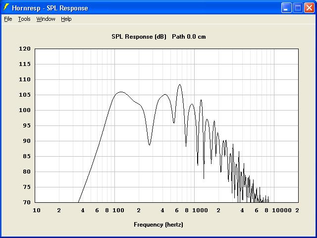

Hi Johan,
I have established through further testing that the Hornresp combined response model still requires chamber resonances to be unmasked - otherwise results can become invalid when large chamber volumes are involved.
For example - the first SPL response chart shows the combined response with chamber resonances unmasked. The second SPL response chart shows the combined response with chamber resonances masked.
I think I will leave things just as they are :).
Kind regards,
David
