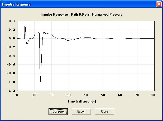

TEST 1. WITH 0 CM PATH LENGTH DIFFERENCE:
Path length from the front side of the diaphragm to the 1 metre reference measurement point:
Ltc + L12 + 100 = 600 / 300 + 41 + 100 = 143 cm
Front path time delay = 143 / 34400 x 1000 = 4.16 msec
Path length from the rear side of the diaphragm to the 1 metre reference measurement point:
Lrc + L56 + 100 = 8 + 336 + 100 = 444 cm
Rear path time delay = 444 / 34400 x 1000 = 12.91 msec
See Test1.jpg attached. The positive (front) spike is located at 4.16 msec and the negative (rear) spike is located at 12.91 msec, consistent with the calculated results above. Even though the mouth of the rear horn is the same distance from the measurement point as the mouth of the front horn, the normalised amplitude of the negative (rear) spike is greater than the normalised amplitude of the positive (front) spike because the rear horn is more efficient at lower frequencies than the front horn.

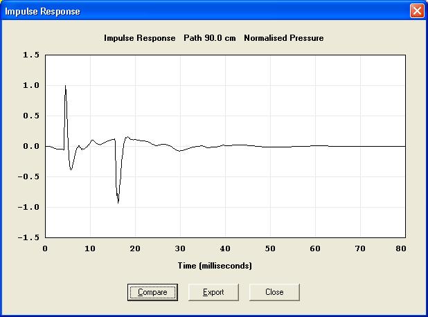

TEST 2. WITH 90 CM PATH LENGTH DIFFERENCE:
Lrc + L56 + Diff + 100 = 8 + 336 + 90 + 100 = 534 cm
Rear path time delay = 534 / 34400 x 1000 = 15.52 msec
See Test2.jpg attached. The positive (front) spike is located at 4.16 msec and the negative (rear) spike is located at 15.52 msec, consistent with the calculated results above. Even though the mouth of the rear horn is 90 cm further away from the reference measurement point than the mouth of the front horn, the normalised amplitude of the negative (rear) spike is only slightly less than the normalised amplitude of the positive (front) spike because the rear horn is more efficient at lower frequencies than the front horn.

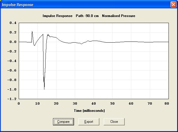

TEST 3. WITH -90 CM PATH LENGTH DIFFERENCE:
Ltc + L12 - Diff + 100 = 600 / 300 + 41 + 90 + 100 = 233 cm
Front path time delay = 233 / 34400 x 1000 = 6.77 msec
See Test3.jpg attached. The positive (front) spike is located at 6.77 msec and the negative (rear) spike is located at 12.91 msec, consistent with the calculated results above. Because the mouth of the rear horn is 90 cm closer to the measurement point than the mouth of the front horn, and because the rear horn is more efficient at lower frequencies than the front horn, the normalised amplitude of the negative (rear) spike is considerably greater than the normalised amplitude of the positive (front) spike.
Kind regards,
David

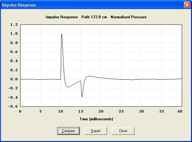

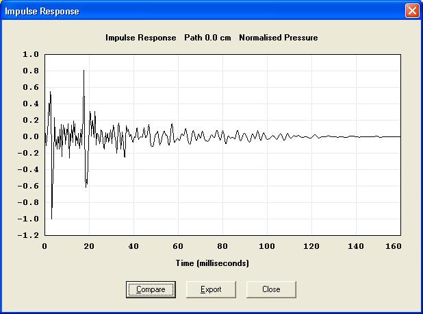

Hi Oliver,
Just letting you know that I have released a minor update to correct a problem that could sometimes occur when the Sample tool was used on a combined response with a non-zero path length difference. Product Number 2320-090928 refers.
Also, out of curiosity I conducted another impulse response validation check using a compound horn with identical front and rear 244 cm long horns, but without chambers. The total path length to the 1 metre reference measurement point for each horn is 344 cm, giving an overall path delay of 10 msec.
For a 0 cm path length difference, the pulses from the front and rear sides of the diaphragm will arrive at the reference measurement point after 10 msec, 180 degrees out of phase. Theoretically this should result in total cancellation of the two pulses.
Looking at Test1.jpg attached, you will see that there is no noticeable pulse at 10 msec, which is consistent with the theory. The "ringing" shown across the time scale is simply an artefact of the impulse response calculation process. It is actually very low level noise, only made apparent in this case because the maximum value, although extremely small, has been normalised to 1.
TEST 2. WITH 172 CM PATH LENGTH DIFFERENCE:
For a 172 cm path length difference, the pulse from the front side of the diaphragm will arrive at the reference measurement point after 10 msec, and the pulse from the rear side of the diaphragm will arrive 5 msec later, opposite in phase.
Looking at Test2.jpg attached, you will see that this is in fact the case. You will also note that the low level ringing noise artefact is no longer evident because the maximum value now normalised to 1 is the amplitude of the pulse from the front side of the diaphragm. The absolute amplitude of the rear pulse is less than 1 because the mouth of the rear horn is 172 cm further away from the reference point than the mouth of the front horn.
Kind regards,
David

Hello David,
Probably someone may imagine that the problem of using a larger time window for the pulse response is Hornresp is very trivial but it is not. The variable width windowing used for every frequency component is only optimized for the actual length of the time window.
Optimization of the windowing for a new fixed length of the time window will take some time but much more time is needed in the case of an adaptative length of the time window.
I can study this problem but surely it will take some time...
Best regards from Paris, France
Jean-Michel Le Cléac'h

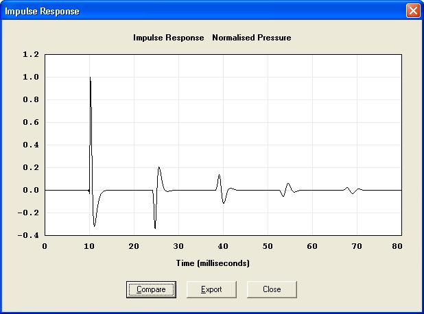

Hi Oliver,
Excellent 🙂.
Just to illustrate Jean-Michel’s point regarding reflected waves, for a thin cylindrical horn having a length of 244 cm, impulses can be seen at:
(1 x 244 + 100) / 34400 x 1000 = 10.00 msec (+ve phase)
(3 x 244 + 100) / 34400 x 1000 = 24.19 msec (-ve phase)
(5 x 244 + 100) / 34400 x 1000 = 38.37 msec (+ve phase)
(7 x 244 + 100) / 34400 x 1000 = 52.56 msec (-ve phase)
(9 x 244 + 100) / 34400 x 1000 = 66.74 msec (+ve phase)
as shown in Test1.jpg attached.
Kind regards,
David
Kind regards,
David
Note: if the cylindrical "horn" is closed, it changes the phase (with electrical measure, of course).
Open and closed 1 meter tube firsts echos:
With electrical measure, I can't really confirm this simulation.
In first approach, I say no but the reading of (real) impulse response is an art.
"10000 sample at 48kHz is (nearly) equivalent to 0,21 seconds and to 7,2 meters traveled at the speed of sound."
10000/48000 = 0.20833.....
0.20833 * 343 = 71.45833.....
That gives us little more than 70 meters for reflections and whatnot.
Unless I am missing something.
Hello David Web,
You are right. It seems I was a bit tired when I calculated the width of the IR window. The width of the IR window is nearly equivalent to 72meters (and effectively when simulating a 3 meters tube I could see at least 4 reflections).
Though the remark I have done is still right: the problem only happens when reflected waves (echoes) are important and it only introduces small changes below 100Hz on the SPL curve.
As an counter-example: if you simulate the default horn in Hornresp or Le Cléac'h horn the problem doesn't happen. (As a big fan of axial horns I am quite surprised of how many people design multisegmenst TH horns and such...)
I'll give a look if I can see a solution. May be the problem is related to the ratio between the width of the IR window and the width of the window used in the individual frequency component summation(raised cosine). At 10Hz the ratio may be too small...
As the method don't uses any inverse FFT such problem requires "fine tuning" to reduce noise (this was originally the main problem with the IR calculation). I'll see what I can do but it will not be immediate.

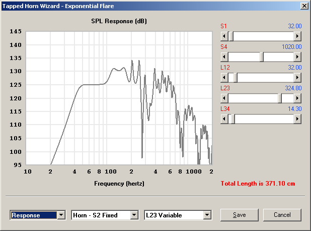

HornResp is a GREAT tool for modelling - thanks David. If you have a few spare minutes, here's some enhancements I'd like to see:
1. In the TH Wizard, include the option to independently vary S1, S2, S3 and S4, rather than the "S2 fixed" option.
2. Include the ability to model the effects of active filters on the response (Fc, Q and order should be enough input values). This will allow users to model the effect that "rumble filters" and low-pass filters will have on the overall response.
Thanks again for this great tool. No thanks from SWMBO though - I think she's starting to get annoyed about me spending too many hours every night going through different possible TH alignments.. 🙂
Thanks Jean-Michel 🙂.
Kind regards,
David
Hi Brian,
You're welcome.
Very few Hornresp enhancements take only a few minutes - several hours is more likely, and then, only if I'm very lucky 🙂.
It could certainly be done for three-segment tapped horns, but not for four-segment ones (insufficient space is available to include all the necessary slider controls). When you get to that degree of adjustment though, it is probably just as easy to work from the standard Input Parameters window, rather than the Tapped Horn Wizard. I will have a think about it for three-segment systems, but I'm not promising anything 🙂.
Sorry, it's not going to happen - Hornresp is a loudspeaker modelling tool only 🙂.
Kind regards,
David
You're welcome.
Kind regards,
David
