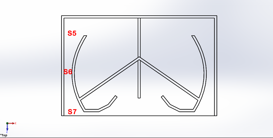

Sure, here's two examples of flared ports, the first is just traditional flares at the ends, the second is the entire port being flared as popularized by Danley recently (his only ported box offering uses this style).
I'd like to check velocity at any point between the flares in the first example (doesn't matter where) and at the pinch point in the second example.
I can't think of any reason to check pressure but it would be nice to know velocity. Flare It gives acceptable limits for chuffing and for core velocity in the port itself (regardless of whether there's a flare or not). It's the velocity at the narrowest point in the port that I would like to see, this is the core velocity. I can easily design for 10 m/s or less at the port ends using Hornresp's current functionality (with or without flares) but as it stands you can only check the core velocity if there's no flare (you can't check in the middle of the port).

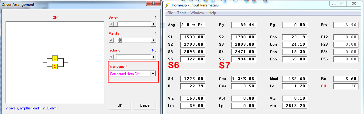

Hi just a guy,
Thanks for the prompt response. I was hoping that you would post something like the designs you show .
Just to confirm that I understand correctly, in effect what you are asking for is the ability to check the particle velocity at the interface points between the segments in a multiple segment horn. In the worst case (a port tube assembly specified using a throat adaptor and four segments) this would be at the following points:
S0 (Throat adaptor entry)
S1
S2
S3
S4
S5 (Port Outlet)
Is this correct?
