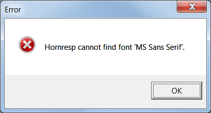

Can you add a non start up warning stating something like?
Missing fonts !
Hi Andrew,
Hornresp already has an error message for the 'Courier New' font - see attachment. I did not provide a similar message for the 'MS Sans Serif' font because I wrongly assumed that Microsoft would always include their own fonts at the very least, with their Operating Systems. I will add an error message for the 'MS Sans Serif' font in the next update, rather than changing the Readme.txt file as initially proposed.

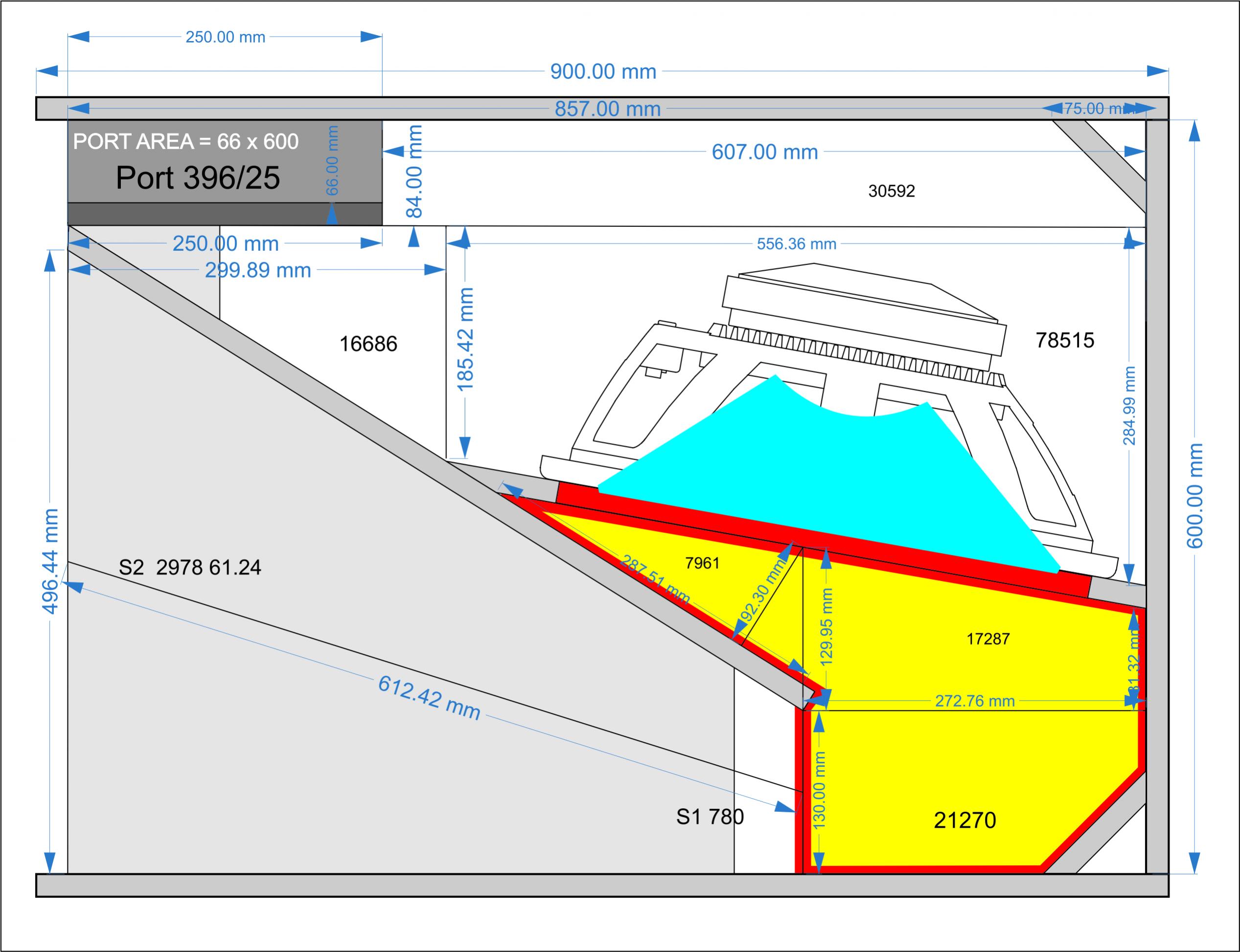

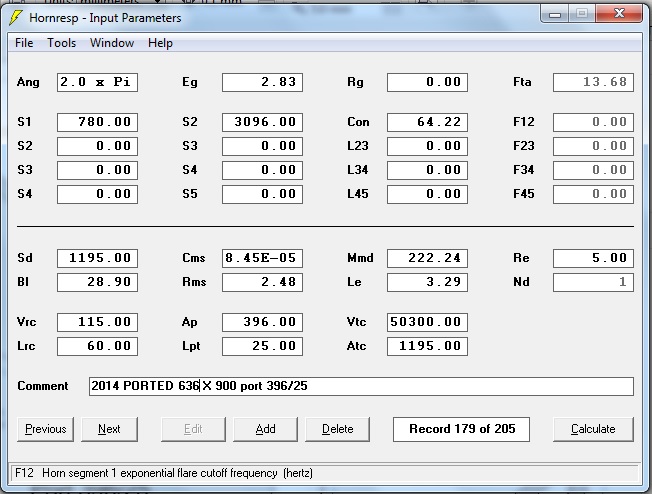

I have designed one compound horn cabinet to learn hornresp.
The cabinet design file is attached herewith along with hornresp input window.
Let me know my mistakes.

Hi jayam000,
Just to clarify - the system you show would normally be described as a horn-loaded vented-box enclosure, rather than as a compound horn.
I haven't checked the values you are using, but your basic simulation model seems okay.

Thanks David.
Yes, this is horn loaded vented box enclosure. But i want to convert it into compound horn box by replacing port to horn. before this i want to confirm if all my inputs are ok.

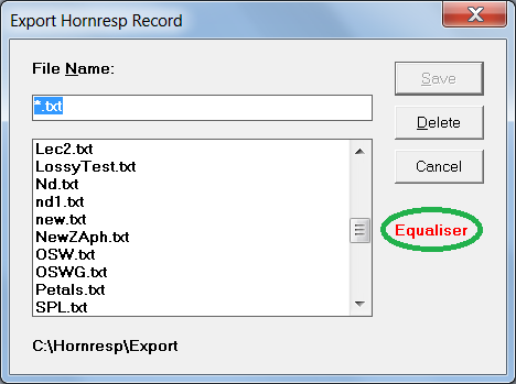

When exporting a Hornresp record it is now necessary to specify which group of filter settings to include in the export file. Active and parametric equaliser filter settings are exported by default. To export active, passive and Le Cléac'h filter settings instead, double-click on the red Equaliser label to select the Passive option before saving the export file (see Attachment 1).

An error message is now generated if Hornresp cannot find the font 'MS Sans Serif' (see Attachment 2). Previously the message was only generated if the font 'Courier New' could not be found.
