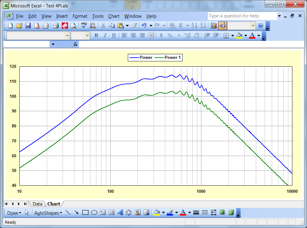

Attachment 1 compares the power response referenced to 1 pW * (blue trace) to the Hornresp-calculated power response (green trace). The source is radiating into free space or 4 Pi steradians solid angle. The two curve traces are identical in shape, offset in this case by 10.83724 dB.

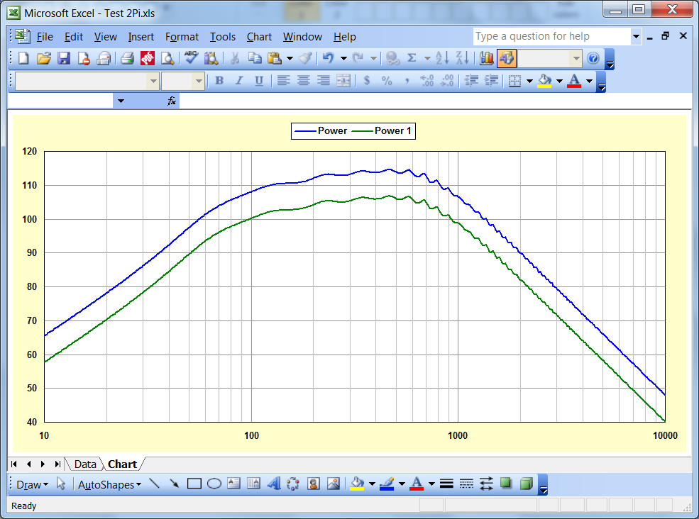

Attachment 2 compares the power response referenced to 1 pW * (blue trace) to the Hornresp-calculated power response (green trace). The source is radiating into half space or 2 Pi steradians solid angle. The two curve traces are identical in shape, offset in this case by 7.82694 dB.
The difference in offsets is 10.83724 - 7.82694 = 3.01030 dB = 10 * Log10(2) dB as expected from the theory.
As previously explained, the Hornresp-calculated power response is not referenced to 1 pW, so the absolute levels will always be different to those calculated using 1 pW. As demonstrated above however, the actual shape of the curves will always be identical.
I don't agree with the assertion that the only valid power response curve is one referenced to 1 pW.
* NOTE - A modified version of Hornresp was used to calculate the power response referenced to 1 pW. It is not possible to use the production version of Hornresp to obtain these results because as already explained, the reference value is different.

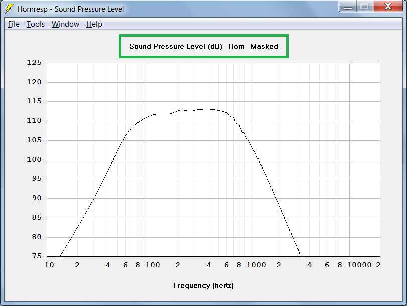

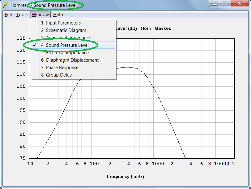

Rather than generating an Acoustical Power chart when the acoustical power source is nondirectional and an Acoustical Pressure chart when the acoustical power source is directional, perhaps the following alternative approach might be more acceptable.
1. The "Acoustical Power (dB)" and "Acoustical Pressure (dB)" chart titles to both be renamed "Sound Pressure Level (dB)".
2. The default Sound Pressure Level chart to be calculated assuming a nondirectional source, with the acoustical power output producing the sound pressure radiating uniformly into the solid angle specified by the Ang input parameter.

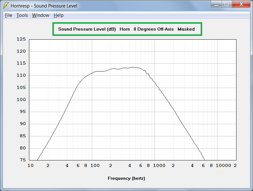

3. The Directivity tool to be used to calculate the Sound Pressure Level chart taking directivity characteristics (i.e. beam width) into account.
Both charts would have the same "Sound Pressure Level (dB)" title, but one would also include off-axis angle information (when the Directivity tool is used) whereas the other (the default chart) would not. Hopefully this difference in captions would minimise the chances of any confusion as to what a particular chart represents. The Hornresp Help file would of course also be modified to document the difference.
Attachment 1 shows the default chart.
Attachment 2 shows the chart when the Directivity tool is used.
Attachment 3 shows the Window menu command.

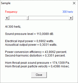

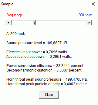

Uli, this is getting silly. Have you not read what David explains in post #6385, that the reference power changes with radiation angle? The Power Response (dB) chart is not the power level re 1pW. Therefore you cannot say that halving the radiation angle doubles the radiated power just because the curve rises with 3dB. Do yourself a favour and check the facts: if you want to check the actual power, use the sample tool.
To help you grasp this, I have done it for you. Attachment 1 shows the sample window for 1pi radiation angle, attachment 2 shows the sample window for 0.5pi radiation angle. As you can see, the radiated power is very nearly the same.
Further, as David has repeatedly explained (and as the help file also clearly explains), directivity is not taken into account in the default SPL calculation. The horn radiates with a constant beamwidth at all frequencies given by the radiation angle. (And this makes it possible to get the SPL response for multiple segment horns, which cannot use the directivity model, as David has also explained.) The frequency dependent beamwidth is not taken into account unless you use the directivity tool.

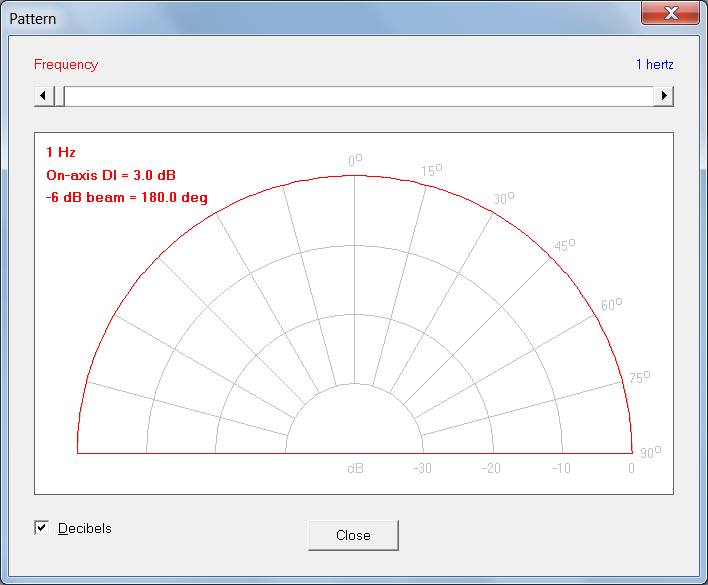

David, having SPL as default rocking response seems reasonable. But it should not be its average over radiation angle limit but SPL on axis, as one would hear it standing in front of it in free field.
To calculate on-axis SPL it is necessary to know the directivity characteristics. The default response is calculated when directivity characteristics are unknown. If directivity characteristics are known, the Directivity tool can be used and the on-axis SPL calculated. For 2 Pi space, the default chart in effect plots the SPL for the radiation pattern shown in the attachment below, with the condition that the pattern does not change with frequency. The SPL is the same at any angle.
The default nondirectional or so-called "power" response is useful in practice because the results provide a reasonably accurate indication of performance at lower frequencies, where directivity is not an issue.
It is important to recognise the difference between a "power" response, which can be normalised so that the results are equivalent to nondirectional SPL, as is done in Hornresp, and a "pressure" response, which shows SPL with directivity taken into account.

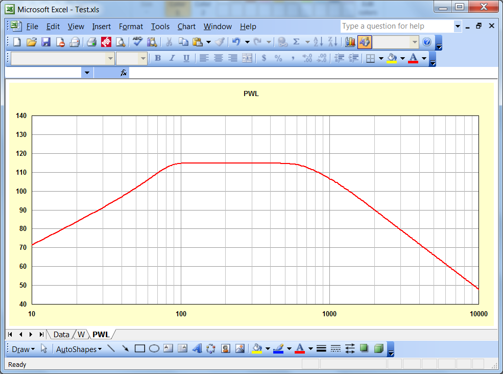

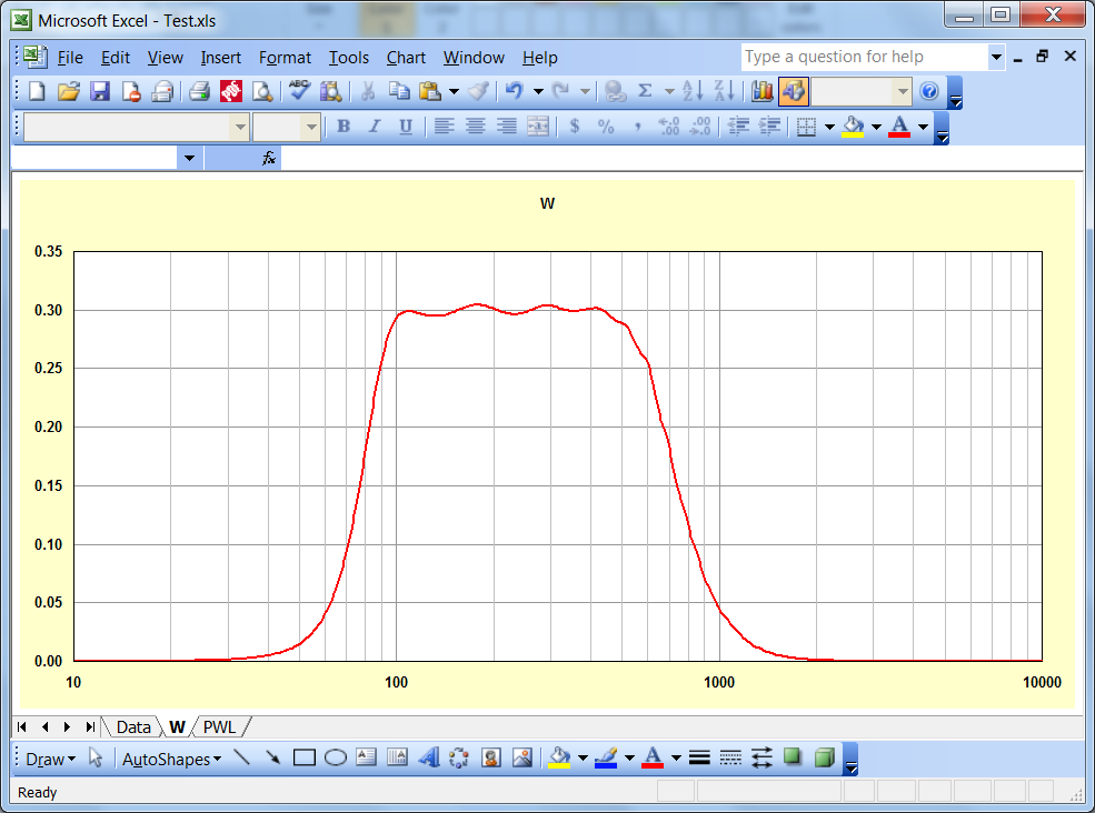

I am not exactly sure what you mean by true power function, but a plot of output watts versus frequency, or of the ratio in decibels of output watts to 1 picowatt versus frequency, would be of little practical value to Hornresp users.
If however output power versus frequency does indeed need to be plotted for some reason, then the existing chart data can be exported to a spreadsheet and the output power W calculated at each frequency using the following formula:
W = Ang * (4 * 10 ^ -10) / (1.205 * 344) * 10 ^ (SPL / 10) watts
Where Ang is the solid angle value specified in the simulation (e.g. 2 * Pi for half space radiation), and SPL is the value given in the SPL (dB) column of the spreadsheet.
If necessary, the Acoustical Power Level PWL referenced to 1 picowatt can be calculated using the following formula:
PWL = 10 * Log10(W / (10 ^ -12) ) dB
Where W is the output power calculated using the first equation.
Attachment 1 shows a plot of output watts vs frequency for the default Hornresp record with resonances masked.
Attachment 2 shows a plot of acoustical power level referenced to 1 picowatt vs frequency for the default Hornresp record with resonances masked.
