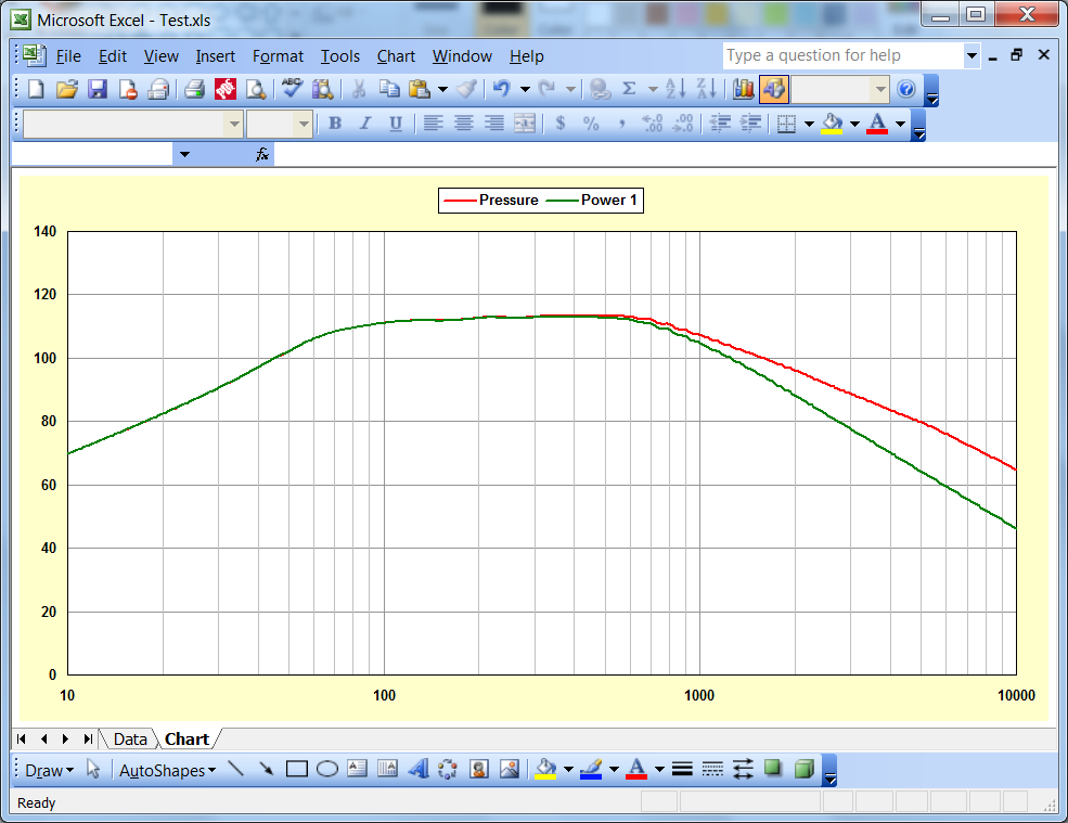

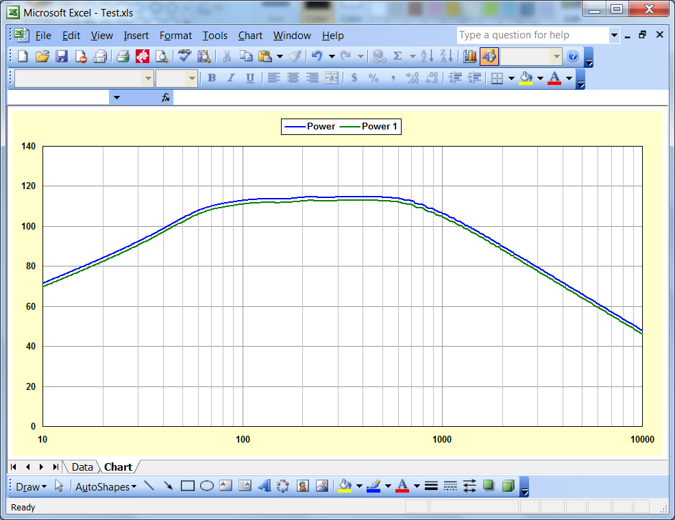

For a test single-segment horn loudspeaker:
Attachment 1 compares the pressure response (red trace) to the Hornresp-calculated power response (green trace). The Hornresp-calculated power response is obviously different to the pressure response, so to call the Hornresp-calculated power response a pressure response would simply not be correct.
Attachment 2 compares the power response referenced to 1 pW (blue trace) to the Hornresp-calculated power response (green trace). The two traces are identical in shape, so both accurately show the power response curve. (The difference between 50Hz and 100Hz is 8.7341 dB in each case, for example).
Hornresp uses a reference value different to 1 pW so that the power response curve exactly matches the pressure response curve at lower frequencies, where radiation is non-directional, as shown in Attachment 1. This enables the Hornresp-predicted response for multiple-segment low-frequency horn loudspeakers, where a pressure response curve is not available, to be directly compared against measured results.
They do not. If one halves radiation angle limit in Hornresp, say from full-sphere to half-sphere, then the "power" curve rises by 6dB. But power has only risen by 3dB (due to impedance doubling).
Simulate anything, at first with full sphere radiation, at second with half sphere one, and compare: At low frequencies "power" and pressure rise with 6dB, but power does with only 3dB. At high frequencies, at which the loudspeaker beams on its own, "power" rises by 3dB, while power does not at all.
