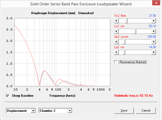

One thing I noticed - the upper displacement minimum seems to shift significantly if the "mask resonances" option is selected. Is this expected? See attached image for example. Grey curve shows displacement when "mask resonances" is selected.
Hi Brian,
The BP6, BP8 and ABC simulation models are a bit different to the other Hornresp models in that the chamber and port elements are assumed to be connected in parallel rather than in series. The parallel model was adopted after taking into account comments posted by xrk971 (and in the belief that on balance, the parallel model should hopefully provide more accurate "unmasked" results overall, for a given system configuration).
http://www.diyaudio.com/forums/subw...ndent-front-chamber-tuning-5.html#post4314907
When the "Resonances Masked" option is selected however, the chambers are treated as simple acoustic compliances, and as you have found, when connected in parallel with the port elements, produce somewhat different results. This "inconsistency" is one reservation I have about using the parallel model 🙂.
No matter what model is adopted though, the BP6, BP8 and ABC models will always be approximations only - the actual performance of a system will depend on the precise geometries and locations of the chambers and ports, which are not accurately taken into account in the models. Nevertheless, at bass frequencies the predictions should give a reasonable indication of the performance to be expected.
I would be very interested to receive any feedback on predicted versus measured results for such systems.
