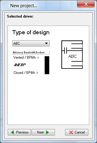

Any way we could get aperiodic bichamber bass reflex simulation in?
Hi Do It Yourself,
Won't WinISD simulate an ABC system?
If not, then it is probably another one for AkAbak 🙂.
Kind regards,
David
