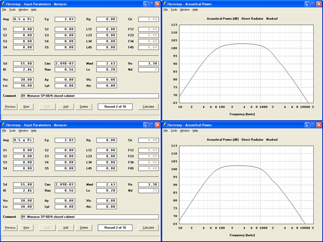

@ bjorno,
I would expect a difference of at least 3 dB.
Why don't I see this difference?
@ bjorno,
If supplied from a constant Eg:2 Drivers in series consumes half the power so the + 6dB SPL gain from doubling the Sd is lost as both drivers gets only a 1/4 of the power each i.e. -3dB will be added to the SPL compared to when using one driver.

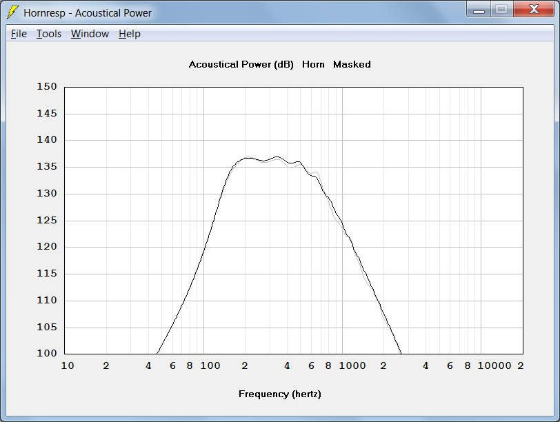

Hiya folks
Sorry if im posting in the wrong forum thread, mods please delete/move if so.
My question is in relation to a mid horn design im working with on hornresp, I understand hornresp is not very accurate at this, im using it more to fine tune the low extention of the horn, not the upper response.
Anyway my problem is when im checking max spl relating to xmax limit, i need to far exceed the power the VC can handle. i.e. i need to turn up EG 4 x the power limit of the driver.
the driver in question is Eminence Kappa Pro 10A - 500W.
The horn design is 70cm long, 100cm2 throat, 3700cm2 mouth.
simulation max spl - 135dB at 3.2 mm xmax, RMS voltage (EG in hornresp) at this spl is 126.5 Volt or 2000 Watt!!!
is this normal for hornresp when designing mid horns or am i going very wrong. any help would be greatly appreciated.

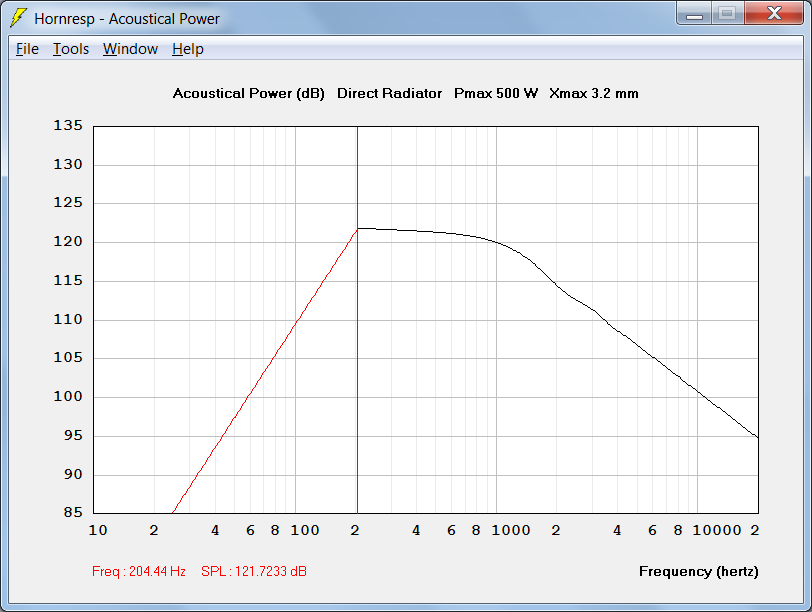

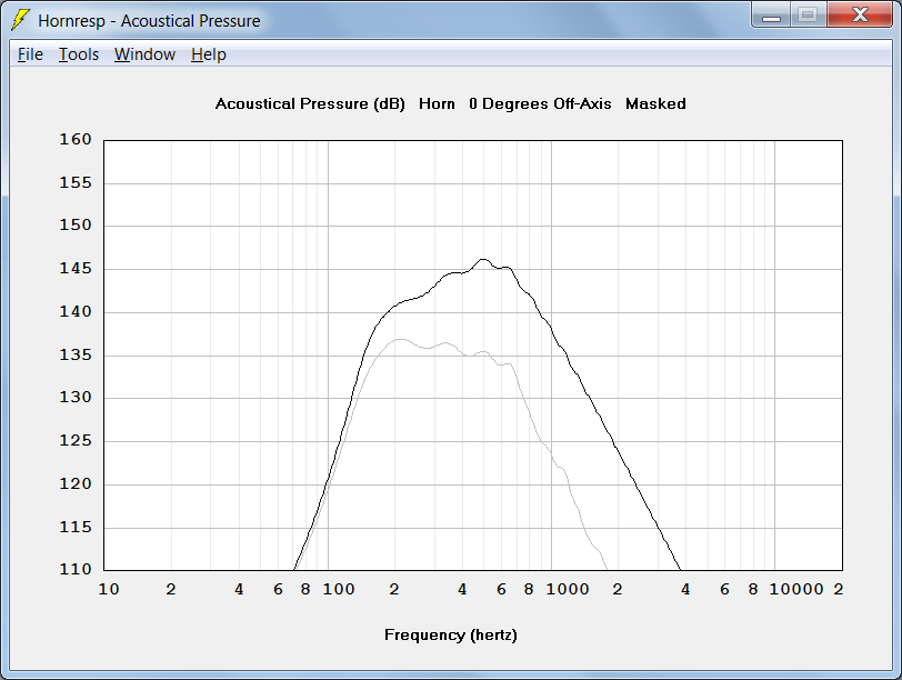

Hi SillySounds,
but i always been told hornresp becomes less accurate the higher the frequency, hence the roll off higher up the response graph.
It is important to differentiate between the acoustical power response, which is calculated by default, and the acoustical pressure response, which requires the use of the Directivity tool and is limited to single segment horns.
To illustrate the difference, Attachment 1 compares the power response for your design (grey trace), against the on-axis pressure response (black trace) for an effectively equivalent single segment exponential horn, where S1 = 100, S2 = 3690 and L12 (Exp) = 73.6.
Attachment 2 compares the power response for your design (grey trace) against the power response for the equivalent single segment exponential horn used to calculate the above directivity response (black trace). As you can see, the results are effectively the same.

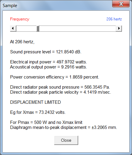

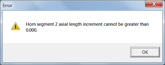

Alas i still have the same problem that to reach aforesaid xmax limit i must apply excessive voltage/power to driver, namely 4 x the recommended limit for the driver (126.5v or 2000w!).
Pmax = 500 W and Xmax = 3.2 mm assume that the driver is being used as a direct radiator, as shown in Attachments 3 and 4. Horn loading the driver with a Sd / S1 compression ratio of 3.45:1 as you have done, will significantly reduce the diaphragm displacement for a given input power.

Thank you very much Mr Mcbean, it seems I have very much to learn in respect to using hornresp.
Im afraid that I'm struggling to understand the real difference between acoustical power and acoustical pressure. Would you have any reading/an explanation that could help me understand the basics of what is happening on the simulation, and how acoustical power and acoustical pressure responses corralate to form a good impression of what the real life horn may play?
And what your saying is that the fact 500w and 3.2 mm xmax is assuming a direct radiating transducer, and hornloading the driver would reduce the xmax figure for a given spl. Thanks for explaining that, gives me a better impression of where im going wrong!

The acoustical power is the total energy the horn radiates. If you measured at many points around the horn with a microphone, you could then calculate the acoustical power. However most horns have at least some directivity - the sound power is not evenly distributed over all angles. So the directivity tools in Hornresp allow you to try to predict how the horn will direct the sound - typically at very low frequencies, the horn will radiate evenly everywhere (omnidirectional) and as frequency increases, the horn will have an increasingly narrow beam of sound. Exactly what frequencies these are depend on the size of the horn. In terms of understanding how this relates to what you hear, if you were outside far from any reflections or in an anechoic chamber with your horn, you would only care about the pressure response where you wanted to listen (typically on axis). If you are in a room, what you hear will be a combination of the power response and the direct response (on axis or some other axis that is pointed towards you). With a very directive horn in a very dead room, you will hear more of the direct sound and less of the power response, and vice versa. If you are building a low frequency device, the modal response of the room and where you position the speaker will have a very strong effect on what you hear.

John has provided an excellent explanation in his post above. Try Googling 'difference between acoustic power and pressure' or similar, if further details are required.
Just to clarify - horn loading the driver does not reduce the Xmax figure (the driver displacement limit specified by the manufacturer). What it does do, is to reduce the driver diaphragm displacement for a given SPL, which is what I think you meant to say.
Note that even though horn loading may allow more power to be delivered to the driver without exceeding Xmax, it is likely that Pmax will be exceeded, which probably means that the voice coil is heated to such a temperature that a failure could occur.

John Sheerin - I see. So to get a good idea of what the horn may play, I would have to take both the power response and pressure response into account, but also bearing in mind that different environmental factors will also affect the low frequency responce. Thanks for that explaination, I have now looked into my simulations and cross-referenced between them to get a better idea of what they might play.
Although i wanted to ask, since in the power response is the total energy radiated from the horn (and at low frequency bass is omni-directional), this does not give a good idea of the actual low frequency response (assuming outdoor use, i.e. no room modes/nodes, constructively/destructively augmenting the response). In reality the directional pressure response in hornresp gives a more accurate idea of what you might hear the horn play, in the low register, as stood in a single spot you wouldn't hear the total low frequency energy, only the energy radiated in your immidiate area (sorry, this isn't a good explaination. I hope it's coming across as understandable) . Am I correct in assuming this?

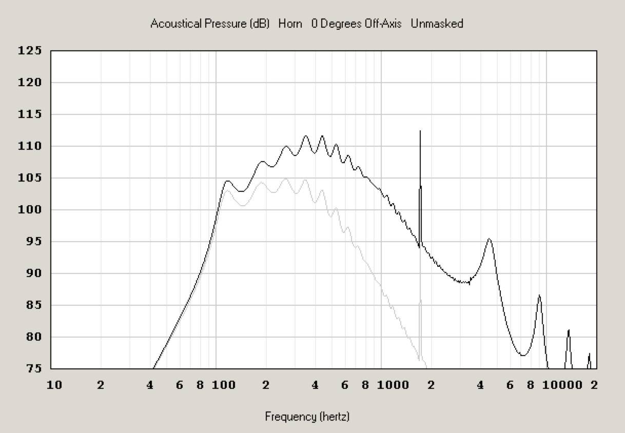

Maybe - it depends on the horn and what 'low frequency' is. If you use the horn outdoors in a frequency range where it has no directivity, then the power response should be the same as the pressure response on-axis. If the horn has directivity in the frequency range you're using it in, then you are correct - the pressure response would be a better prediction.
For example, say I make an 80Hz horn and simulate it in 4pi space (free field). Below about 100Hz, it's omni and the power response and 0 degree pressure response are the same. But those two curves deviate from each other more and more the higher in frequency you go.
