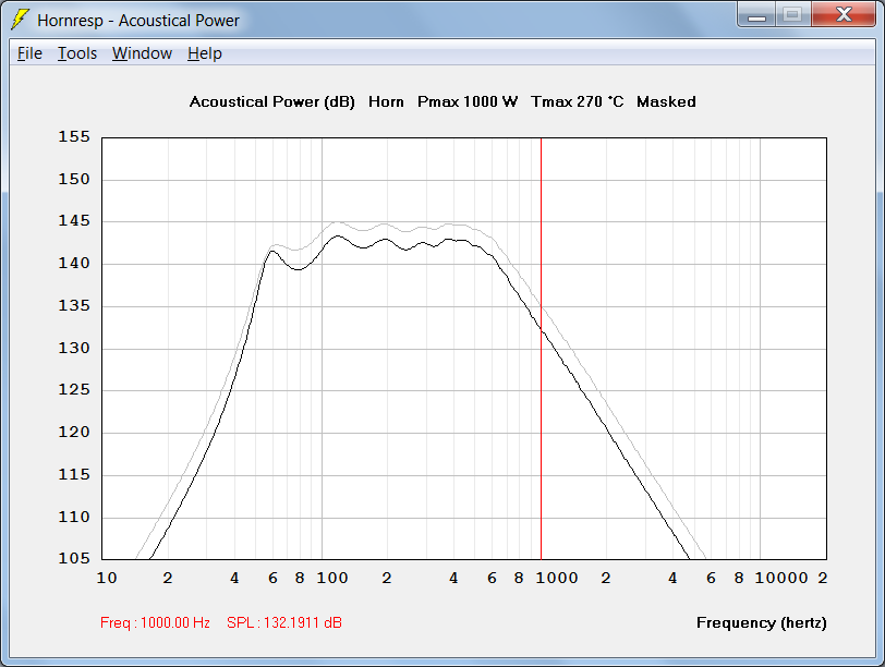

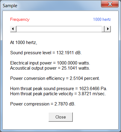

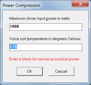

Hornresp Update 3630-141108
Hi Everyone,
CHANGE
The Power Compression tool has now been added, and can be accessed from the Acoustical Power window. See the Hornresp Help file and previous posts starting from #5027 for further details. Thanks to all those who contributed to the development of this feature.
Kind regards,
David

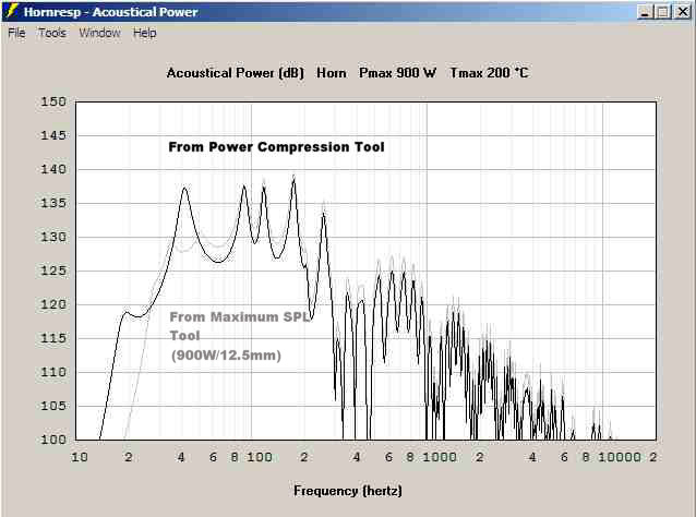

I've looked at a number of simulations, and it looks like your new Power compression tool uses constant electrical input power. Would it not be better to use constant electrical input voltage?
Hi Oliver,
I decided to use Pmax rather than Eg because I assumed that the driver voice coil would be most likely to reach its highest operating temperature under conditions of maximum input power. In some ways, it is similar to the thinking behind the Maximum SPL tool.
Otherwise, a user could specify an input voltage Eg of 2.83 volts, but with a temperature of 200 deg C, which would not be a realistic combination. Far more than 2.83 volts would be required to heat the voice coil to 200 deg C.
It would certainly have been easier for me to use Eg as the input, because it is already specified on the main input screen 🙂.
What do others think - Pmax and Tmax as the inputs, or just Tmax, with the value of Eg coming from the main screen?
It has to be one option or the other - it can't be both 🙂.
Kind regards,
David

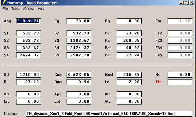

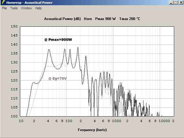

Hi David,
I would prefer to see a power compression curve derived from the same Eg as the original SPL curve. The user will have to guess at the temperature anyway to arrive at a realistic result.
This would also allow the simulation to be compared to a measurement as most drive amplifiers will work w/ a constant voltage output, not a constant power output.
I would see this as a more meaningful simulation, particularly for enclosures that have very large impedance changes.
I'll attach a TH example.
