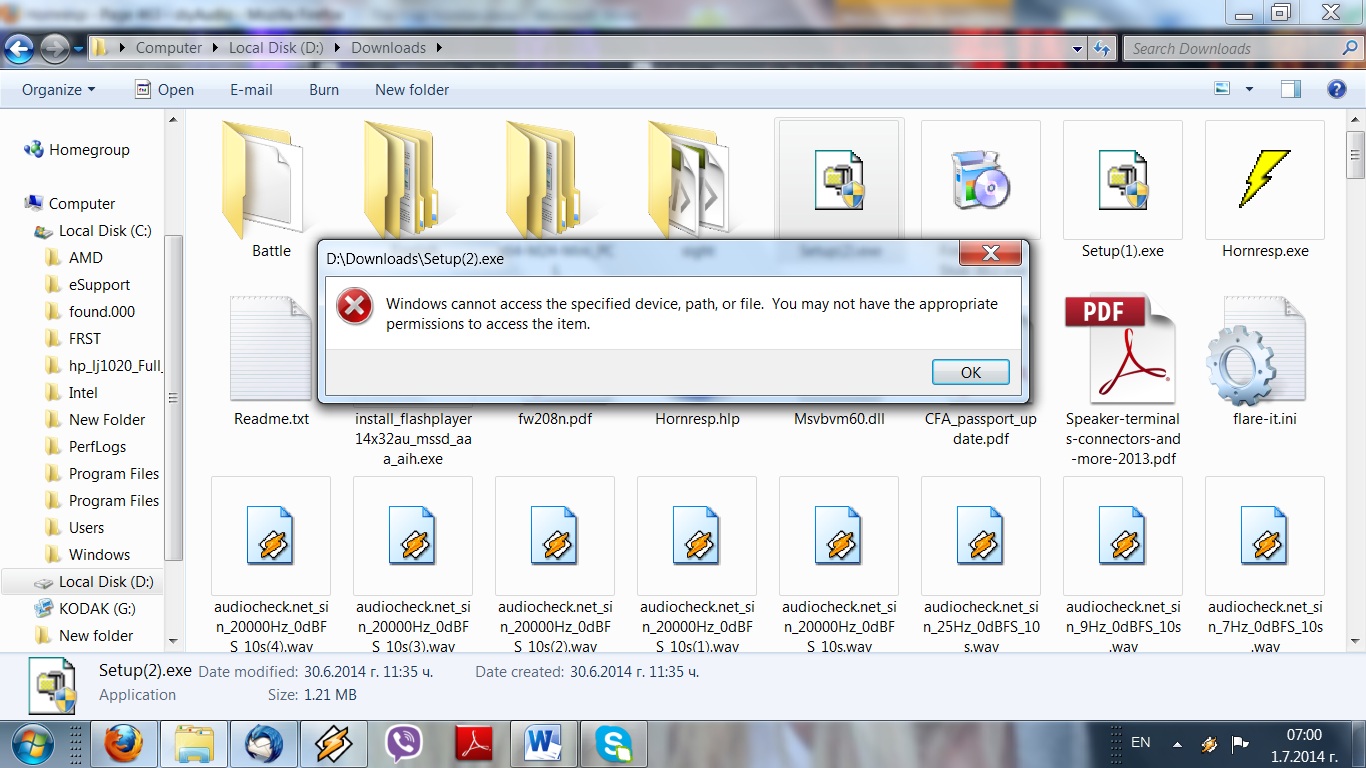

Hi Mario,
I recommend you download the Setup.exe to your C drive, as your user may not have the propper permisions on the D drive.
Beyond that your security software could possibly be blocking access. I see a security shield logo added to your downloaded Setup.exe files, to me this suggests the security level may be set to restrict access to the file by default, exe and zip files are commonly classified as potential threats.
Is your windows user profile an admin?
What security software package are you using?
Does the Hornresp.exe file shown in your screen shot run?

I recommend you download the Setup.exe to your C drive, as your user may not have the propper permisions on the D drive. - Did this, no luck.
Beyond that your security software could possibly be blocking access. I see a security shield logo added to your downloaded Setup.exe files, to me this suggests the security level may be set to restrict access to the file by default, exe and zip files are commonly classified as potential threats. - This appears to indicate that the file is blocked as it comes from another computer. I do unblock it, set all permissions and it would still not run.
Is your windows user profile an admin? - Yes.
What security software package are you using? - Avast, even added the .exe to the exclusions list, no result.
Does the Hornresp.exe file shown in your screen shot run? - No, produces the error message above ( the screen in my previous post ).

Hi Mario,
As you are an admin level user on the PC my opinion is that your security software is likely what's preventing you from installing and using Hornresp.
I'd recommend you contact the Avast support group or seek help on their forum...

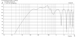

Hello, can this kind of "dipole horn" be simulated with hornresp? If not, then what about if the woofers would be enclosed in ~40l boxes?
I can't simulate such construction myself. If someone wants to try to simulate it, it would be much appreciated!
Woofer could be for example Eminence Deltalite II 2515. I was thinking of using such horn in the 100...130Hz - 500Hz band.

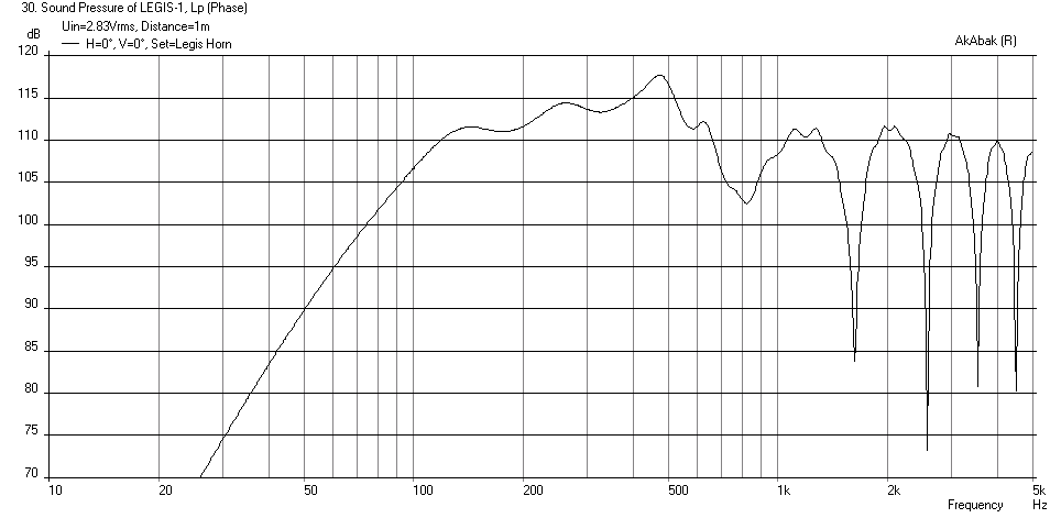

You want it dipole in the sense of an open back on the drivers? This is easy to do in Akabak - let me see what I can gin up...
Thanks for the responses! Yes, I might keep them open backed like that. Another interesting option is to use a breathing "resistance port" enclosure around the woofers.

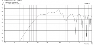

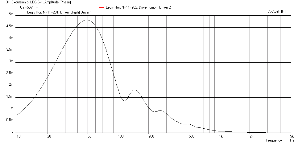

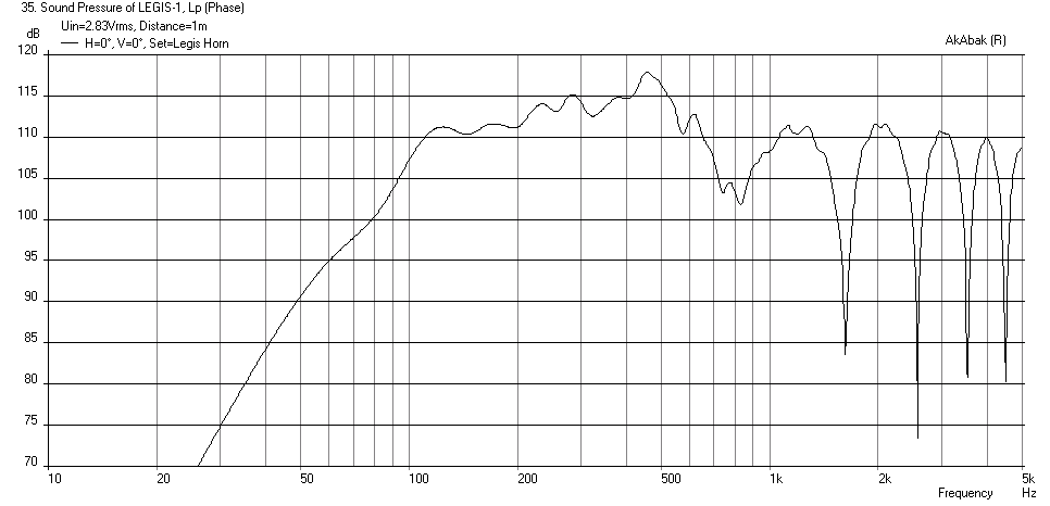

Sim of dual Deltalite15 in Legis Horn
Legis,
Here is the sim of your horn in Akabak - your guess of the 130 Hz to 500 Hz usable bandwidth is pretty close. I have applied a 75 Hz BW -24dB/oct high pass filter to control cone motion and increase max power. This sucker can get very loud. The sims below assume 2 pi space with speaker sitting on floor or driver 0.25 m above floor. Drivers are mounted at 200 mm distance from vertex to driver centerline (as measured parallel along horn side wall).

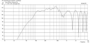

Here is SPL vs Freq for 2.83v at 1m (drivers connected on parallel):

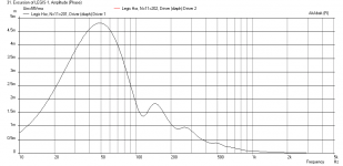

Here is cone excursion at xmax with 55 volts of drive:

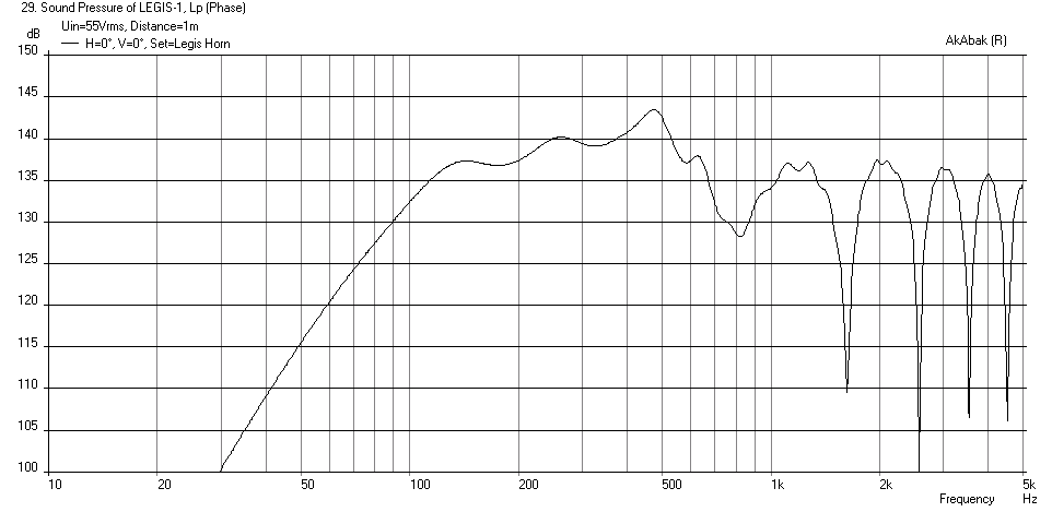

Here is corresponding SPL at 55 volts (130+ dB!):

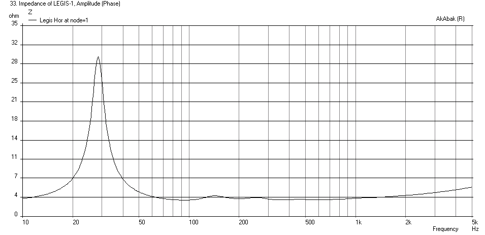

Here is impedance:
This is the effect of reflections from back radiators if you place horn with mouth 2 meters away from a back wall:
Of course you will want a low pass filter of your choice, maybe -24 dB/oct BW at say 550 Hz?:

Legis,
Here is impedance:
That's interesting, Hornresp does not predict as much gain on the top end for a OD FLH. Can you post the script? Akabak does not calculate using parabolic expansion, could that be the difference?

Very interresting, thank you for the sims. What would cause the upper end to get attenuated as much as the hornresp predicts with open backed woofers (that would go >3kHz without the horn)? That's quite a low pass!
I will post script when I have access to my computer. Yes it is a truncated horn, not unlike a Danley Synergy but without the compression chamber and restricted throat to cut the bandwidth. Add a 2.25 in CD capable of 500 Hz and you just might have a nice 2 way Synergy.
