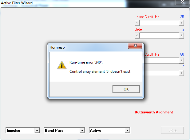

Just to share everyone, i have put those files online. I just needed to use a little trick to support those type of file, changing their extension in xls :
hornresp.xls : just rename it as .dat
stupiddesign.xls : just rename it as .txt
Hi Damien,
Many thanks for posting these files, they have enabled me to quickly find and fix the bug.
At some time you must have calculated the results normally, and then used the Filter Wizard tool and saved the record with the 'Filter Delay' output option selected (option 7 in the list).
Later, when you attempted to open the Filter Wizard tool from the Loudspeaker Wizard tool, the Filter Wizard tried to set output option 7 when only 5 options were now available, thereby generating the error.
In the latest release, when the Filter Wizard is selected from the Loudspeaker Wizard, if the output option setting is greater than 5 it is automatically set to 5 to prevent the error from occurring.
Thanks again for bring this problem to my attention.
Kind regards,
David

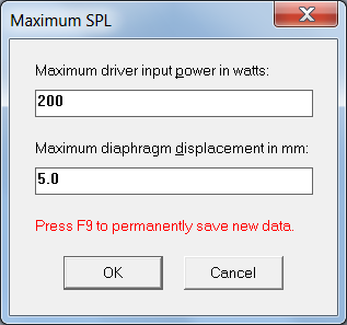

Hornresp Update 3480-140622
Hi Everyone,
CHANGE 1
The Filter Wizard is now selected from the Loudspeaker Wizard by pressing the F8 function key rather than the F key.
CHANGE 2
Path length difference, Pmax, Xmax and Filter Wizard input values are now saved to the permanent data record by pressing the F9 function key.
CHANGE 3
In the case of the Filter Wizard, current filter settings can be reset back to the permanently saved settings by pressing the Ctrl+F9 function keys.
To summarise:
1. Press F8 to select the Filter Wizard from the Loudspeaker Wizard.
2. Press F9 to save path length difference, Pmax, Xmax and Filter Wizard input values.
Kind regards,
David

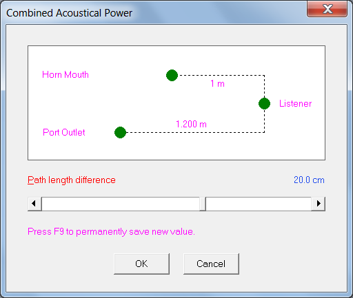

I like the distance diagram. Simple yet useful.
And I'm happy that it is the way I imagined your application of this function from the beginning.
Hi Mark,
As they say, "a picture is worth a thousand words" 🙂.
Kind regards,
David

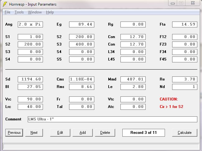

I am building a simple sealed sub and have been considering the effects of firing it into a wall (or base/top plate). I have seen hints that it it possible to model this effect using hornresp but I'm not entirely clear on how to go about it. If this is possible, can anyone provide some guidance on how to do this?
The idea came from this post on another forum which is modelling the effect of a slot. Intuitively this looks like the same effect as firing into a wall but I have never used hornresp before & so am not remotely sure if this is accurate.
My attempt at doing this is based on a 18" driver in a 90L cabinet (which has a 20" face) firing into a wall that is 1,2,3,4" away. Using the method in the linked thread, I therefore calculated
S1 = 1 S2 = 200 Con = 12.7
S1 = 200 S2 = 400 Con = 12.7
i.e.
S2 = the mouth of the slot = the circumference of a circle multiplied by the width of the slot
I used the 20" (~50cm) box width as the diameter of the circle and the distance from the wall as the width of the slot. Therefore a 1" (~2.5cm) distance results in a 2*Pi*(50/2)*2.5 ~= 400
Each Con value is 12.7 (aka 5") as that is half the radius (and the slot is modelled in 2 equal length sections in that linked thread).
Any guidance/help much appreciated!

Hi, I'm not sure I understand precisely what you are simulating here, perhaps it would help if you attached a screen shot of your hornresp entry screen, but at a first look I would say S1=1cm² doesn't seem right, at least if you have the simulation set to "Nd"
In a different thread the discussion arose how to simulate a port up against a wall, and here's a link to my response how to do it:
http://www.diyaudio.com/forums/mult...-firing-ports-subs-more-less.html#post3571739
(if the direct link doesn't work, it's post number 14 in that thread).
The Method to simulate this for in front of the driver on a sealed box should be fairly similar, just use the surface area of the driver in cm² as Atc, and the volume of the air inside the cone of the driver + the volume of the area of the driver * the distance to the wall as Vtc.
Then set circumference of driver * distance to the wall as S1, and circumference of the box * distance to the wall as S2. L12 should be Par and the distance from the edge of the driver to the edge of the box.
What I say of course assumes a driver in the middle of a circular enclosure wall - for squares or other shapes things will be different. However my gut instinct is that putting the driver up against the wall won't change much for a subwoofer, as long as you leave a moderate amount of distance (circumference of driver*distance to wall > Sd of driver)

I ran into this while changing the graph type via scroll wheel on the mouse.
Hi Dan,
Many thanks for reporting this problem. The bug was inadvertently introduced in Update 3480-140620 (Post #4606). It has now been fixed.
Hopefully one day Hornresp will work perfectly 🙂.

Hello all,
I tried to run it under Win 7 64 bit and so far no luck. I have seen that others have managed to get it going. Permissions enabled ( under security and third party origin ), all allowances marked, excluded from antivirus, still no luck. Run it in admin mode, my user has all permissions on the notebook. Created a shortcut to see what path it has, its all correct, compatibility tested down to XP Pack 2, but I still get:
Windows cannot access the specified file, path or device. You may not have the appropriate permissions to access the item.
Would appreciate any help.
