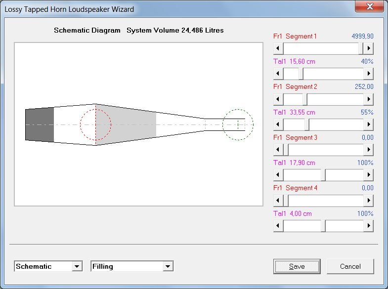

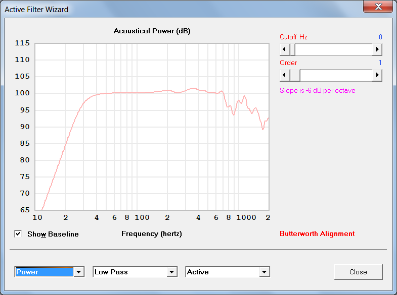

As it seems your looking at correcting error, i just got one !
It has been some time that i didn't played with hornresp (relatively...), around 3 month. Updated the version, and i now get a error with a stupid TH design when trying to go to filter design from loudspeaker wizard, whereas the tool still work with other designs... I wanted to play with high pass filter vs excursion & power ...
Here is the design :
Damien

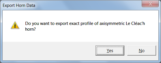

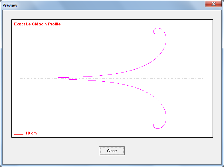

CHANGE 1
A preview axisymmetric schematic diagram is now displayed before the exact Le Cléac’h profile horn data is exported.

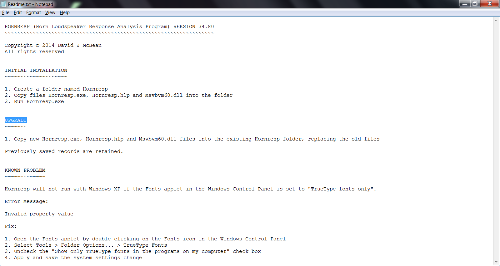

CHANGE 2
Instructions have been added to the Readme.txt file detailing the Hornresp upgrade procedure. This change was prompted by users reporting that they could no longer access their existing saved data after updating to a later release. This occurred because they had installed the new version of Hornresp in a different folder to the old version.
Hi Damien,
Many thanks for the feedback.
Unfortunately for some strange reason I cannot generate the error message you are seeing. For me, the Filter Wizard opens just fine from the Loudspeaker Wizard when I use your input data.
I would be interested to know if anyone else has the same problem as Damien when they use the design data as given in his second Post #4566 (click on embedded image to enlarge).

Hi David !
It seems to be related to the record itself ! When i add a record, from this record, the bug is still there.
But i have tryed to do something else : if i make a new record from another design, and change everything to do "stupid design", the bug is not there anymore ! ^^
Damien

From what i understand, it's in the family of tapped horn. Dimensions are just tuned, as any other kind of design can be tuned. But in fact, Bjorno would probably call this a ST-TQWT (S for strangled ^^)...Because of the high compression ratio, it probably won't work as well as it sims. Not only response is flat, but it's only 24 liters with a cheap w8-670q. The idea is to have two of this below sofa to get not so bad headroom for a little room.

Hi Damien,
This is very interesting.
Could you please select the menu commands File > Export > Hornresp Record from the Input Parameters window, save the faulty TH record to a *.txt file, and then include the file as an attachment to a Post (the location of the exported record file is shown at the bottom of the 'Export Hornresp Record' form).
To attach the file to your Post, first click on the 'Manage Attachments' button in the 'Additional Options' section below the message input window, then find the exported record file using the top 'Browse' button and finally, attach it to your Post using the 'Upload' button. Close the window by clicking on the 'Close this window' button at the bottom of the form.
I can then have a look at your record to see if I can work out what is causing the problem.
For your information, I have attached a copy of the export file for my record, which seems to work okay.
Thanks and kind regards,
David
